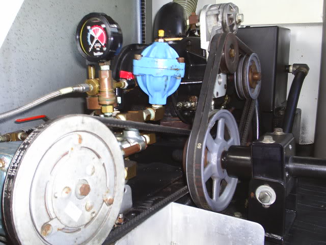

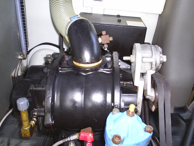

One bad ars machine. I see ceramic coated headers (BB or SB?) and a Cat pump (good combination). All that is missing is a big blower and a PowerClean Logo. shiteatinggrin

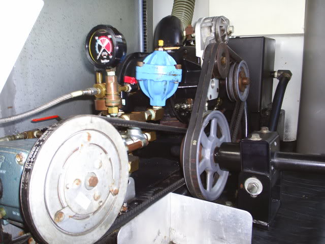

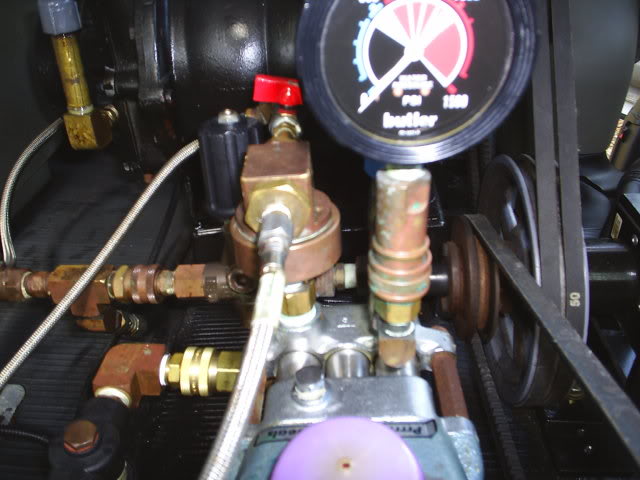

WTF does it have a pulsation damper.....
i don get what you guys SEE in a Butler...even the press reg is BRASS....
.Do you havta PULL that schroud ever time to work on it,,,,
.Do you havta PULL that schroud ever time to work on it,,,,[/quote]
Same reason other machine's have an accumulator..."protect the pump"
I like the QD set-up..on the PR..pop-it off & take inside in freezing weather...
Not always..But it sure is perty...

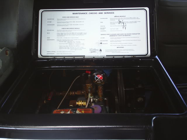

See what your equipment will look like after 5500hours....
If you will clean your FiLtHy WASTE TANK.... :p

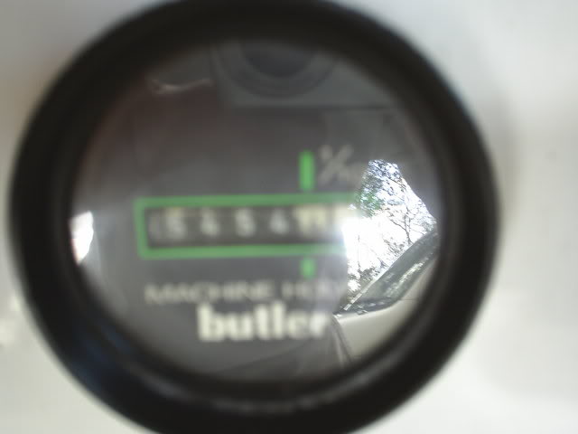

I just posted another pic..ABOVE...check out the HOUR METER.... :shock:
"PREVENATIVE MAINTANCE"........ :wink:

Don't ask Harper technical questions, Bawb. Especially about a Butler. LOL :) :D Ivebeensold shiteatinggrin :oops: :twisted:
He has no idea why.
The Butler has a pulsation dampener because it uses a "parasitic" style chemical pump system. The Chemical pump uses, or "scavenges" the pulsations from one of the pump cylinders to pulse the chem pump diaphragm for its operation. In doing so, it robs a great deal of the pump displacement from that one cylinder, inducing a moderate pulsation in the main pump output. Instead of the pump being a fully fledged three cylinder pump, its closer to a two and 1/2 cylinder, because of lesser output/less flow overlap during the pressure stroke of the parasitic cylinder.
The pulsation dampener quells the pulsations to protect downstream components from the hammering, as well to even the peak pressure spikes to facilitate better chemical flow as the chemical is reintroduced past the differential check valve.
Steam Genie units do not use this type of chemical induction, therefore the pump output is as smooth as a three cylinder, or triplex diaphragm is designed to be.

bob vawter said:
HOWEVER....why would a pump need a damper....
it SHOULDN'T pulsate..
i don get it!
Remember the Butler freshy tank is gravity fed..NO assist pump..
it will reduce cavitaition..in the pump..LOTS of QD's on this unit..
can fail & spike the pump..
Also protects the pump from P regulator failures..air leaks in the system...
It is a lot cheaper to replace a diaphram in PD..that CUPS in the CAT pump..
If you don't LIKE IT remove it... :roll:
SO.... It is a CHEAP insurance policy...for your Cat Pump...
No doubt about that. One of my bright ideas was to drill and tap one of the heads on a Hypro pump to add a last step-type chem pump. When you only have two cylinders to start, and effectively kill one's ouptut with the pump, it doesn't leave much GPM.... The chem pump worked fine tho :oops:

Hi Bawb:
You bought my 2 machines. He was supposed to sell to me "but somethng happened with his hand, and he could not type". Anyway, if you don't want to mess with the homemade Butler, drop me a line/price.
BTW, A butler Cat pump vs. a Hydrocell is why there's pulsation. 3 pistons do not make constant pressure, only on the push stroke. The Hydrocell was the best pump ever made, only cost too much.

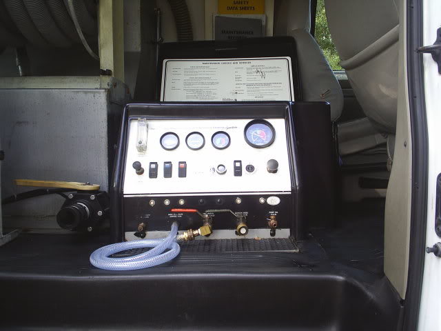

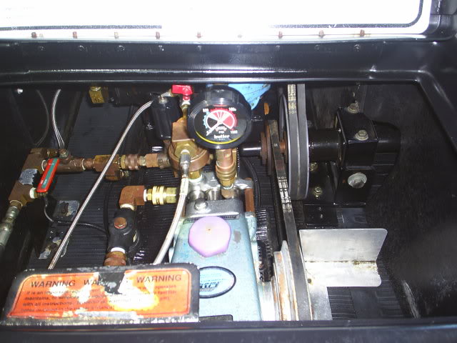

Theres a brand new Butler HX that came wit it
i want to test it...but there are FOUR 3/8 fitting and two larger 3/4 fittings..
WTF why four...how does THAT work?
it came wit a brand new Cat pump...and i don know squat about them either.............
