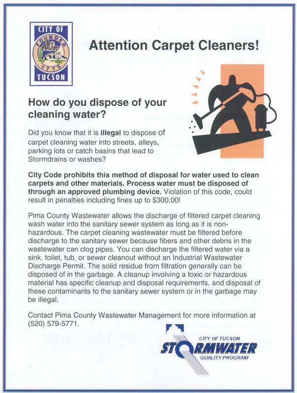

Jim Martin
Arizona
Jim Martin
Tucson....

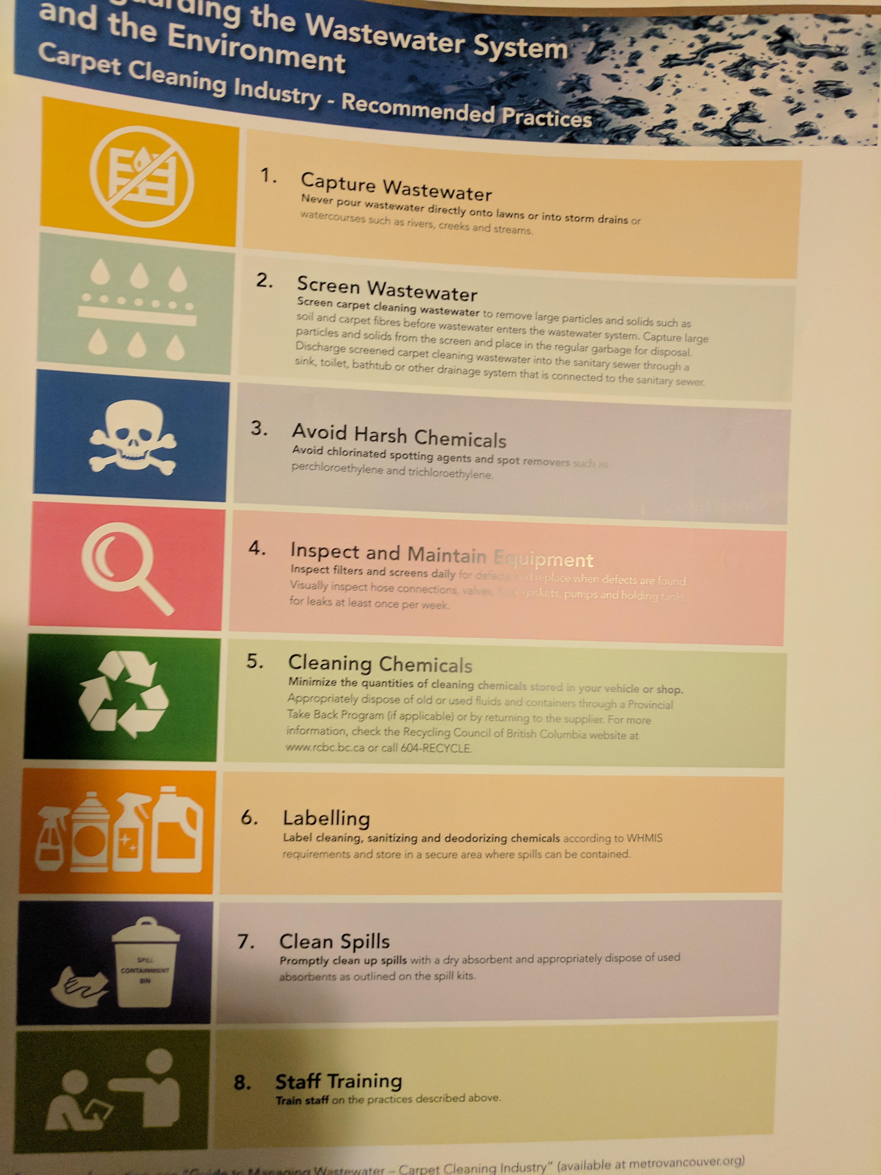

I participated in a Metro Vancouver waste water review recently. Just got a package in the mail with the regulations they developed. Here is a poster they made with my help.

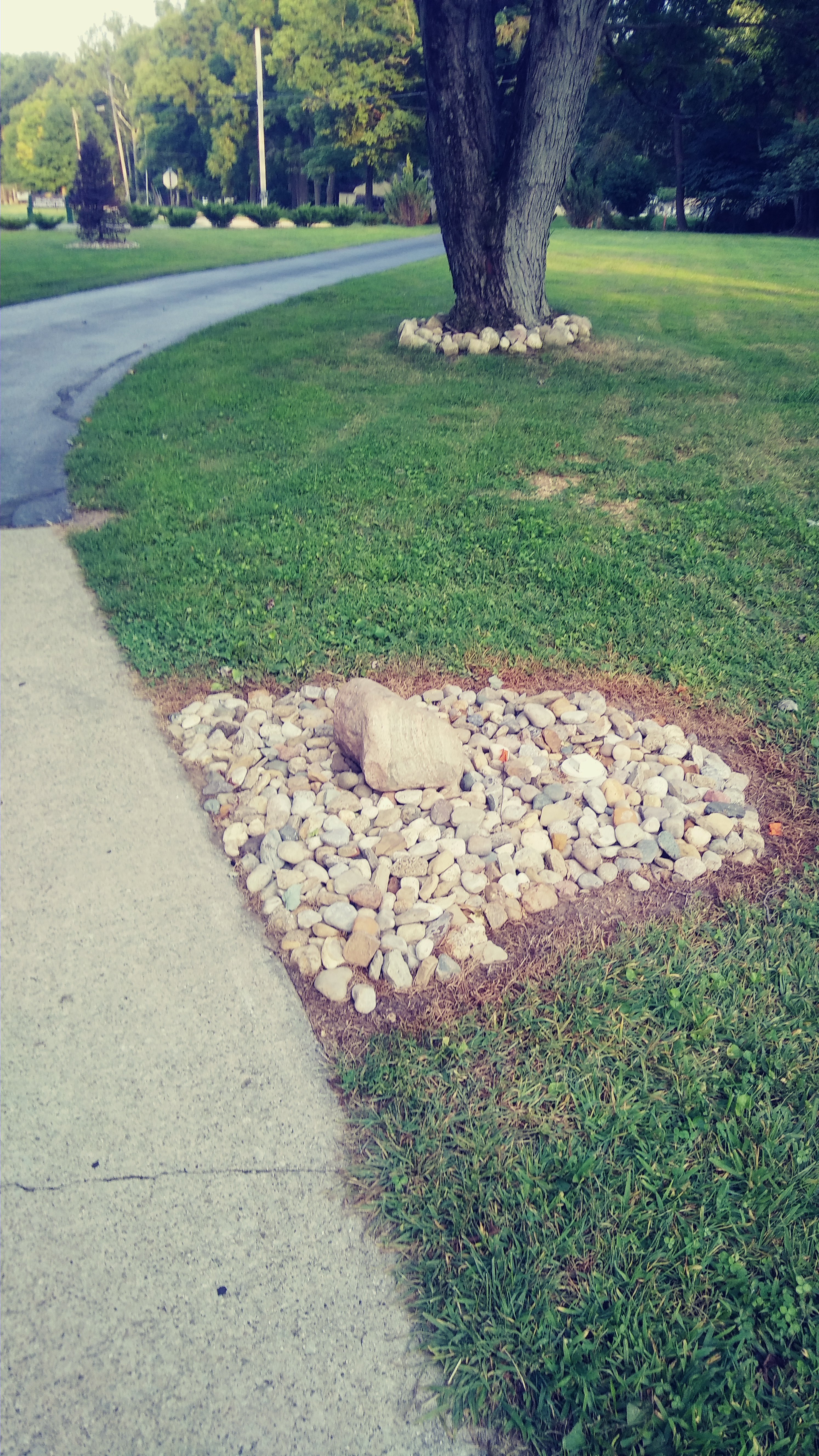

Hey fred got the same error in this thread taking a pic of my clean out.
when you show me what the "same error" is I might be able to help...or at least tell me what it actually says
all I know now is it doesn't have anything to do with old threads like you said in the other thread................and that photos are being uploaded by others
nm...I see the other thread
