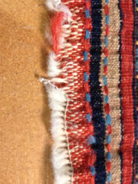

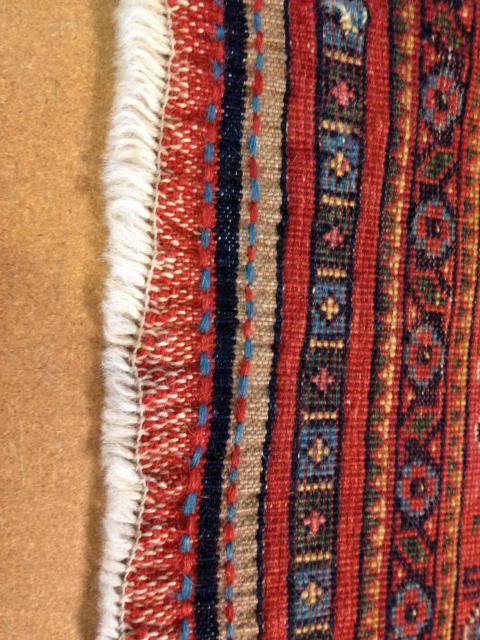

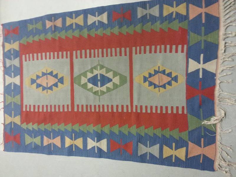

We did a common repair this evening on a flat weave. As you can see, the ends were unsightly and the body of the rug was in danger of continuous self destruct if help did not arrive:
We took out weft yarns until we had a straight row of rug left and finished by securing warp ends:
For those that offer this in your area, what do you charge retail?

I wouldn't charge a dime for that crappy repair.
What is the problem Mr. Koller? The rug ends were a mess. We took out weft yarns until we had a straight line and then secured it. (The client wanted it like that) The client loves the finish product.
Now, please show us your simple repairs sir.

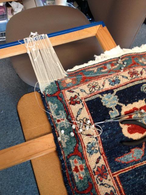

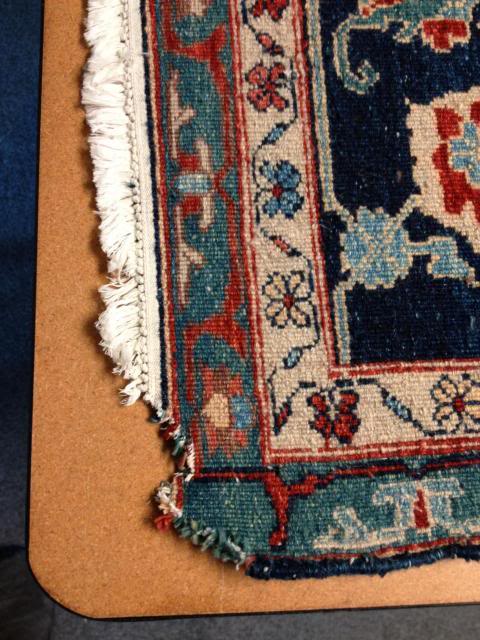

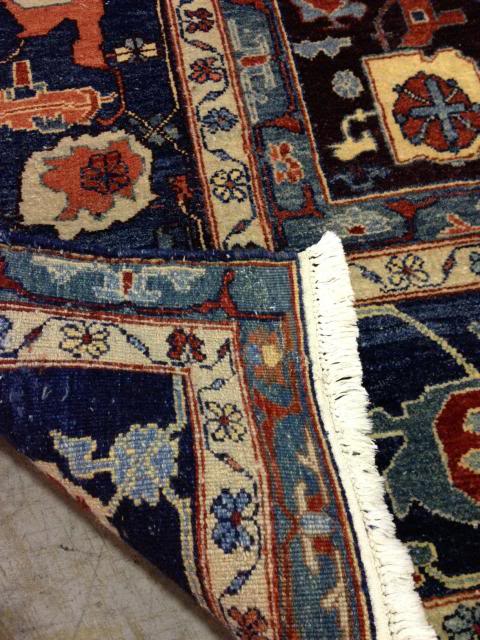

We do lots O repair we just highered another repair person

I've had both companies you speak of do repairs for me, have you? No comparison. I've also sent rugs to
Robert Mann he does a great job, high quality.

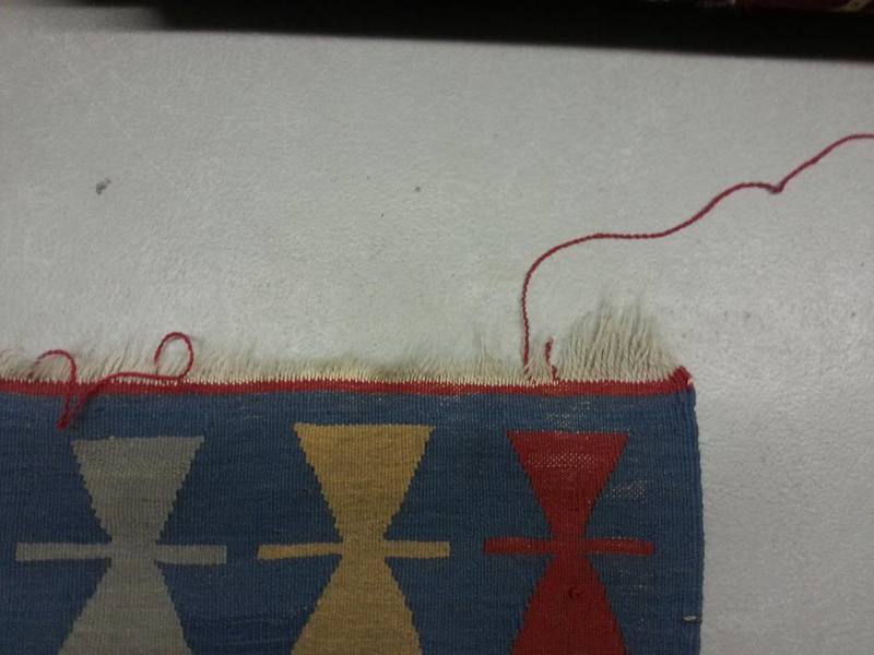

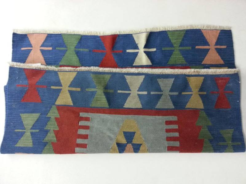

Tom there are artisans and there are cut and pasters if you take a minute and actually look at the rug you see the red matched the red hour glass designs in the corners also the beige weft threads and beige hour glass designs.You could have saved the beige weft threads and a couple of red wefts at less work and kept the original design.
In Randy's work he did not just cut off the minor border he took the time to do it right.

I get your point Ron but i think it looks good the way it is actually better without long fringe.The other end in the photo it's hard to tell the condition of the weft threads ...it's best to take it down to where there's integrity/tension in the weave. This is not a valuable Turkish Kilim so repair solutions need to be efficient and somewhat economical.
This is a challenging issue for repair people the value of a rug being equal to or less than the cost of a proper repair. Many old rugs aren't what they used to be have lost much of their value in market we had a 6x9 1930's sarouk good condition but needed the ends sewn cost 360.00 on top of 200.00 for cleaning they paid 90.00 for the rug we felt lucky to get the cleaning in the rug.

I agree with the long fringe but I think you could have just shortened and secured. I've seen many a shortening repair expose stained warp thread that are then bleached making a bad situation worse. Sorry the implication of quality with this just drives me into "rug fag mode" I've had a bad week dealing with shitty repairs from others.
What Randy said. This was economical and what the client wanted. I did say 'common repairs'. We have had more sophisticated repairs done, but they get outsourced.

Alright, I see how it's gonna be but "technically" your photos are of an alteration not repair :shifty:
Now get outa here and go build me a duster!
Okay, for here and now I will call Overcast and Over edge as "Common Alterations" according to Randy Hyde. (However, my clients want to call them repairs)

You did reduce and alter the rug ,no? and technically you didn't over cast the edge either :shifty:
Anyway as for end finishes I hate the Zangir or Tehran finish. It's simply a knot tied around the warps it's quick but it never lasts and slides off the warps over time.
Any respecting rug cleaner uses a needle and threat to properly sew a securing stitch.
