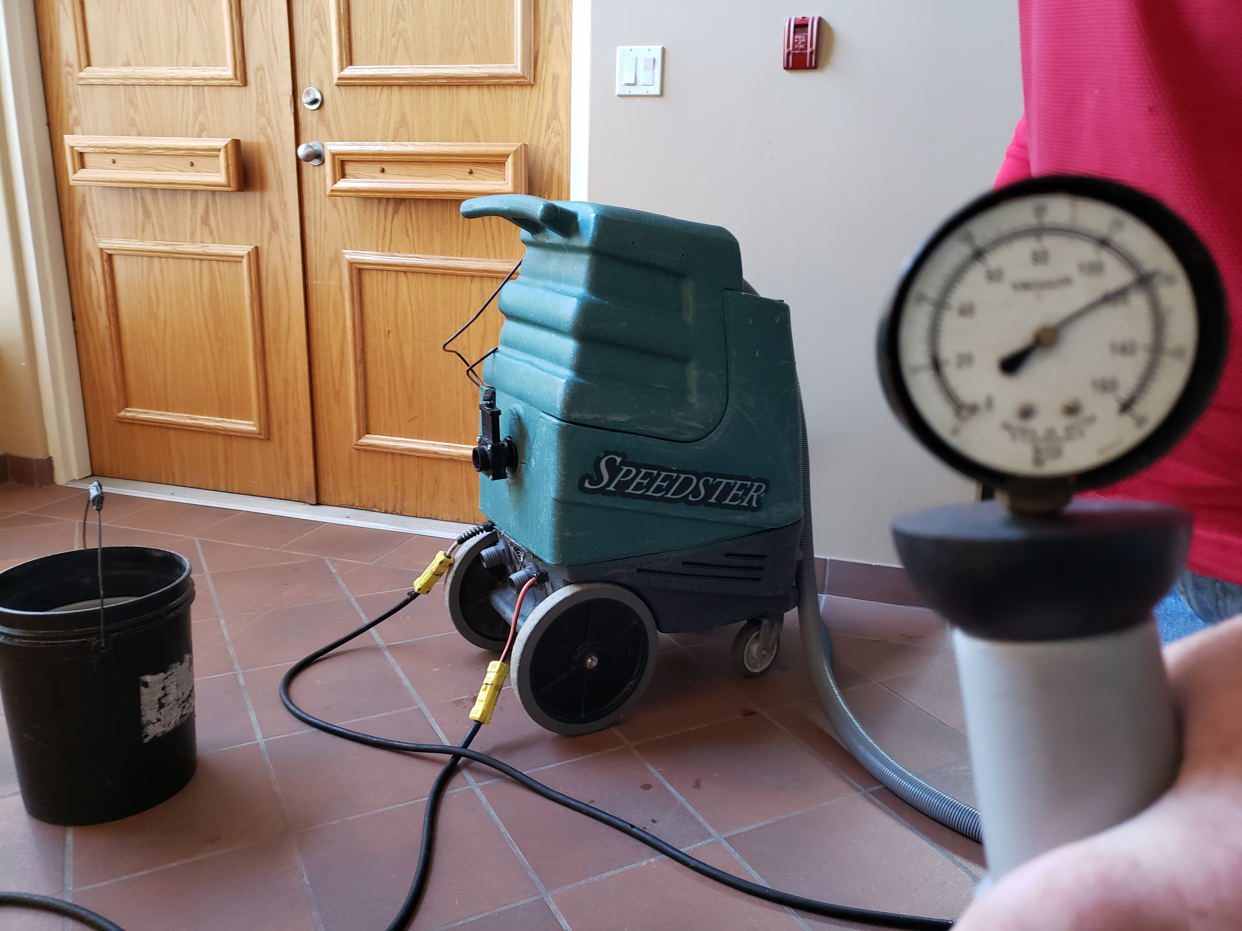

The vacuum off of my old Mytee with simple 5.7 motors running in parallel show I'm getting 120 inches of lift. Motors are a year and a half old and near the end of the life cycle. This was the results I got through 35 feet of 1.5 inch hose.

I get closer to 135 inches on my speedster. Probably around 180 CFM on 2 inch hose.

Ah, but will it be able to run on 2, 15 amp circuits still?
For us less fortunate folk up here in Canada....
Hard to say, I don't have any experience with those vacuum motors. If it's a 1/3 HP, the amperage should drop to 2-2.5 amps. There may be enough room. On those high amperage machines, best to not turn on the vac motors until your vac hose is connected to the wand. The more restriction, the greater the amperage drop. My 13.8 amp 3-stages drop to 12 amps. My 1/2 HP pumptec draws 2.74 amps after starting. When using my big portable, I usually prespray with an inline sprayer and just leave the pump motor running while I set up the vac hose and wand. I am 12 amps on one cord and borderline 15 Amps on the other. If you start the pump motor while the vacuum is running, the sudden spike may trip the breaker.
