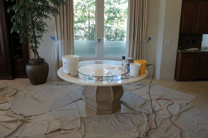

For this particular table, I did a quick polish with KP-92 to get most of the polish, keeping it very wet. This keeps the friction to a minimum, reducing the possibility of orange peeling the limestone. Then I went over it again with the MB-12 lightly to get the final pop, sort of like a glaze.

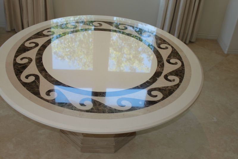

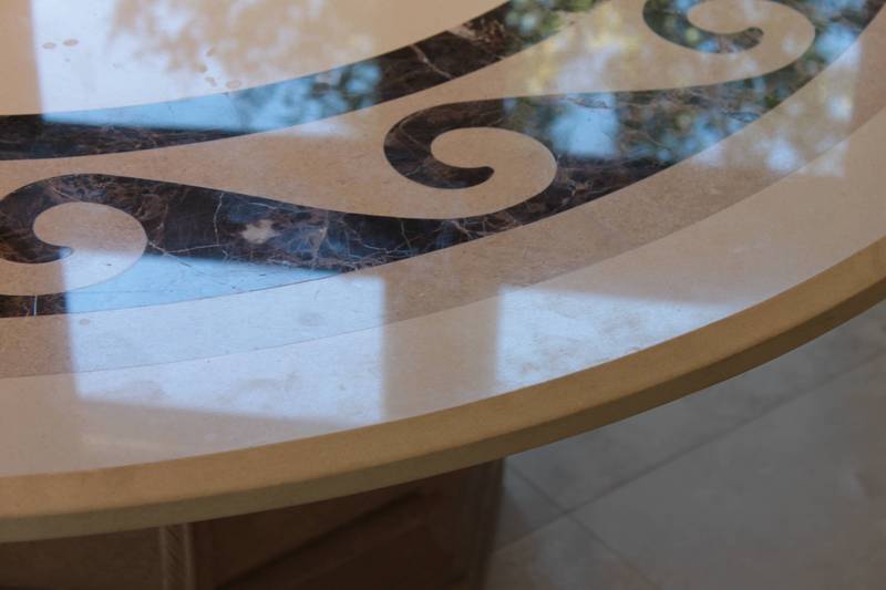

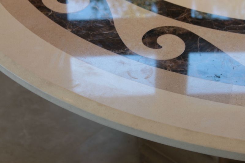

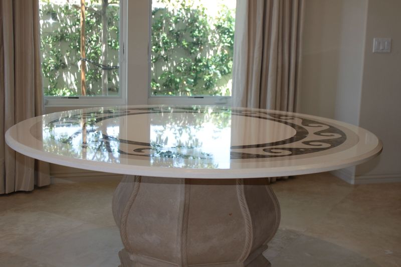

This table wasn't it bad shape, but they wanted it like new.

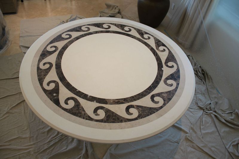

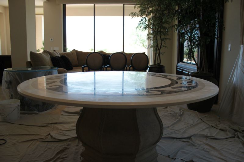

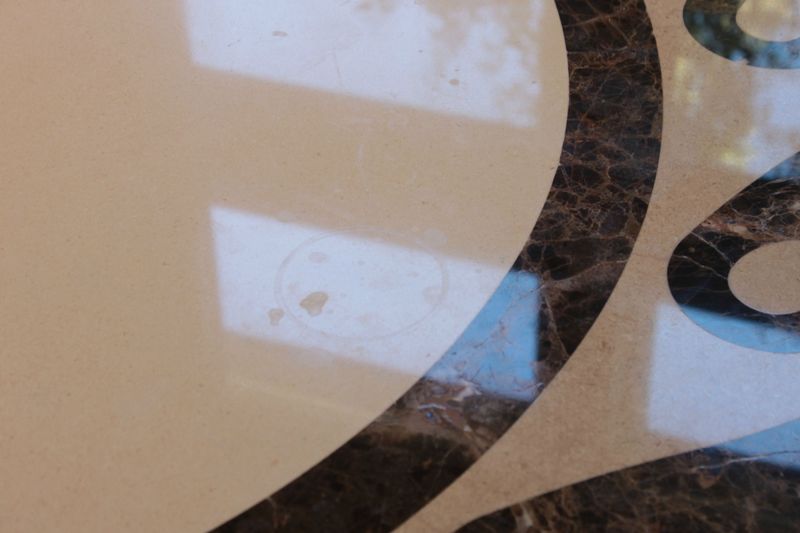

This is after diamond refinishing, before polishing. Getting the finish to this point with diamonds makes the powder polishing much easier and faster.

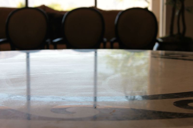

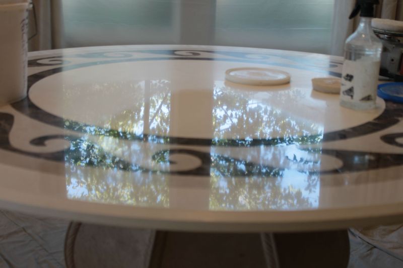

After the KP-92. Notice the blurry reflection, but nice shine

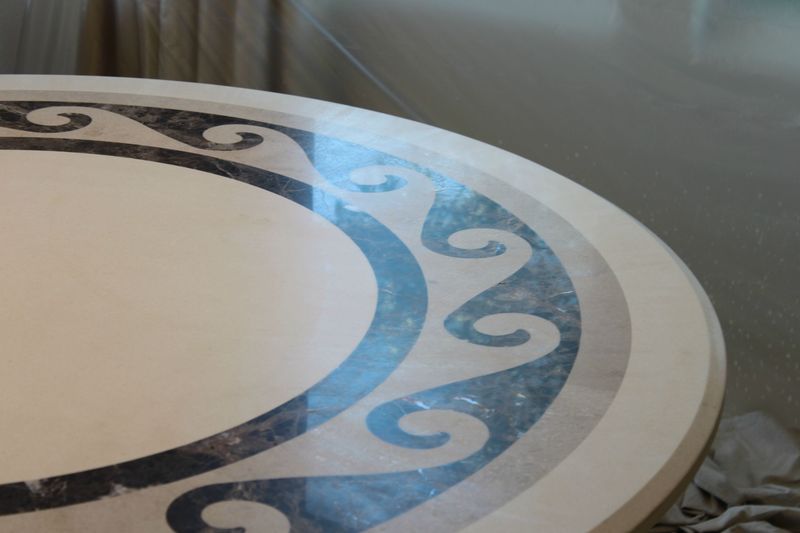

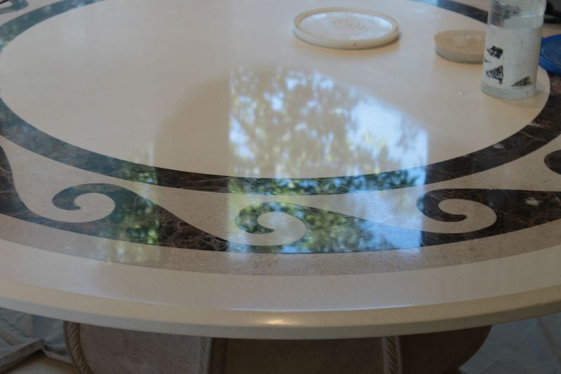

After the MB-12. Notice the crisp clarity and brighter reflection.

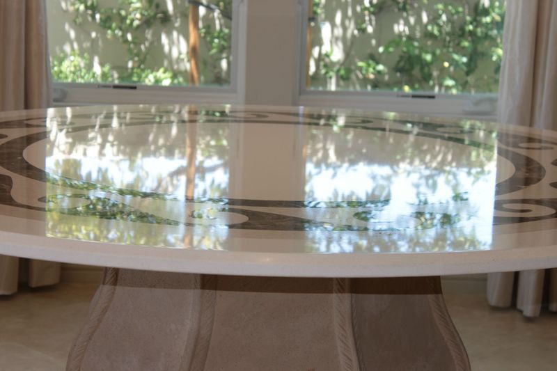

Notice there is no dip or bob int he reflection. This is why rigid diamonds are a good idea. Most of the time it isn't an issue, but when you have a surface with extremely soft and extremely hard (relatively) together, it's a good idea.
