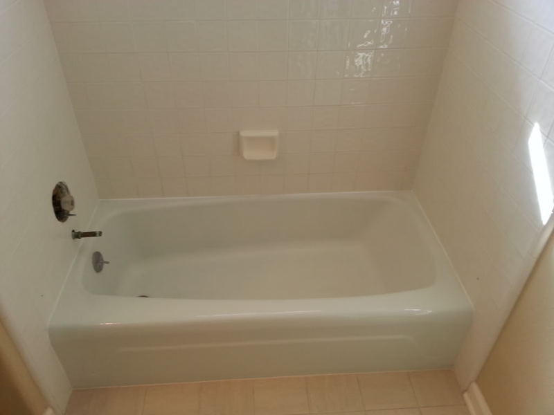

typically...
razor blade as much soap scum off all flat surfaces as possible.
Spray down acid cleaner or non acid soap scum remover and scrub
Rinse with shower head or pressure line
Alkaline spray and scrub, rinse again with Cobra hand tool
Dry
Remove damaged/rotted joint between tub and wall if needed.
Polish tub if needed with Magic Als, diamonds, steel wool. etc..
Seal grout/stone Leave fan overnight
Return next day to replace silicone or grout.

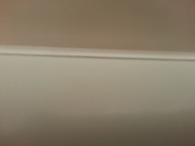

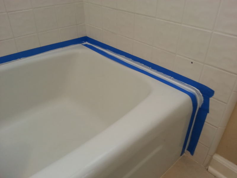

Mask off the wall and tub. Makes it easy and the finished look is stupendous.
When you remove the tap you'll have a slight hard edge to the silicone. Take a wet finger and do one long continuous wipe to smooth the edge.

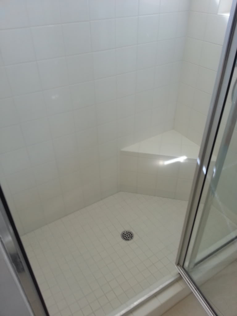

Nice clean but boring shower stalls...
This one got the perimeter edge re-grouted/layered. We use Concrete Fortifier (glue) instead of water and unsanded grout when doing these sort of repairs.
