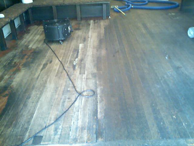

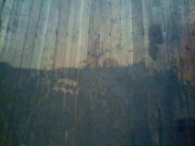

Got a real greasy breakfast joint to clean the wood floors at today.
Lots of mop residue and bacon juice. Wood is severely stained and "worked"..
How about some 02 and a glug of Purple followed by a red pad and a rinse?

What was a 70 year old beat to death, filthy, muddy, grungy disgusting shit pile of a Doug Fir floor that had not been more than mopped in the last 24 years is now a clean beat to death, disgusting shit pile of a Doug Fir floor..

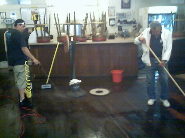

PS-what is the old guy holding? I hope it is a sqeegie,kinda looks like your getting the flood house ready for a class :lol:

You big sap sucker put your daddy to work didn't you!!!!
