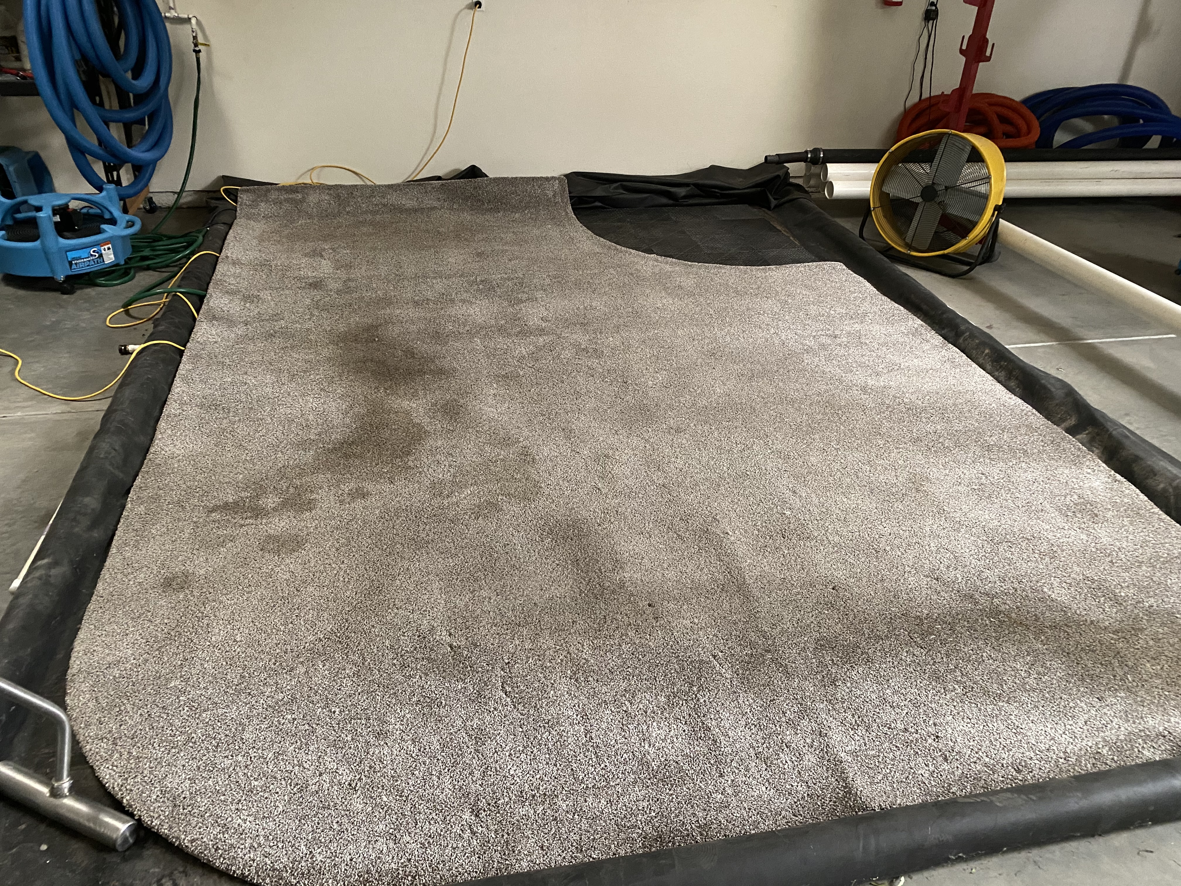

I need a bigger pitt
24,051
They just keep getting bigger. Urine soaked of course.
24,051
soaking a tufted carpet?
good luck
No, this is actually a custom cut piece of carpet with the edges sown. Normal primary and secondary backing like normal residential carpeting. But this has so much urine in it, I took it to the shop to really clean it good. I can flush all day in a controlled environment.

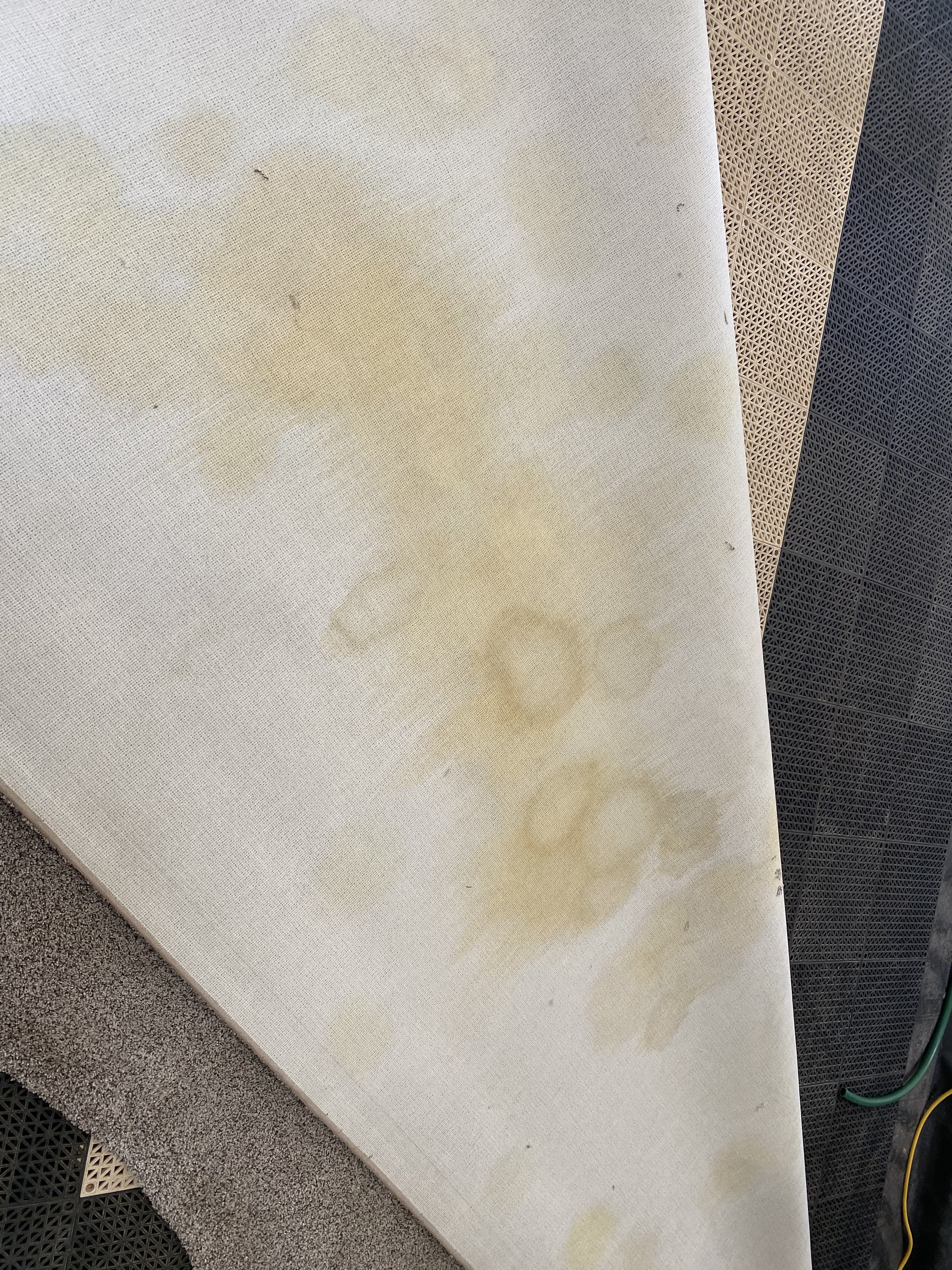

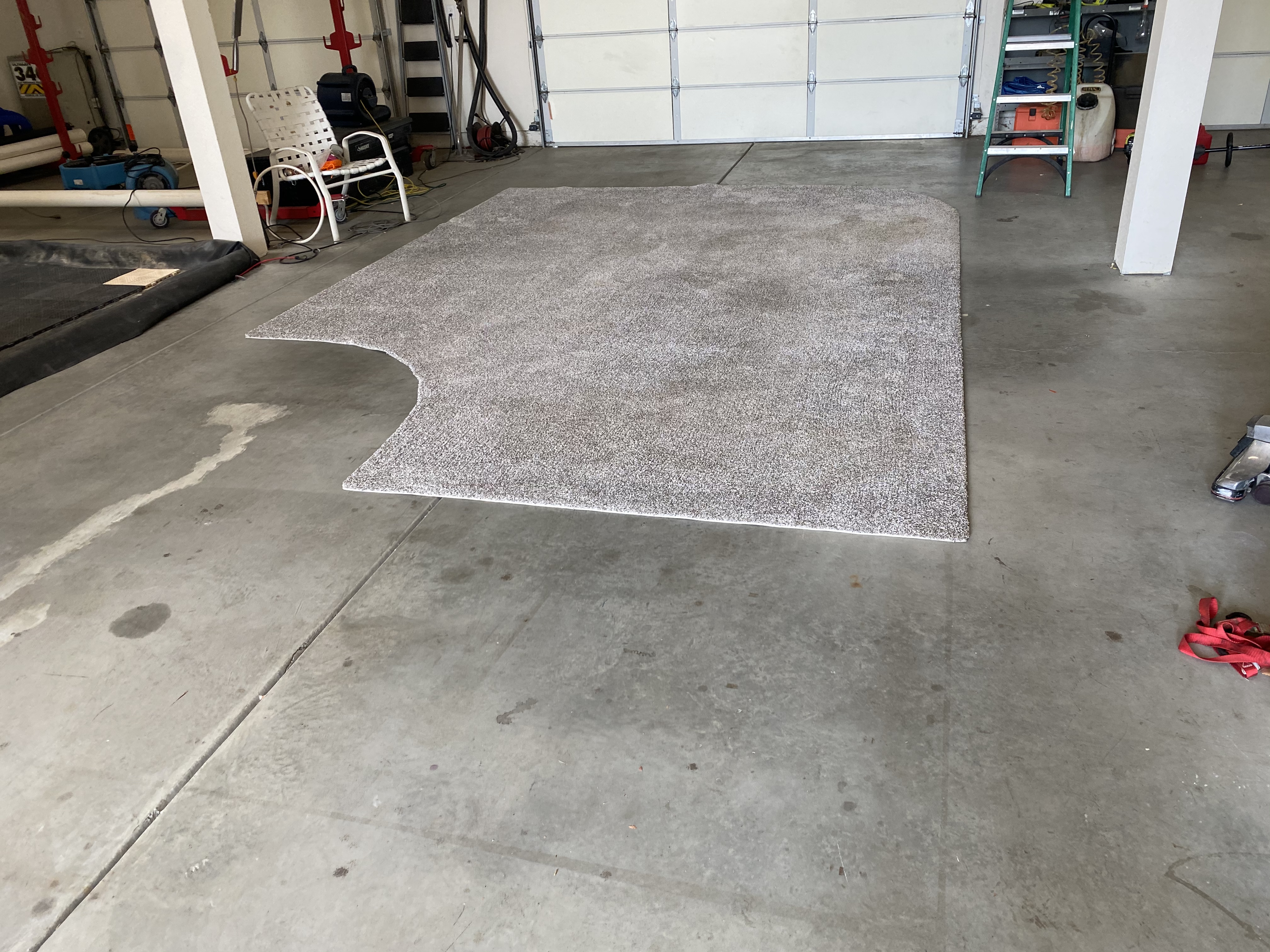

Ugh. Damn this urine soaked rug. Coming out better. Heading back to the shop for a final check.
