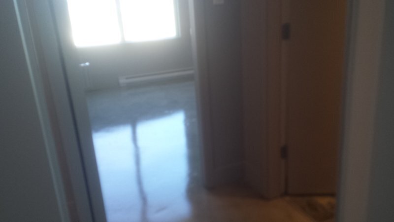

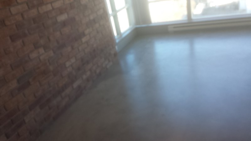

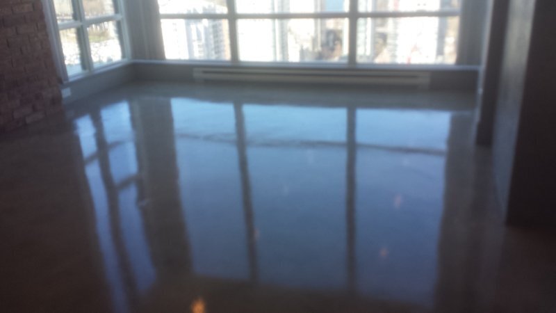

Depends on what's already there. Today I'm using a nuetral cleaner, a 175 and a blue pad to prep, Buckeye Proclaim as a finish as it just had an epoxy applied a couple of weeks ago and urethane products work well with that. On some they've put finish on so it has to be stripped. Depends. I'll post pics at the end of the day.

Here's todays stuff.
