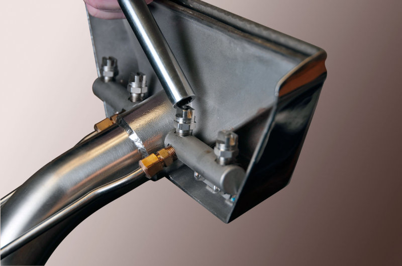

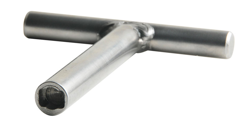

Those jets look like they're hard to access for any service that needs to be done on them. WAs that just a complicated shadow I'm looking at or is it a tight fit for the socket to remove them?

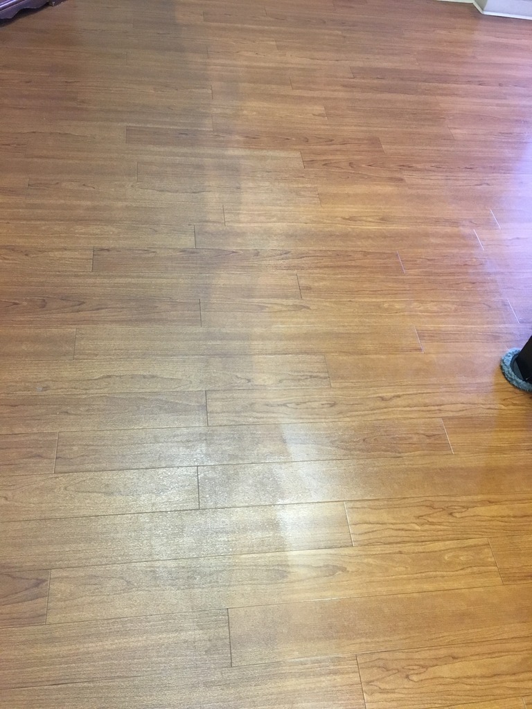

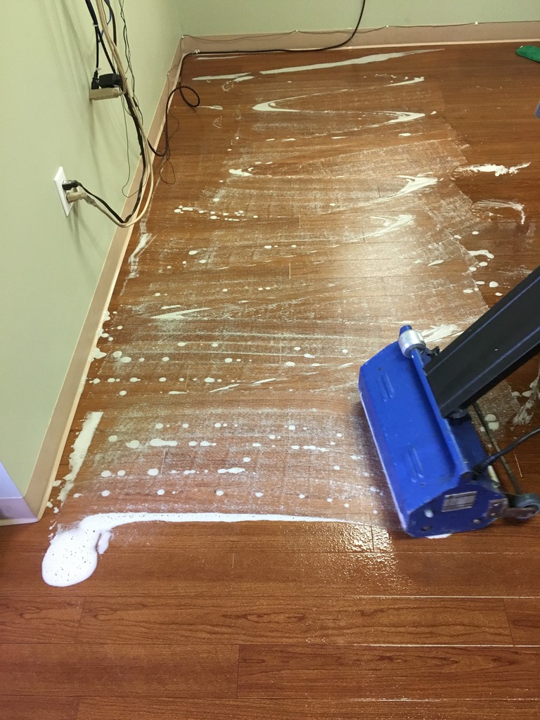

If you have a laminate cleaning procedure, it should work to clean the construction dust.
These photos are from a job where the vinyl had a texture to it. I hope the previous cleanings with a black pad did not ruin it.
We used only flat mops for extraction. A CRB is the right tool for this type of job.

Yep. Looks very similar different color. What did you use for a cleaner? Daily neutral or Bruce?
