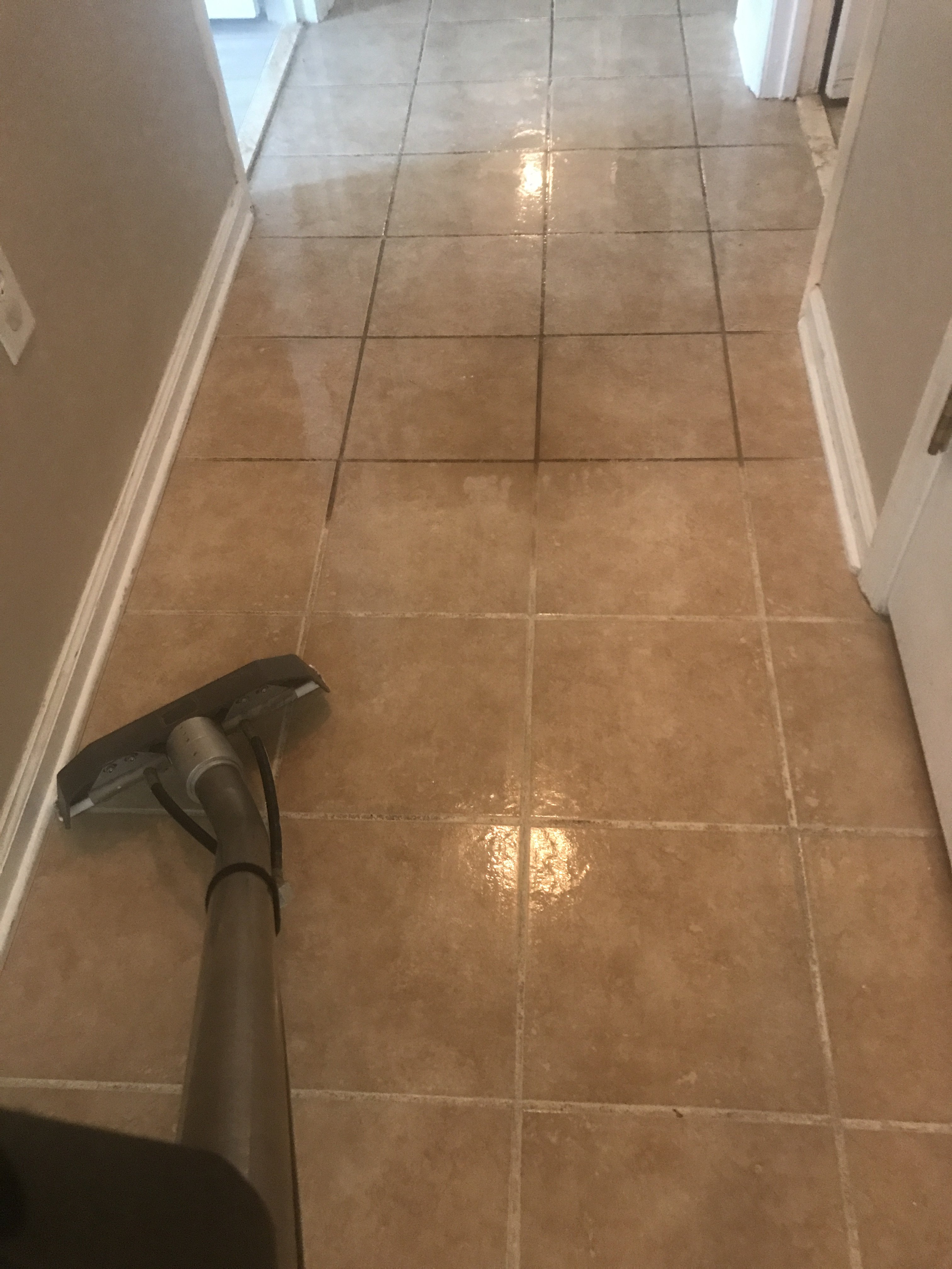

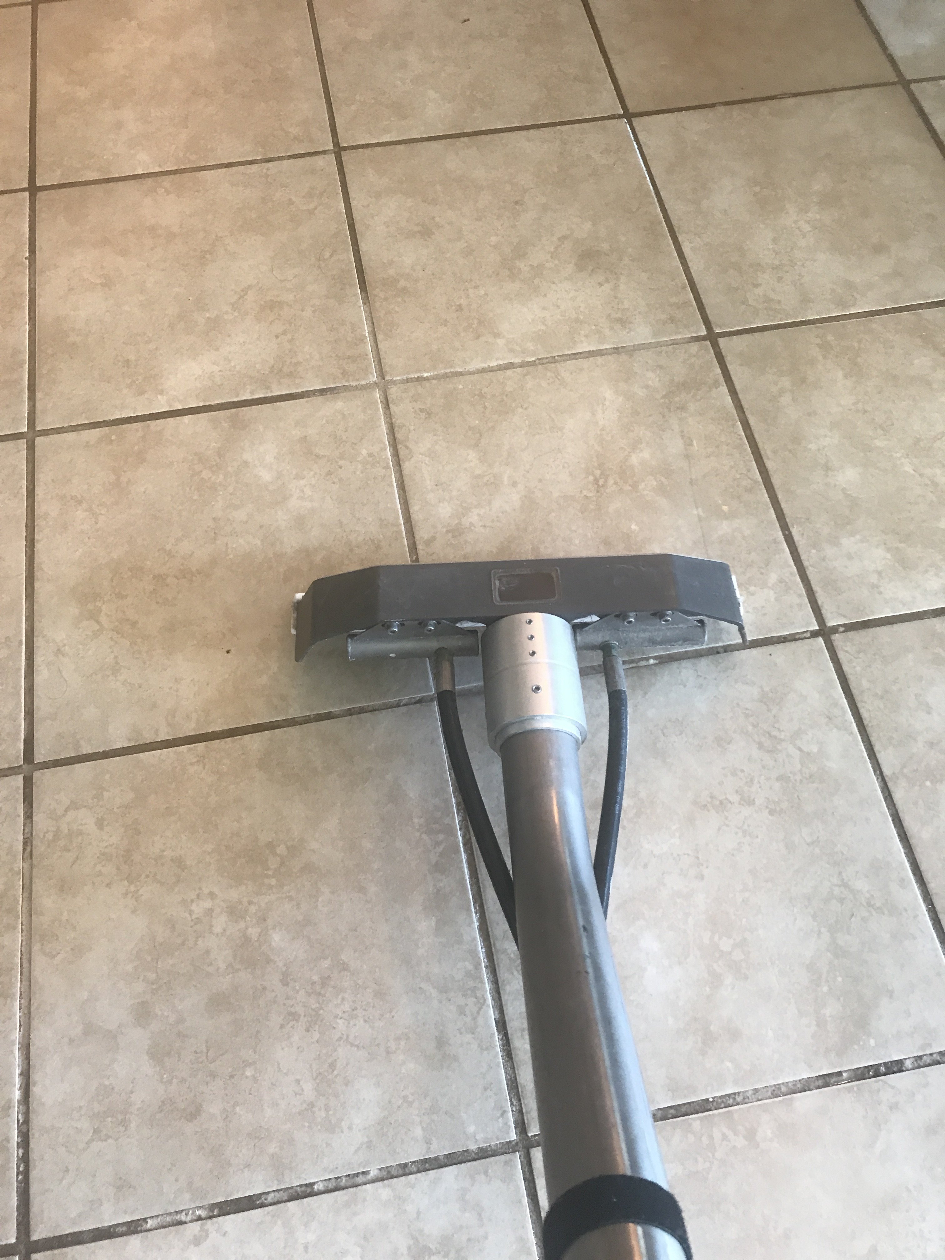

Jun 18, 2020 #3 Trip Moses IMOL Joined Sep 19, 2018 Messages 3,624 Location Savannah GA Name Trip Moses I am starting to feel that color seal should be done on every job.

Jun 18, 2020 #6 Mikey P Administrator Joined Oct 6, 2006 Messages 116,025 Location The High Chapperal what in the hell is going on in that grout line?
Jun 18, 2020 #7 Trip Moses IMOL Joined Sep 19, 2018 Messages 3,624 Location Savannah GA Name Trip Moses All the above. Poorly mixed grout. Missing grout. Bad installation. Old DIY color seal.

Jun 18, 2020 #9 Mikey P Administrator Joined Oct 6, 2006 Messages 116,025 Location The High Chapperal Why not use a Spinner?
Jun 18, 2020 #10 Trip Moses IMOL Joined Sep 19, 2018 Messages 3,624 Location Savannah GA Name Trip Moses I wanted to leave what grout was there in place.
Jun 18, 2020 #11 Trip Moses IMOL Joined Sep 19, 2018 Messages 3,624 Location Savannah GA Name Trip Moses Plus the amount of lippage that floor had the spinner would’ve been very annoying to use.

Jun 18, 2020 #18 BIG WOOD The Timminator Joined Feb 4, 2016 Messages 14,109 Location Georgia Name Matt w. Looks like Murphy's oil for tile is on that floor
