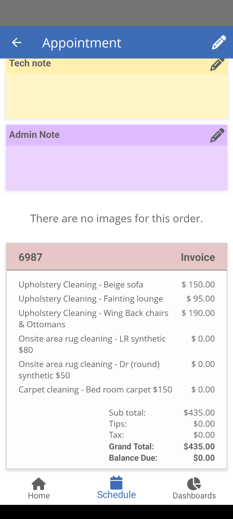

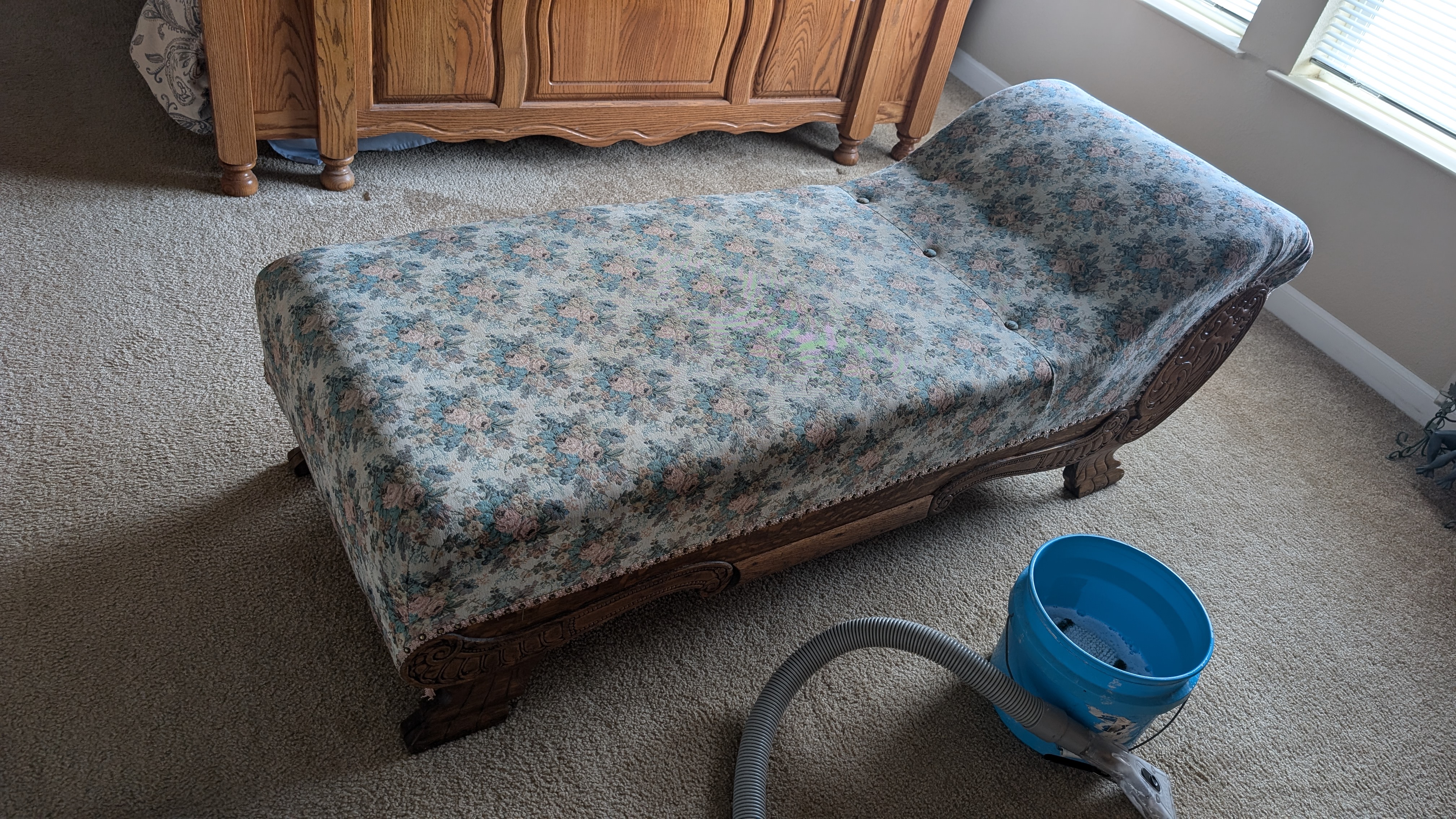

I quoted this lady 480 to clean this "fainting" settee and a few more modern pieces..
Upon arrival some of it turned out to be easier than the photos led me to believe, so I knocked 60 bucks off the price, and I nearly fainted
when she wrote me a check for $500..
And booked me to come back later this month to clean the floors..
