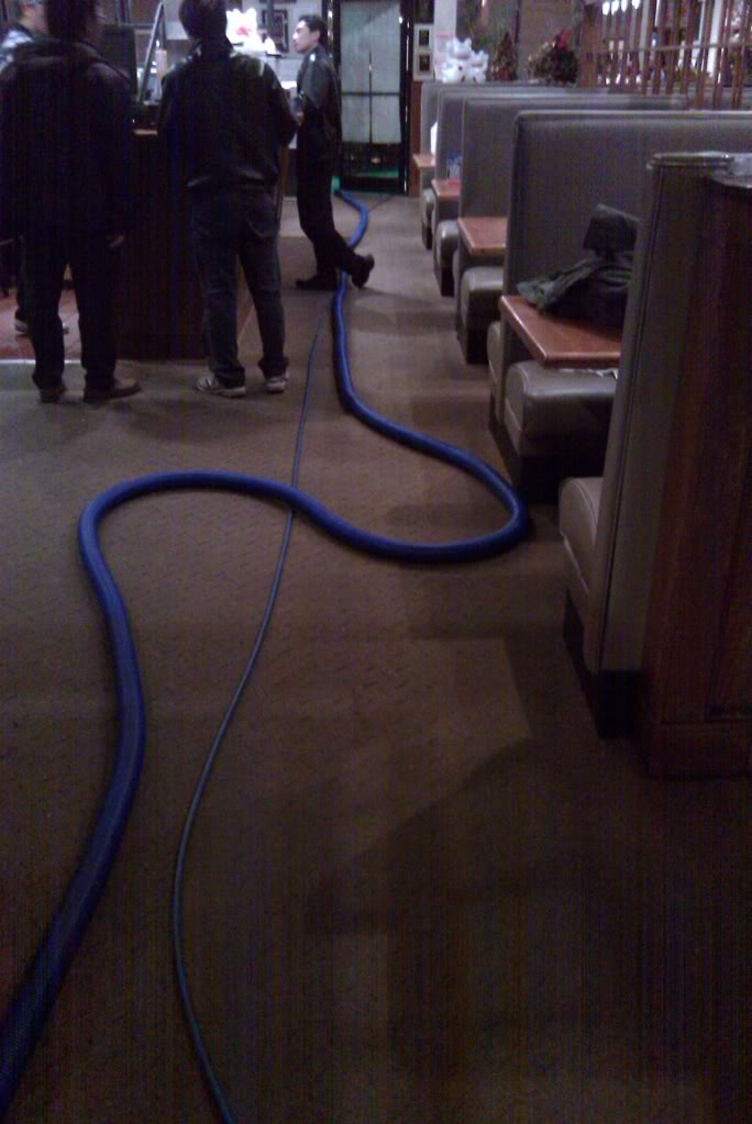

I can not get this carpet clean.
Sep 7, 2008
3,797
I have a restaurant that I have cleaned I believe 6 times once a month. To me restaurants are a walk in the park. Just use a high ph enzyme pre-spray, HOT water, and if it is real bad a good pre scrub. The cleaner before me was using a portable and the owner was unhappy because after cleaning the carpet the place smelled real bad afterwards for several days. I went out and did an estimate and thought to myself this is a light tan carpet with black traffic patterns from grease and the carpet should clean easy and the color should pop back to life. The first time I cleaned it I used my normal pre-spray (powerburst) and scrubbed it in real good and hit the carpet with the RX with acid rinse run heavy through the line. My concern was the hack before me was running purple power or similar through his machine so I wanted to neutralize the carpet somewhat. I noticed from the start that I was in trouble because the carpet just wasn’t cleaning at all. I ditched the RX and finished with the wand. The carpet looked marginally better.
The second time I cleaned it I used a glided wand. I even hooked into the hot water and was running steady 230 with an RX. For some reason water puddles real bad in certain areas I believe from low areas in the carpet. This makes cleaning more difficult.
I cleaned the carpet tonight and even post buffed the carpet and it just looked like crap imo. The carpet is an olefin glue down that isn’t greasy as much as it is oily. It’s like someone poured cooking oil all over the carpet and ground it in real good. I am tempted to just spray the carpet with an acid rinse and clear water rinse it, but there is a lot of grease it each time I clean it. Tonight I boosted my pre-spray with citrus and I think that just compounded the problem. I told the guy he may just need new carpet. He has tried several cleaners and is happy with me, but I told him tonight after cleaning that the carpet looked like crap and it should be much cleaner. I said I would do some investigating to see if there is anything I can do different. To be honest I am just sick of dealing with restaurants and have cut back on the amount I clean. The only reason I clean this place is because of all the gorgeous Asian women working in this place.
I also used a good encapsualting bonnet cleaner after steam cleaning the carpet and it really did not help that much.

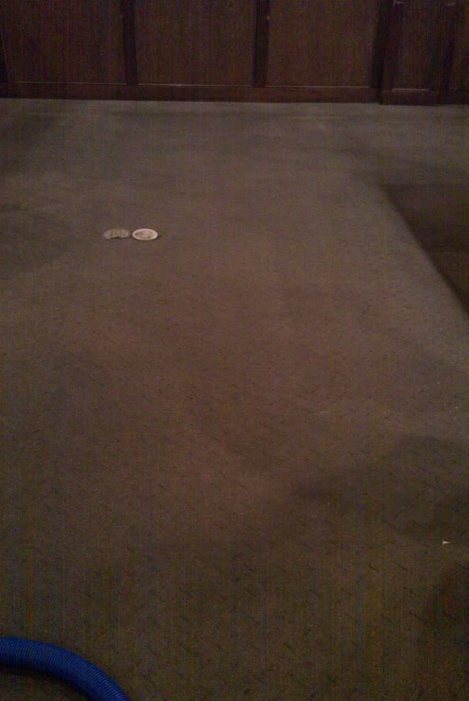

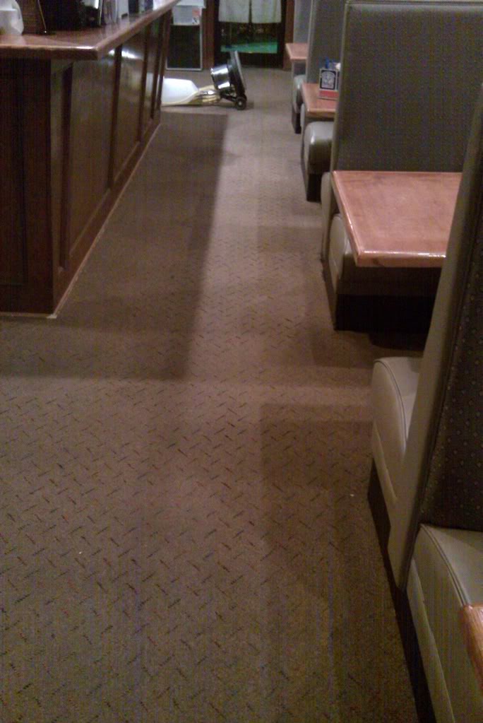

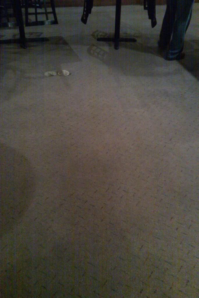

Yes I was thinking a dish detergent would be the best solution. Rinsing the carpet is a little challenging. I have a holed glided wand and for some reason the check valves make the spray pattern not consistent. The spray comes out different with each key of the wand. It does ok though. The rx rinses the best but in some areas it does sling water. Joe I am going to try your approach. The good news is it is not a lot of sq ft (just under a thousand) so I can be more aggressive.
Also last night I added Flex to my prespray. The front of the restaurant cleans up ok. Another thing is the lighting in this place. The light comes from so many different angles and it is not brightly lit and some areas look dark but it is shadows however still not clean. Here are a few photos. The quality is not good because of the lighting.
Before
After
Before
After

wow...it actually looks a lot better than the image i had in my mind from your original post.
I just think you need to kick up the oxidizers, and even do a 40 vol. post spray of peroxide like you were spring protector...and obviously your are getting some olefin traffic gray....but i think the owner understands. You are just buying them time til they replace...hopefully with a decent nylon that you will help em' select.
As for your checkies, just remove the jet, use a 5/32" allen wrench and back off the brass internal keeper 3/4 of a turn, this is needed on some prochem Quad jet wands. hen every 6mo. check them...tighten all the way down, and back off 3/4 turn.
