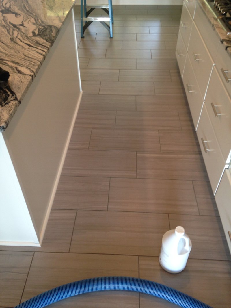

IMG_1414.JPG For me, anyway. We cleaned 3200 s.f. of this. ^^
It had grout haze all over it. I didn't know how to approach it, so I called Mikey and got the scoop. It turned out great. THANK YOU BUCKET HEAD!!!
I elected not to call Saiger, because I really needed to get it done before dark.

View attachment 18887 For me, anyway. We cleaned 3200 s.f. of this. ^^
Is a ladder the secret to success in big tile floor jobs?
I knew I've been missing something.

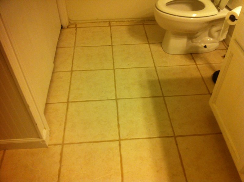

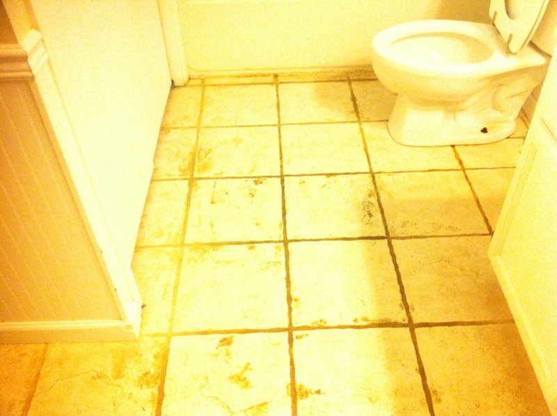

Sometimes installers (and especially do it yourself types) use a broadaxe to smear the grout around. This blurry picture shows one that actually looked like dog poop. I had to use a concrete brightener (phosphoric mix acid) to soften the grout and work it down by hand, as a pad would have torn itself up.
