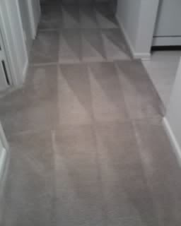

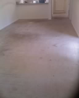

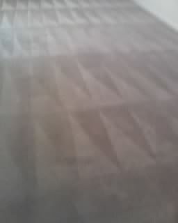

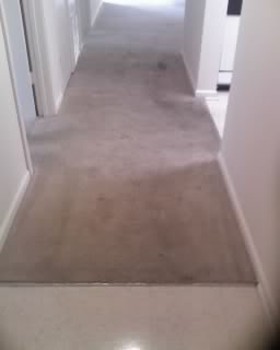

Here is a job we did today; Shampoo'ed first presprayed after; Turned out great!!!
Before
After
Before
After
