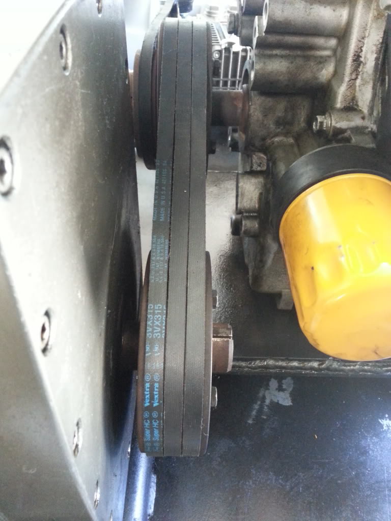

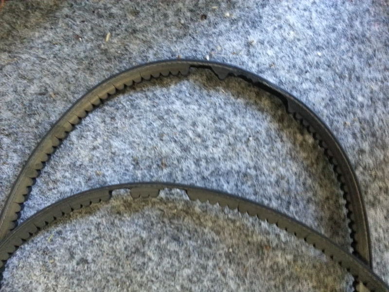

How often are you going through belts on your slide in units?
116,029
I'm pretty sure this is my third set in 780 hours..

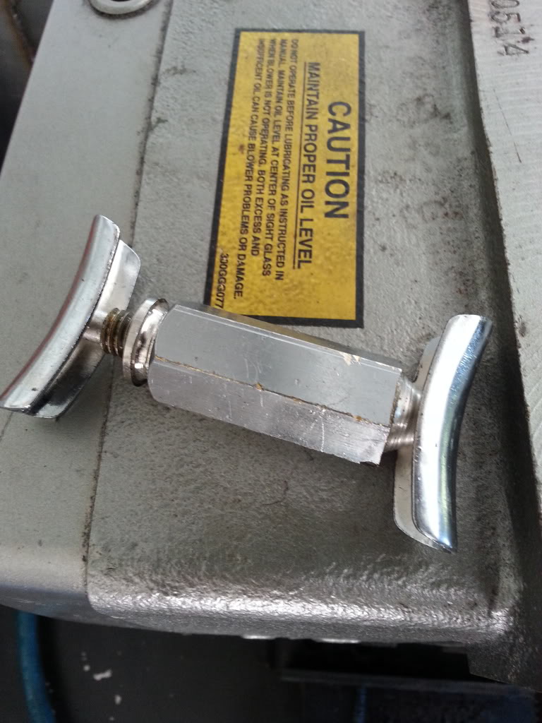

I'm snugging them up to what "feels" right and snugging them up again after a few days of replacement, even using this tool to do the centering/tightening..
Looks good and straight..
