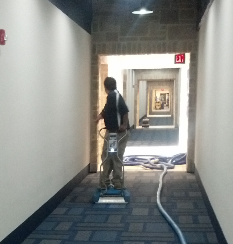

I just the @rhyde lean method to get most of the water out of non-bleeders then Zipper it to extract.... I'd want a centrifuge spinner as a next step.... Time is something I don't have much of....:dejection:

I seen his setup, looks nice... I also looked into RugTech equipment offerings.... I'd need to know the pro's/con's of both wringers before I decide.... Maintenance is a big thing for me as I need to do it myself because were out in BumF*ckEgypt...........
