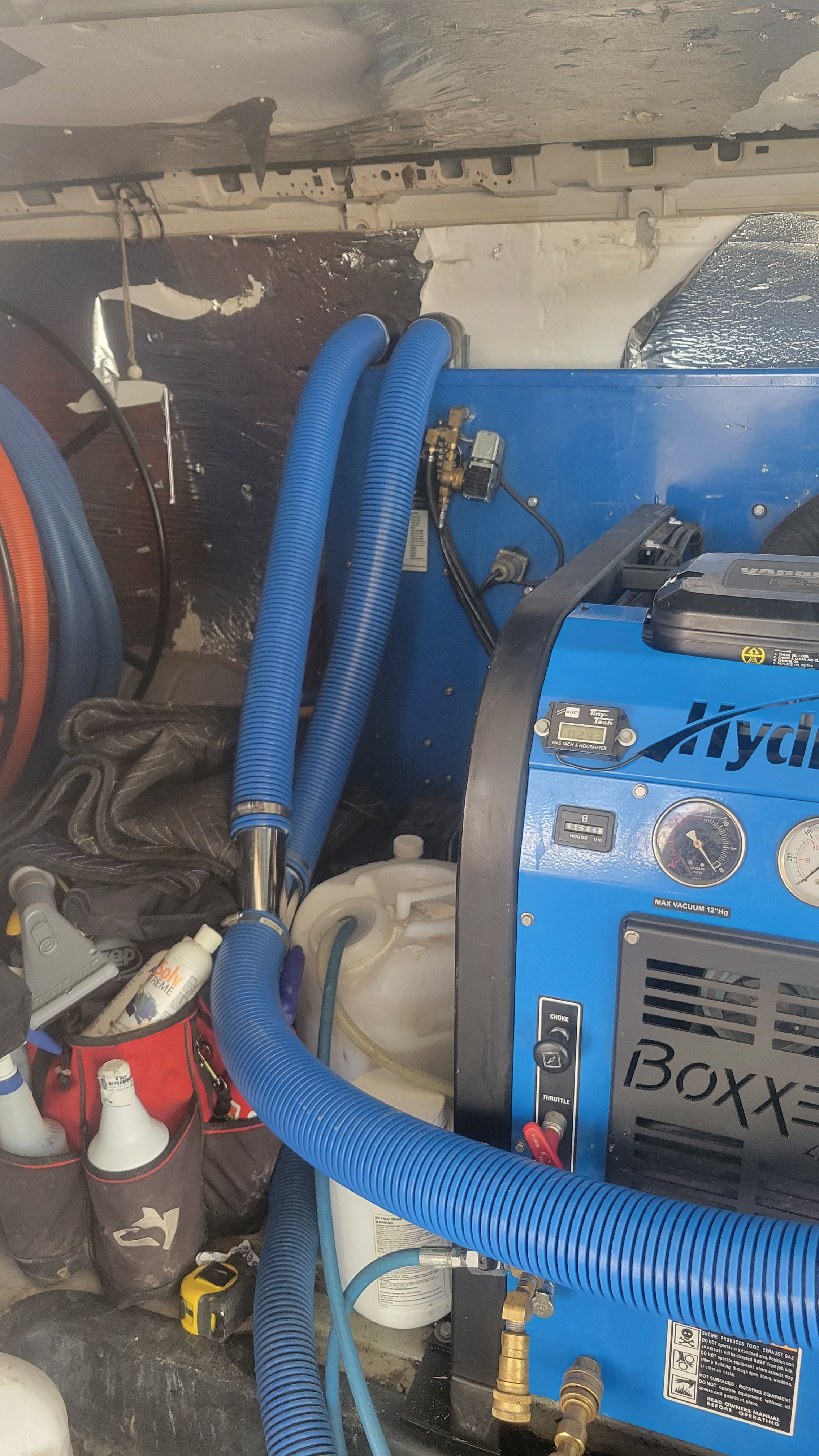

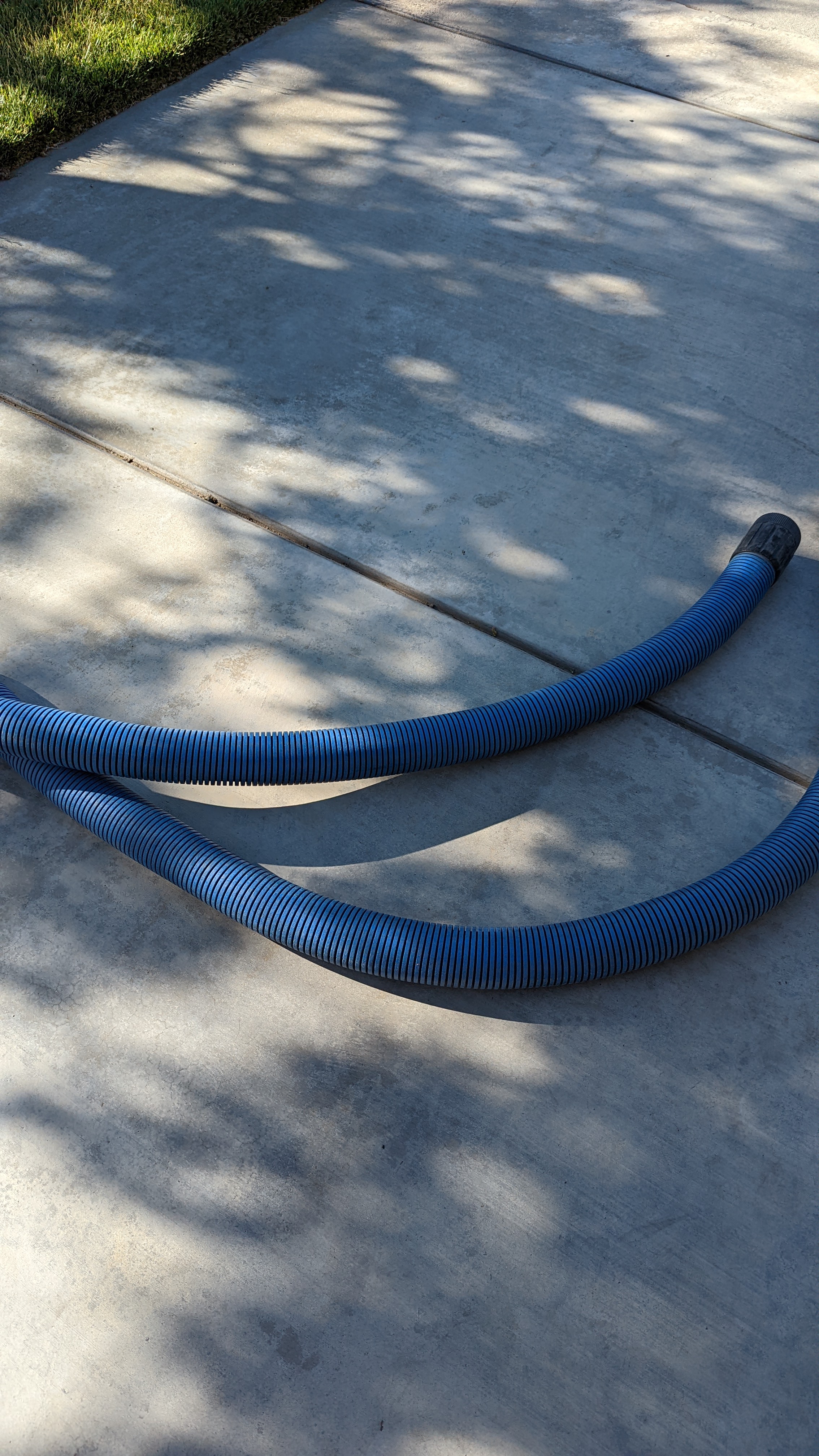

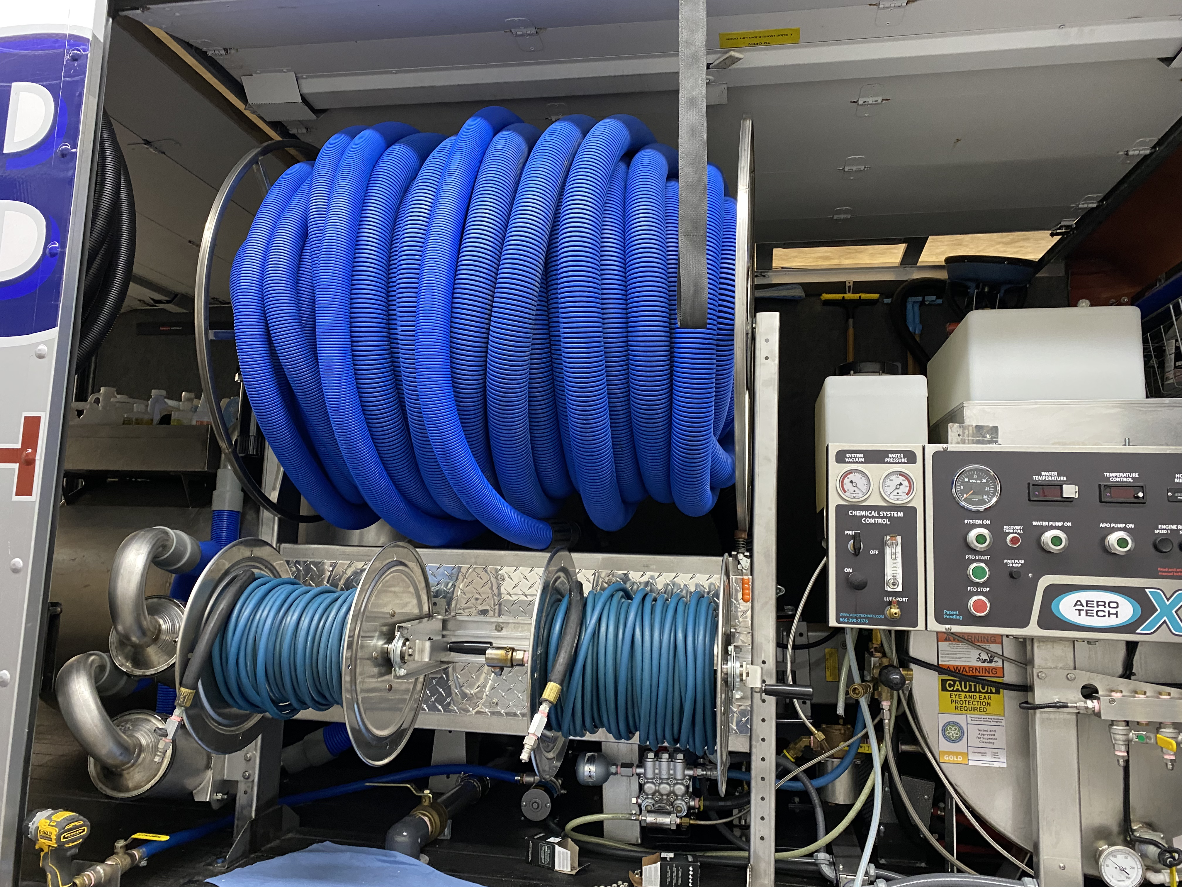

PXL_20220610_150246364.jpg PXL_20220610_150426695.jpg PXL_20220610_150305294.jpg

I'll use 100' of 2.5" after 150' of 2", if needed. I think there's another 50' of 2" under the 2.5".

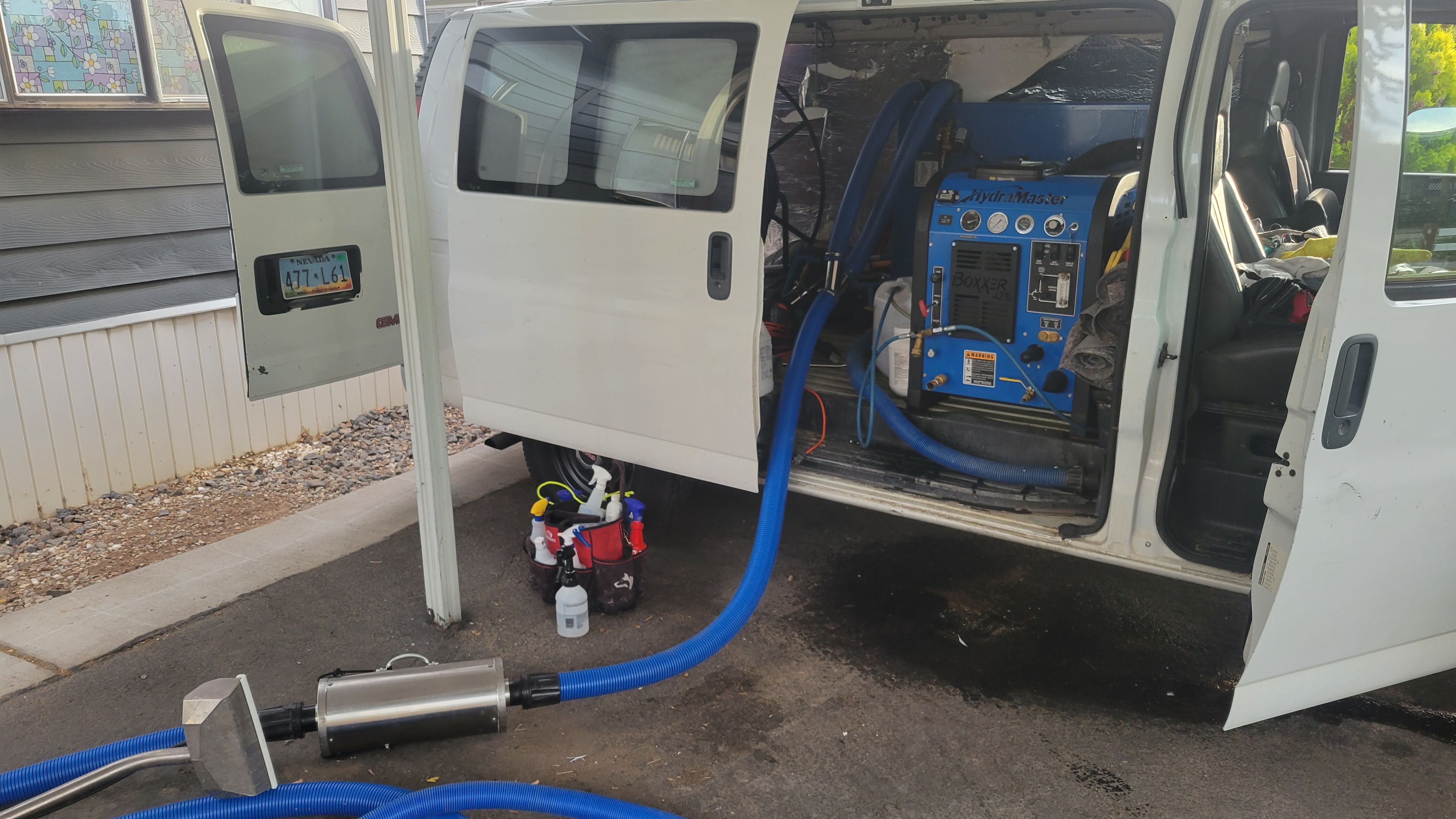

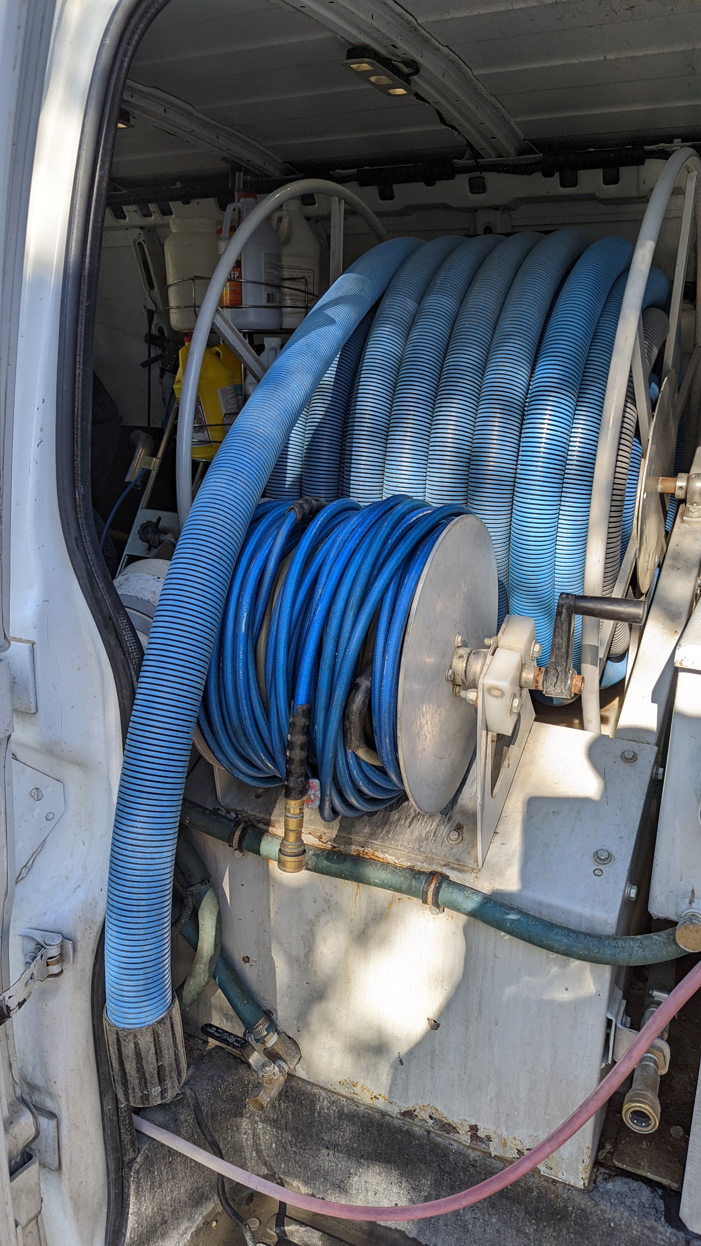

Using 50' 2.5" first time yesterday and all day today. It's worth it.

I dunno about buying it, I'd have to try it. I got this used and it's my first truck mount that i got in 2019. The suction does well at 150 ft as long you set the blower for it. But the upgrading first run of hose to 2.5 improved it greatly. No complaints at all.
