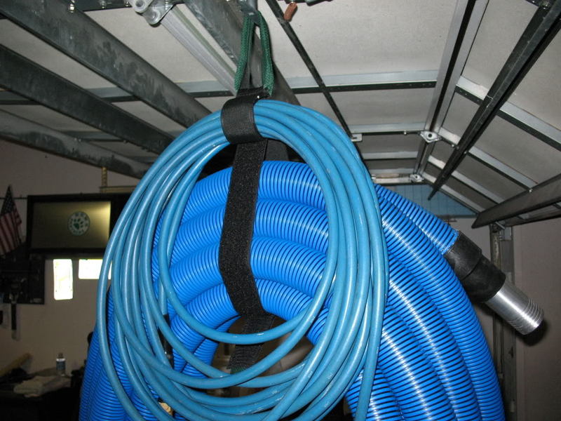

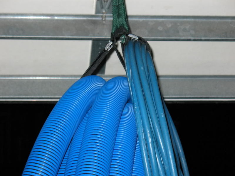

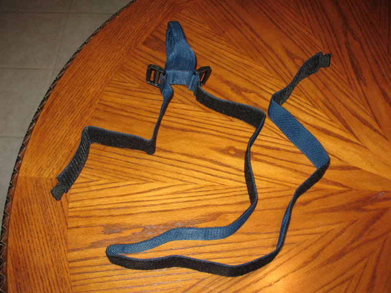

It's not just the stair hook that falls short with 2.5", other factors too, like finding a good velcro strap to hold 50' of it as it's a bit bulkier than 2", also be nice to have a hanger loop/handle to carry it and hang it in the truck, be even better if it had a secondary loop to hold some spare solution line too, and speaking of stairs if you could wrap the velcro around you waist real quick like a belt you could have a hose hook on your hip and the hose would be out of your way while you worked your way down.
Someone should invent this kinda stuff for 2.5" users.

I found them, thanks for the specs Greenie
Even though this only a 2" vac hose, there is plenty left for a 2.5". All the 2.5" was on the truck and this was in the garage. Finally something that works and HOLDS. Used today going up wood stairs, worked like a charm. Haven't tried the belt loop thing yet.
