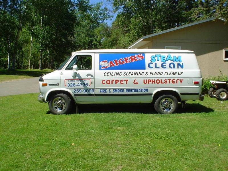

About the same, except we change the van motor oil every 1000 miles (hour meter is even low hours of run time), at 50,000 miles we switch the van motor oil to Rotella T 15-40. We have found this oil a real good product and have had friends test this oil with motors on dyno's.
We tend to have the transmission oil changed and filters replaced in the transmission once a year.
I just tend to dump oils early to keep things fresh and clean.
Vac, wash and armorall everything A LOT to keep them looking good. We rinse off the vans everyday in the winter before parking to make sure all road grime and salt are off the vehicles. And for us, they are always in a heated shop and out of the elements.
We do get over 10 years on some Butlers. We have a 1993 Butler and GMC that a family friend still uses to clean with part time that has 250,000 miles on the original drive train and motor, as well as over 11,500 hours of run time on the Butler and original van motor (which is another 379,500 miles on that motor!). That puts this motor at 629,500 miles of possible road miles! The motor just got a small oil leak last year I am told. I think it is a pan gasket. I am a firm believer of keeping the oil fresh and not letting the interior of the motor get dirt and grime in them that eats things up faster. Same with the blowers and cat pumps. Change the oil early! Oil is cheap and use good oil and filters!
We have changed out one drive shaft for the butler unit I believe on that system, and about 3 cat water pumps, but the blower is the original as well as the 210 waste tank and 110 fresh water tank.
The van is getting a bit rusty, but he keeps patching it up so it still looks good sitting in the driveway cleaning. But that little van has made a lot of people money!
Here's a pic of the old girl when I purchased it from the family to just start cleaning part time again while I was still teaching. She has been such good unit for our family. Gonna be hard to see the day she is permanently retired :(
