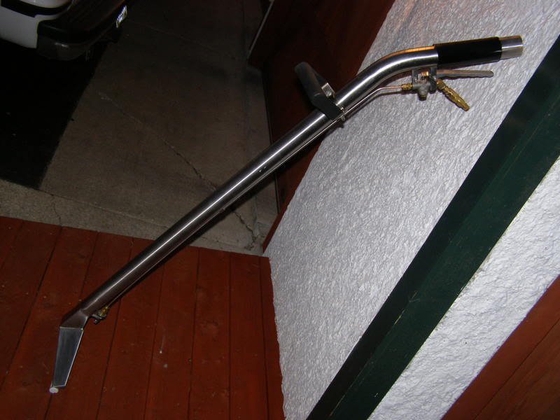

Doug Cox
Dec 17, 2006
4,908
Delavan, WI
Doug Cox
I have a 1.5" and a 2" Hydra Hoe (12") made by PMF that I ordered from Greenie. I'm 6'3" and they seem plenty long.
Doug Cox
Dec 17, 2006
4,908
Delavan, WI
Doug Cox
63" from head to bottom of tube (straight measurement).
Jim Nelson
Nov 21, 2006
499
edmonds wa
Jim nelson
My wand is 2in longer then yours but i am 5in shoter then you my assist handle is 4in from the valve holder you must have to bend way over to use that.
Doug Cox
Dec 17, 2006
4,908
Delavan, WI
Doug Cox
Not at all. Are you measuring along the full length of the throat of the wand or a straight line between both ends?

Jim Nelson
Nov 21, 2006
499
edmonds wa
Jim nelson
A Straight line. I put head on the floor an from the floor up is 65in. With the wand like that it hits me in the mouth.
