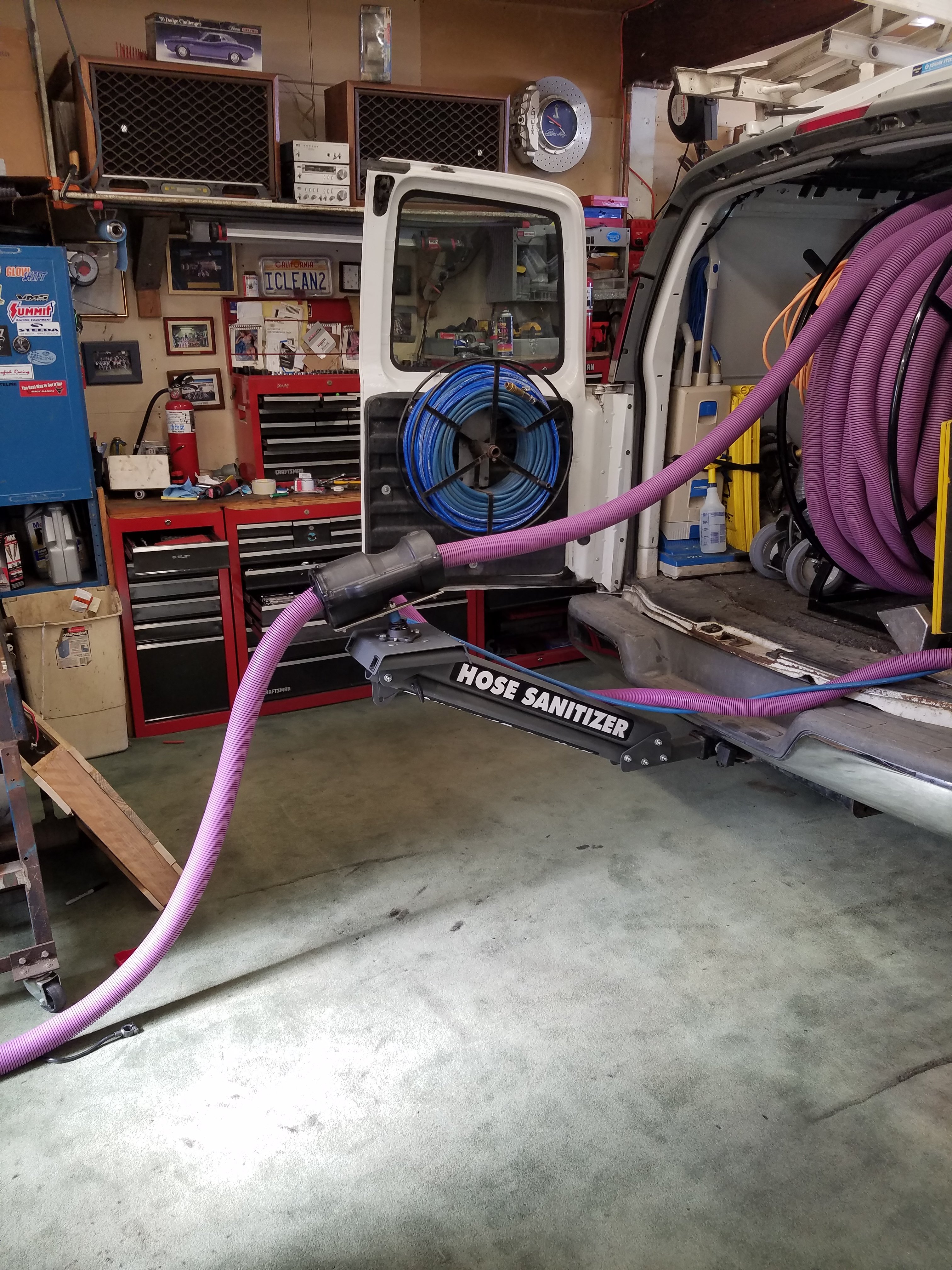

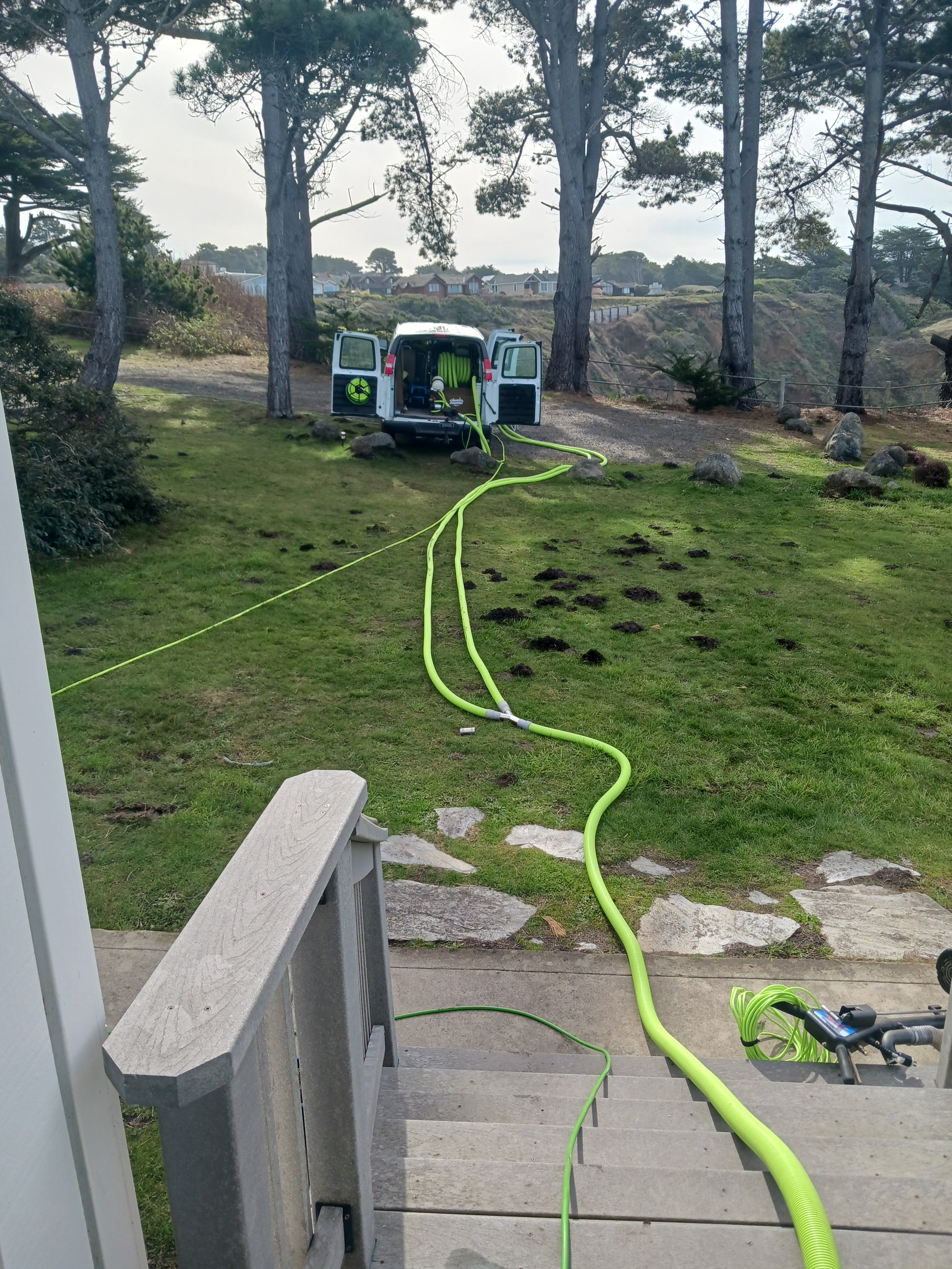

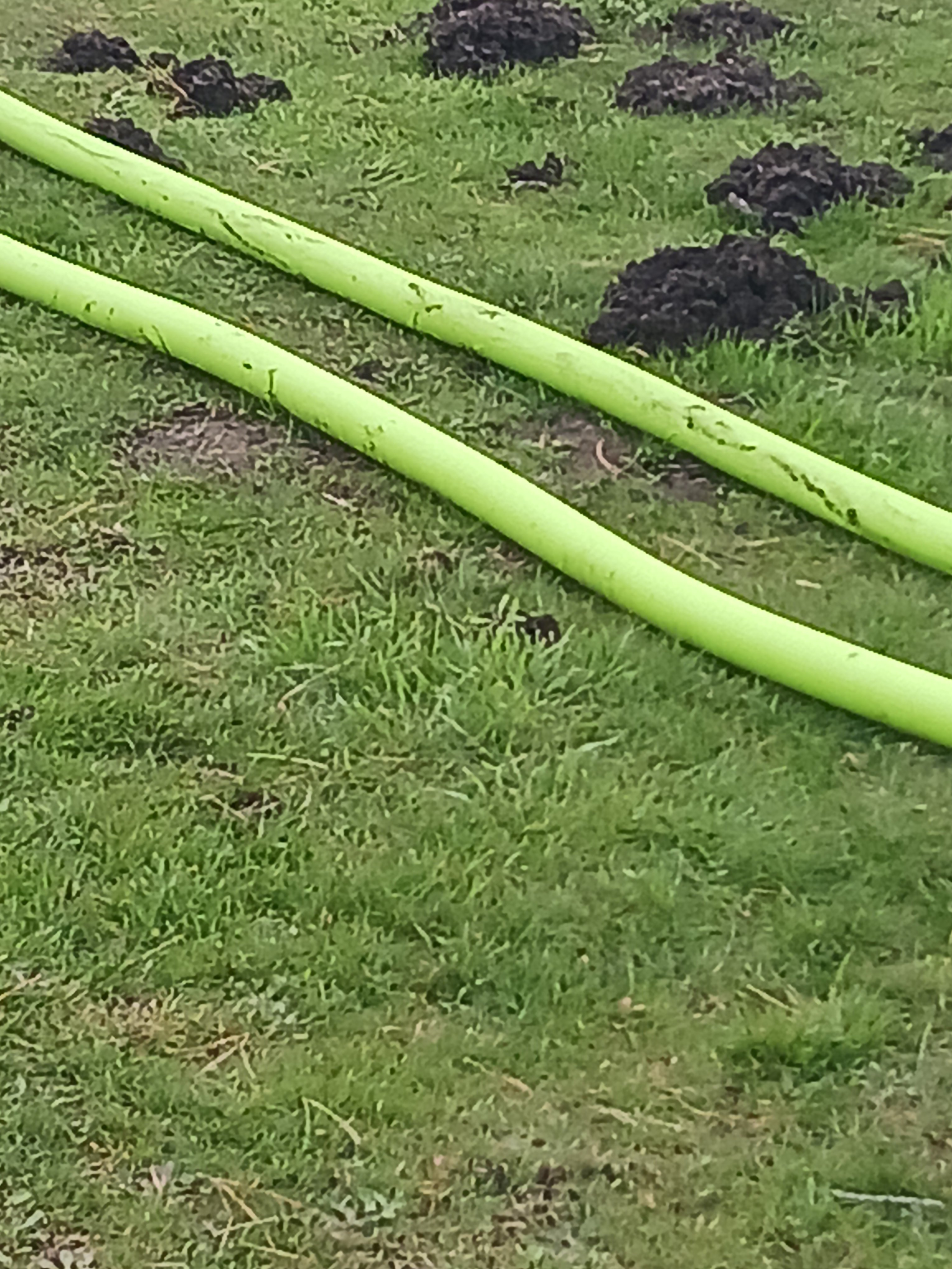

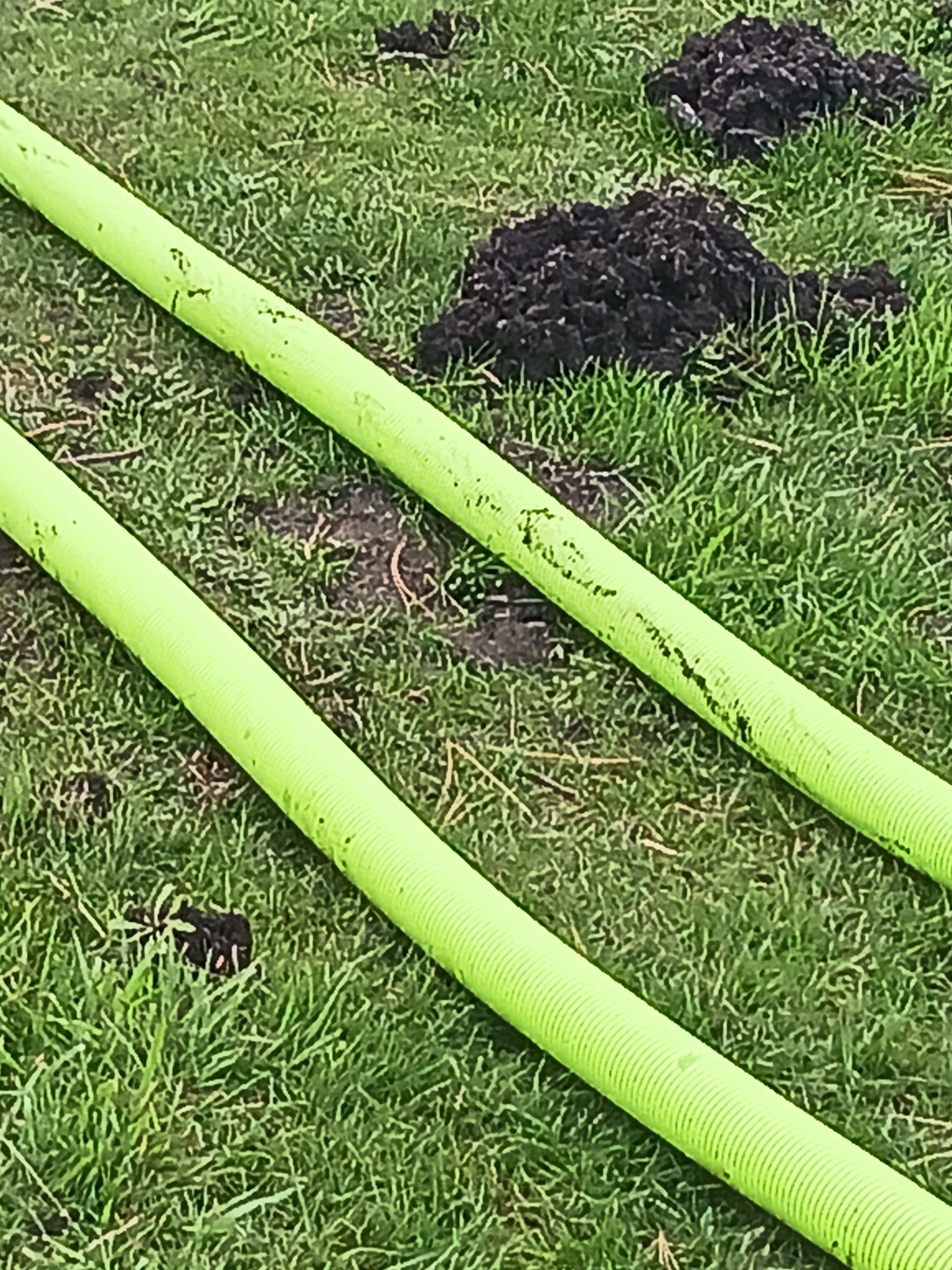

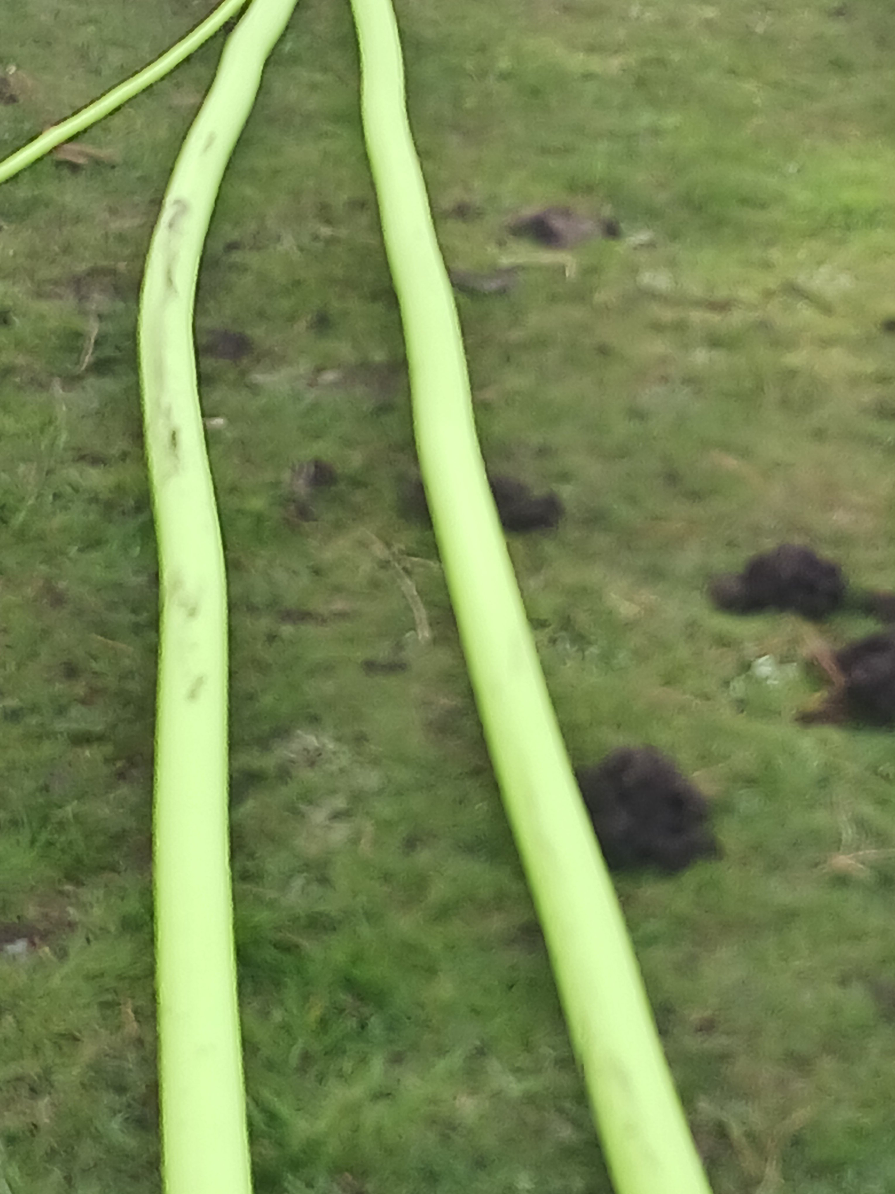

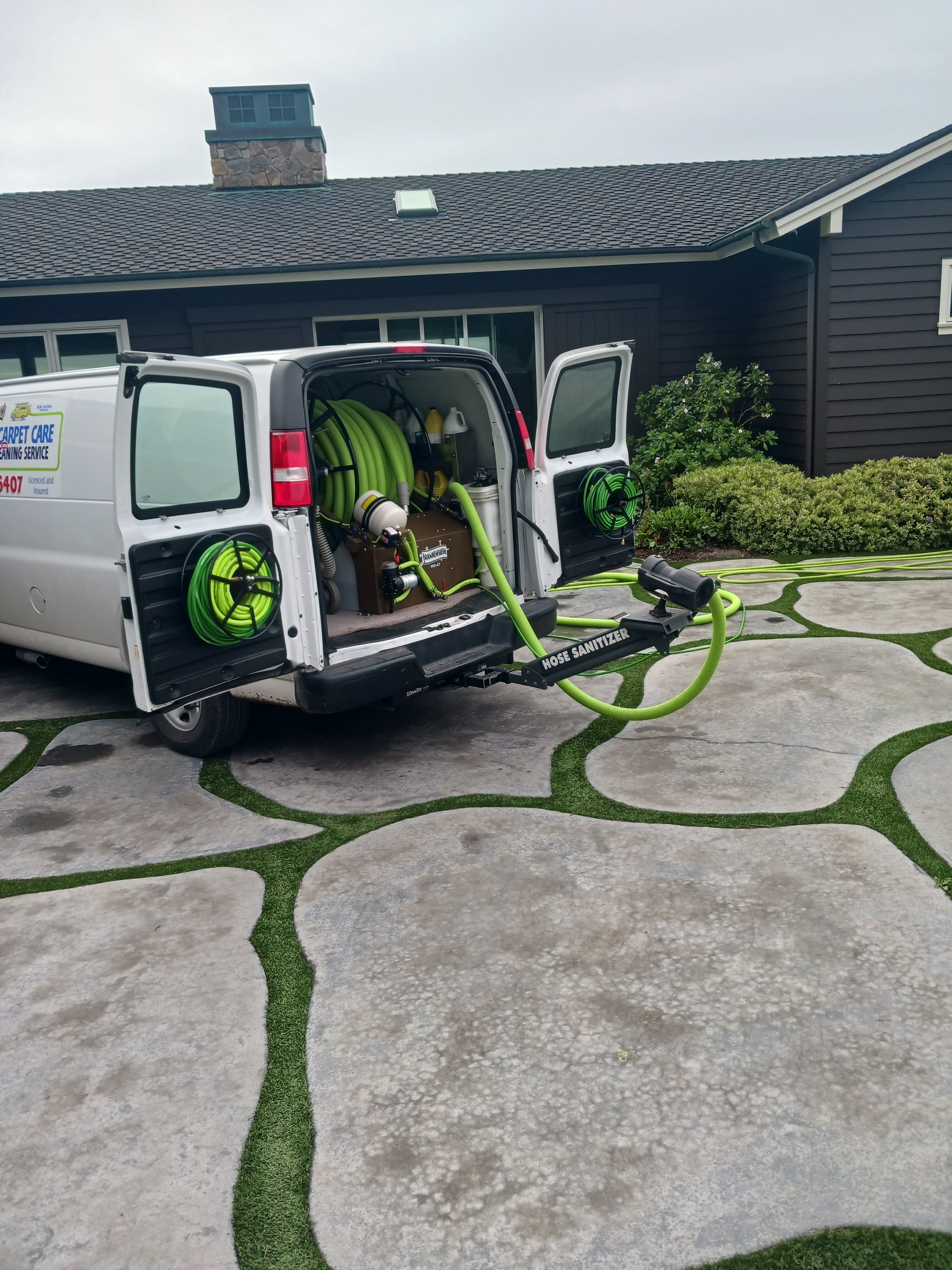

It's days like today that makes me happy i permanently mounted a hose washer on th back of my van! F$#$@kin gophers!!

Thank you, when the hose gets incrusted with dirt like today i have to hand reel it thru really really slow @900 psi to insure it blasts all the dirt from the inner groves but normally i just power reel it in @500psi or so each time and they stay shinning clean😎
