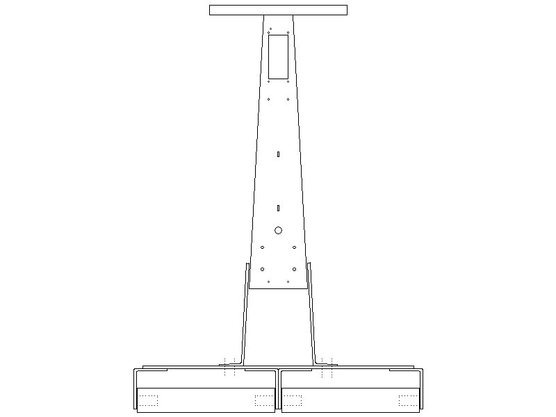

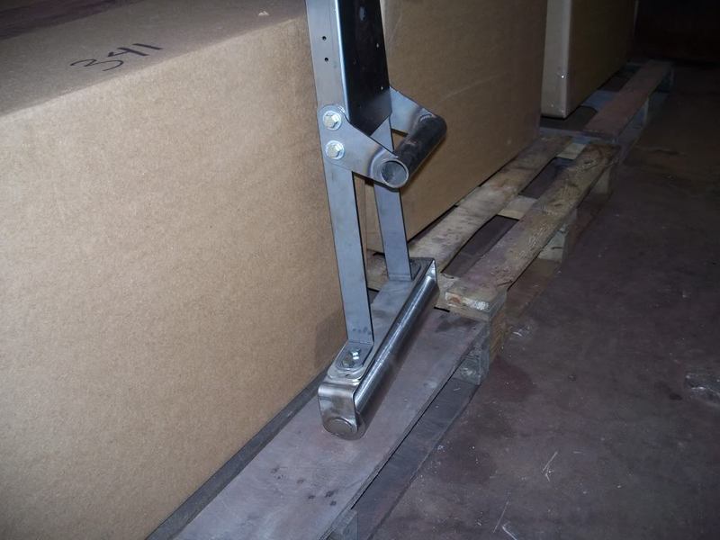

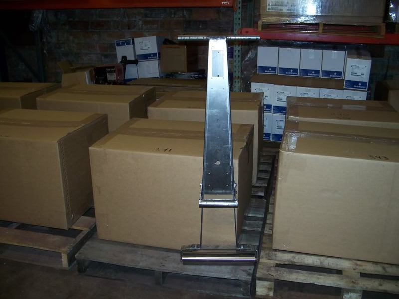

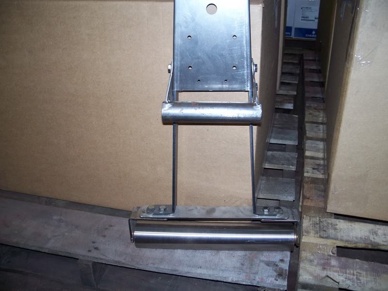

I'm not sure it's tall enought for you. I may need longer struts. Solid stainless steel roller, SS lower bracket, and the top will be powder coated red or forrest green. So what do you think Mr Mikey? Having all the handle parts makes it easy to produce fast. I will cover the switch hole with a plate.

Hello Larry, It is 35 pounds. The roller is solid 316 SS CR and lower bracket is 304 SS plate. The upper I would like to go with a telescoping tube for a long reach. It would help with storage as well. The handle I have on it works well. By the way this is a Rug Pit Roller Squeegee. It is in production now.

If that is a standard pallet the handle only looks to be one foot off the ground. :!:

There are two models. One 14 inches wide (shown) and one 28 inches with 2 14 inch rollers. What about the handle would make it easy to use? And the MasterBlend unit has plastic rollers. The lower handle is to pick up the unit and carry it.
