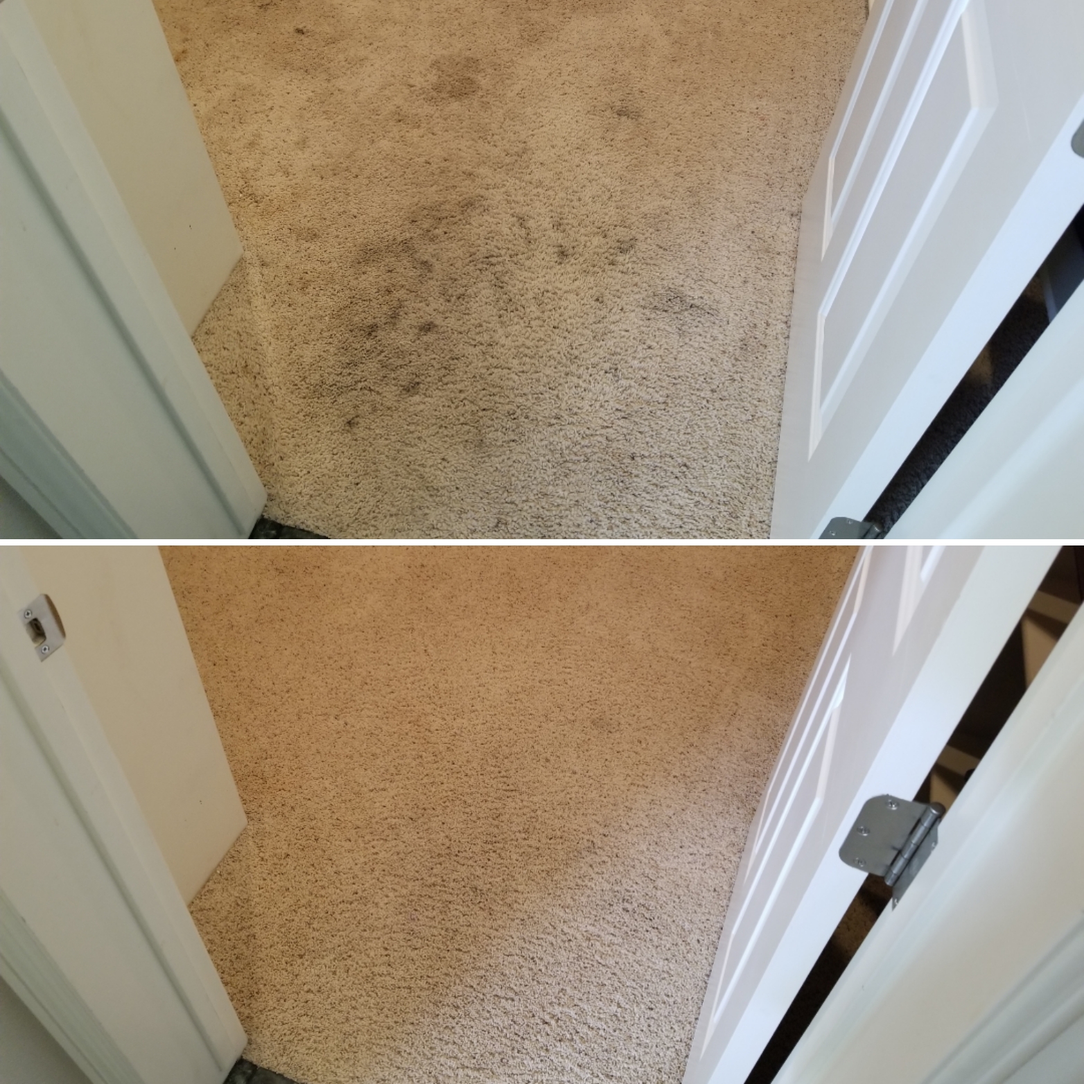

Anything i should know about cleaning black tar heroin staining on wool berber? Its about 2 feet diameter smeared around.

Its also a light beige color, cut berber style. Never cleaned a stain like this and im not sure if its a good idea to do it or not.

Write at least a basic disclaimer ie this is a pre existing condition and I will attempt to remove inline with best industry practice
I'd use a woolsafe enzyme prespray mixed on heavy side with dwell and hopefully it rinses out

Treat it as you would bong water...
Rinse first, as you KNOW they already attempted to clean it up, then get a big bottle of high alcohol hand sanitizer from Walmart in a squirt bottle, apply liberally, extract, repeat as necessary....

Don't agree with Larry. If the product comes from the ground we would always use a tannin spotter first. About the only time it's different is when it's been processed en route e.g. as in grass through a cow.

Aint perfect but client was happy. All with a porty. I probably be faster with a TM.... probably not.

wool being so absorbent it can sometimes pull spots etc inside and they disappear as it drys..
Sometimes it does the opposite
Cant say I've knowingly dealt with it., what did you go with?
I learned that a while back. So i speed dried with my new stealth fan. Till it was bone dry, nothing reappear...for now. I rinse it well with water first. All the tar resin by door, i used prosolve. That released it. And rinse with woolsafe rinse, all fiber rinse. Took 2 or 3 times.
