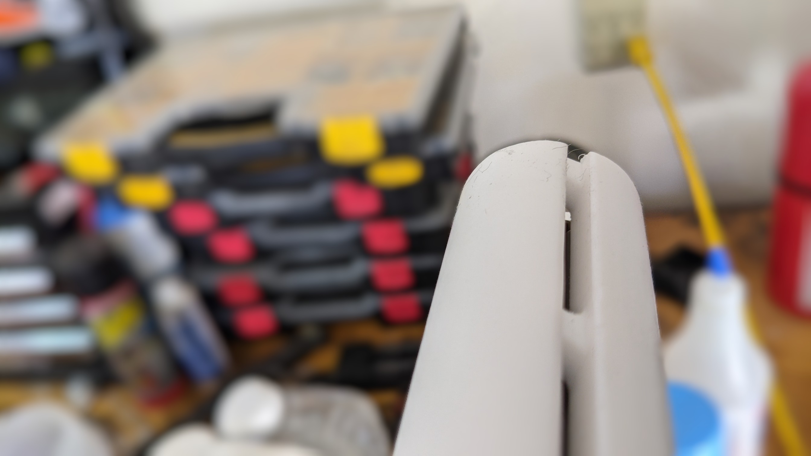

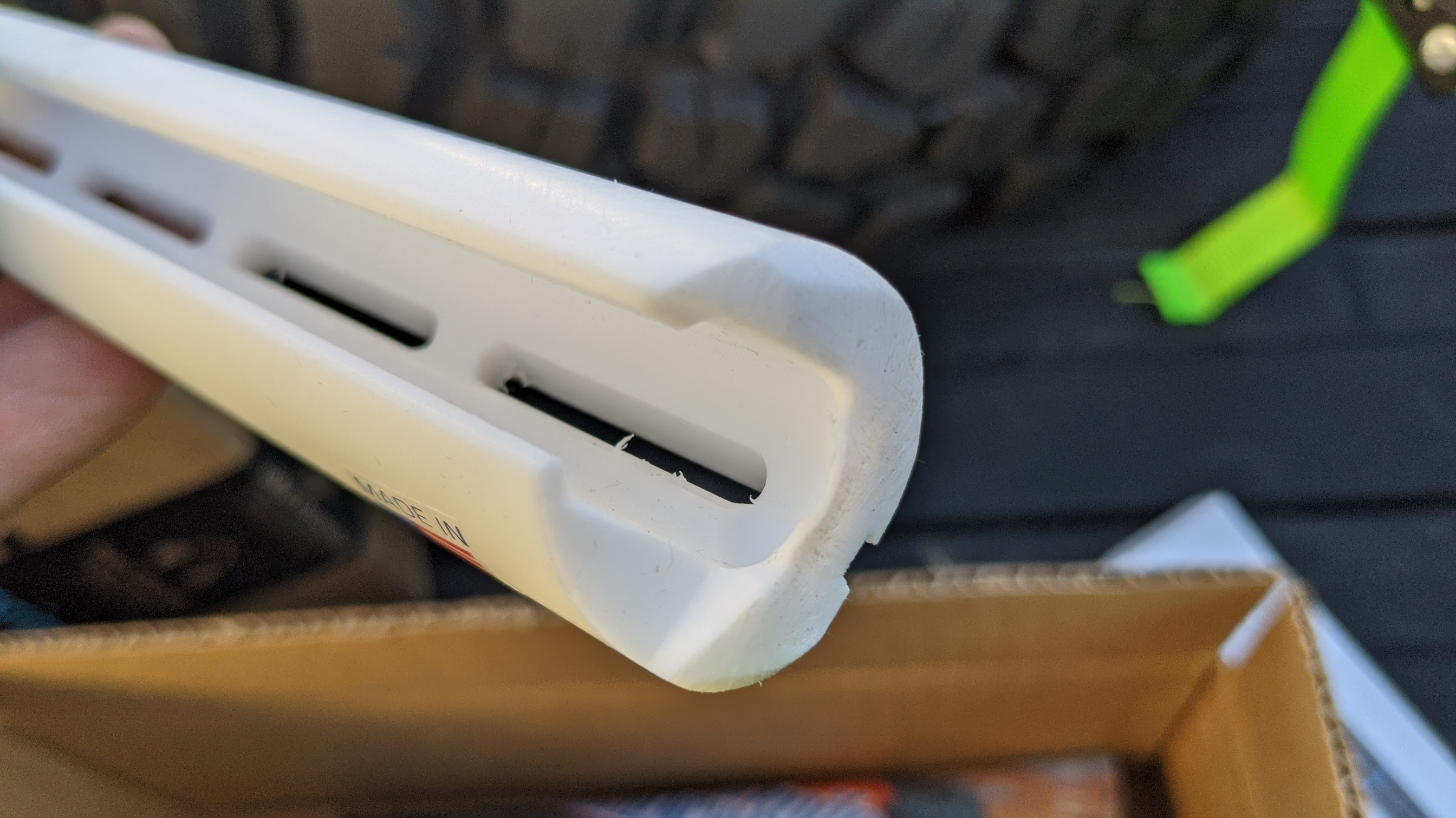

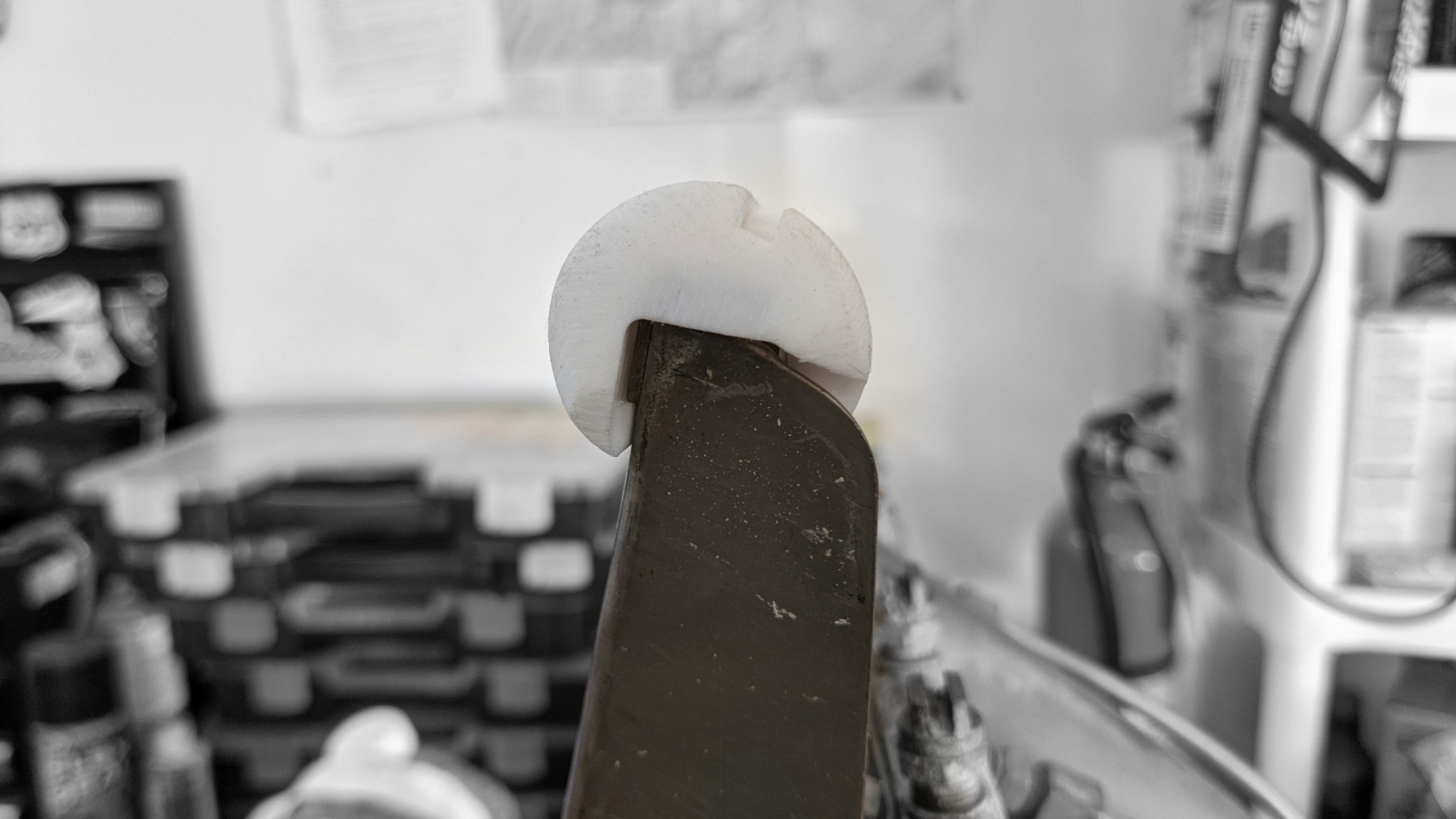

Dear Lisa made the mistake of thinking that the Westpac low-profile 12-in took the same glide as the sapphire ti 12-inch.
we sold tons of them until one 2%r noticed and got back to us telling us the fit wasn't right.
Turns out our fabricator never actually saw the wand to fit it perfectly so I sent him the sapphire 12 and it was completely wrong yet we sold countless of them to carpet cleaners that just pounded them on and never noticed the difference.

Want my address, so you can send me one?
My dry times are really good with the oversized glide.
I’d love a glide that actually fits.

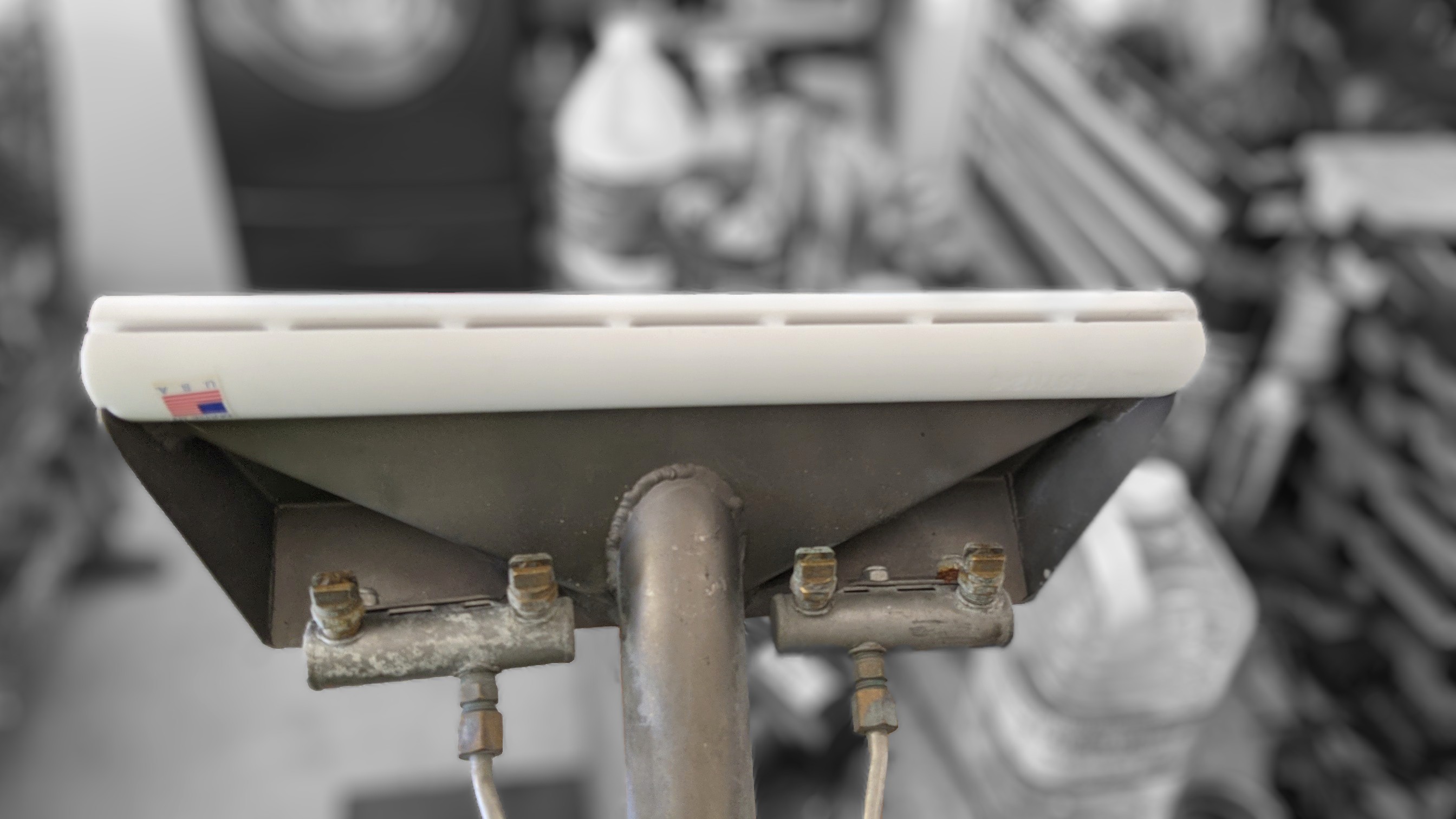

I do, however, like how the stock glide doesn’t move.
Does your glide work like that?
nope, that no slide feature is actually a flaw.
We design our glides to have a sight air leak on the ends to prevent lockdown
A set screw is the better choice to stop side to side play
