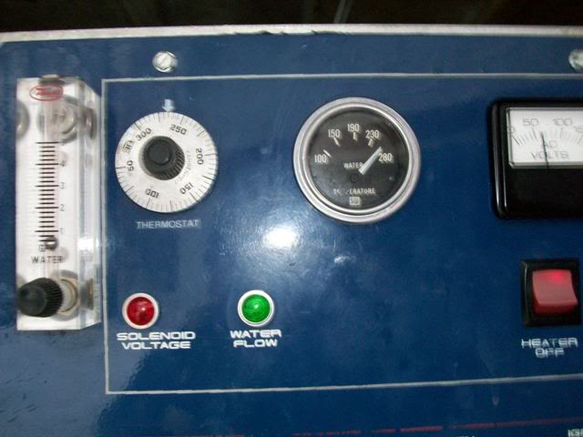

Help me guess where my 80º went.
116,224
Used the Steamway Powermatic 2100 today for just the 2nd time other than warming it up in the parking lot.
First time I used it it was popping sizzling heat in the 250º arena.
Today it would not budge above 170 º.
The burner is firing with every trigger pull.
The Kero tank is full.
The thermostat will shut off the burner up til 150º but from there it stay on as well as as the red solenoid light.
Unit as only 64 hours on it.
I have not messed with anything other than oil changes and a 2.5 conversion.
500 psi with a 04 or 020 wand yields the same results.

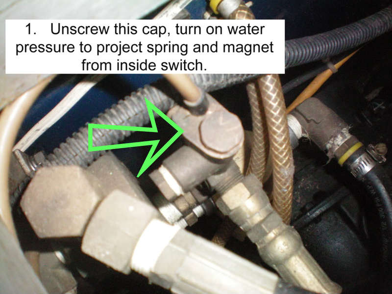

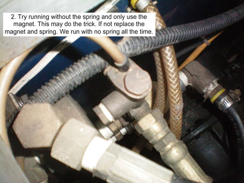

Jayhawk is talking about the brushes in the generator, but that's not your problem since your heater turns on when you pull the trigger
Here is your problem
make that 2 shirts medium and a couple vac tat's for my Jeep.....pleeeeeez 8)
This worked for us now our heat is better than ever
on second thought, it may not be your problem because your heat kicks on but it's still good info and worth the Tat's

IF Al is right, then just change that flow switch to one of these from General Pump. They work flawlessly:
"TMT" FLOW SWITCH
Tri-magnet technology in-line flow switch.
Features:
* Microswitch technology eliminates reed switch
* High pressure in-line flow switch
* Activates with as little as .5gpm flow
* Can be mounted in any position
Specifications:
* 5000 PSI operating pressure
* 12 GPM Maximum
* 180°F maximum temperature
* 48", 18 awg lead length
* 3/8" FPT inlet
* 3/8" FPT discharge
* GP Number - 100934

do your self a favor and buy the direct replacement after market flow switch from Jeff at Steamway Express in Zoarville Oh.
Ever after I pitched the spring in the stock FW, i still had intermittent issues with low flow tools.
The electronic FS Jeff sells cured ALL those issues for GOOD.
It's a direct replacement, nothing to do but remove the old one and THROW IT AWAY, then put the new one in.
final note, Mike, if troubleshooting the "easy stuff" first doesn't cure the ills, call Jeff at SW Express before you pull the burner.
He's my "go to" guy when I need advise/guidance. Great guy and straight shooter
Buy the flow switch too....cause you WILL have problems with the stock FS sooner or later.....guaranteed

Damian must of found the red rocker "on-off" switch of the front panel...
Yo vEEgs, it's the little red thingie on the right in this pic
Mash on the top part of it when you want heat.
mash on the bottom part when you want to stop
