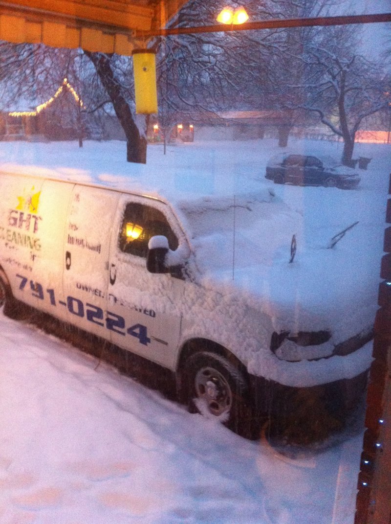

Surly Jimmy has frozen his make believe Cleanco out there on the plains...
