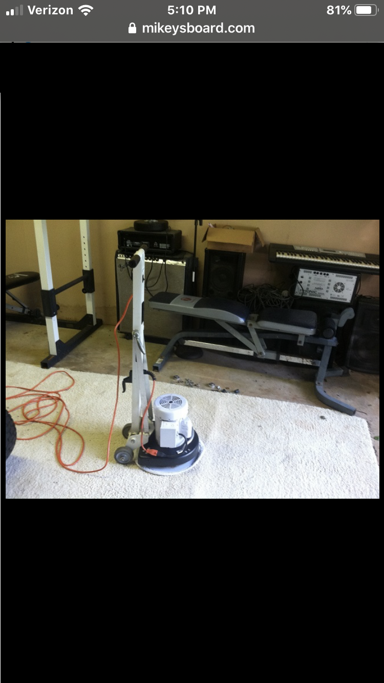

1st step of cleaning is always bulk removal of soiling and contaminants not magic fufu juice..
however, this companies products have interested me for awhile
