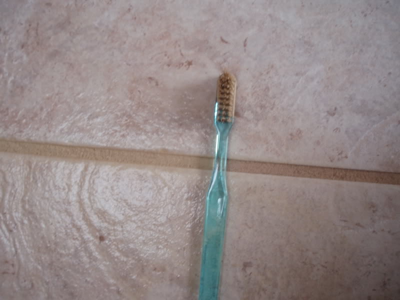

I didn't realise that you could order color from grout colors. I've got tons of samples of those in our store, tech, custom, maipei, and laticrete. It looks like it's easy enough...squirt a bead....smear it in with a tooth brush and wipe excess with a towel.
Only agrivating thing seems that you have to clean it first.....seems you're supposed to do it with acid first???

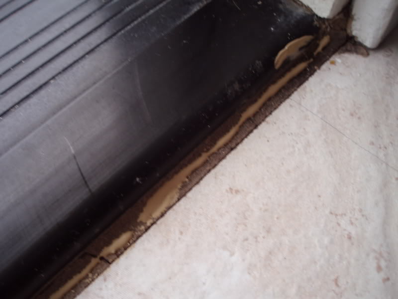

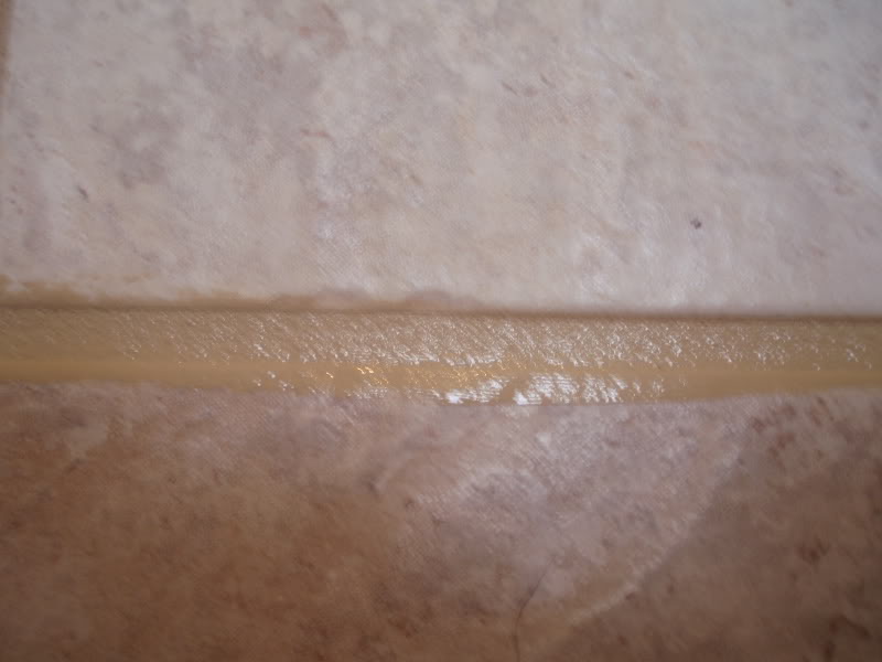

Initially the applicator brush is not easy - but when you get use to it there is nothing better or quicker. We have two methods of application:
Option 1) Beginners Version - apply a bead with the tip / yorker top and then spread with the brush
Option 2) Advanced Version with applicator brush

We put out more production with the beginners version then the advanced version. It's for beginners and it's faster.

TOG sealers do not say you have to acid wash first. Many TOG users don't use acid during the preporatory (cleaning as you call it) steps. I can't speak for other companies but this is straight of the TOG website at http://www.thisoldgrout.com/stainsealer:
STEP 1. Grout must be clean and dry. New grout is ready for stain/sealing 10 days after installation.
STEP 2. Apply a small bead of stain/sealer to the grout joint.
STEP 3. With a toothbrush or similar applicator, brush product into grout joint with a scrubbing motion.
STEP 4. Using a damp (not wet) terry cloth towel, wipe excess product from tile with a light wiping motion.

Are you talking about the tooth brush to color seal. You can replace them every time if you like 1-2 bucks for a toothbrush. I think you can afford it making a buck a ft to color seal. Although they do rinse good and you probably could use them again.
