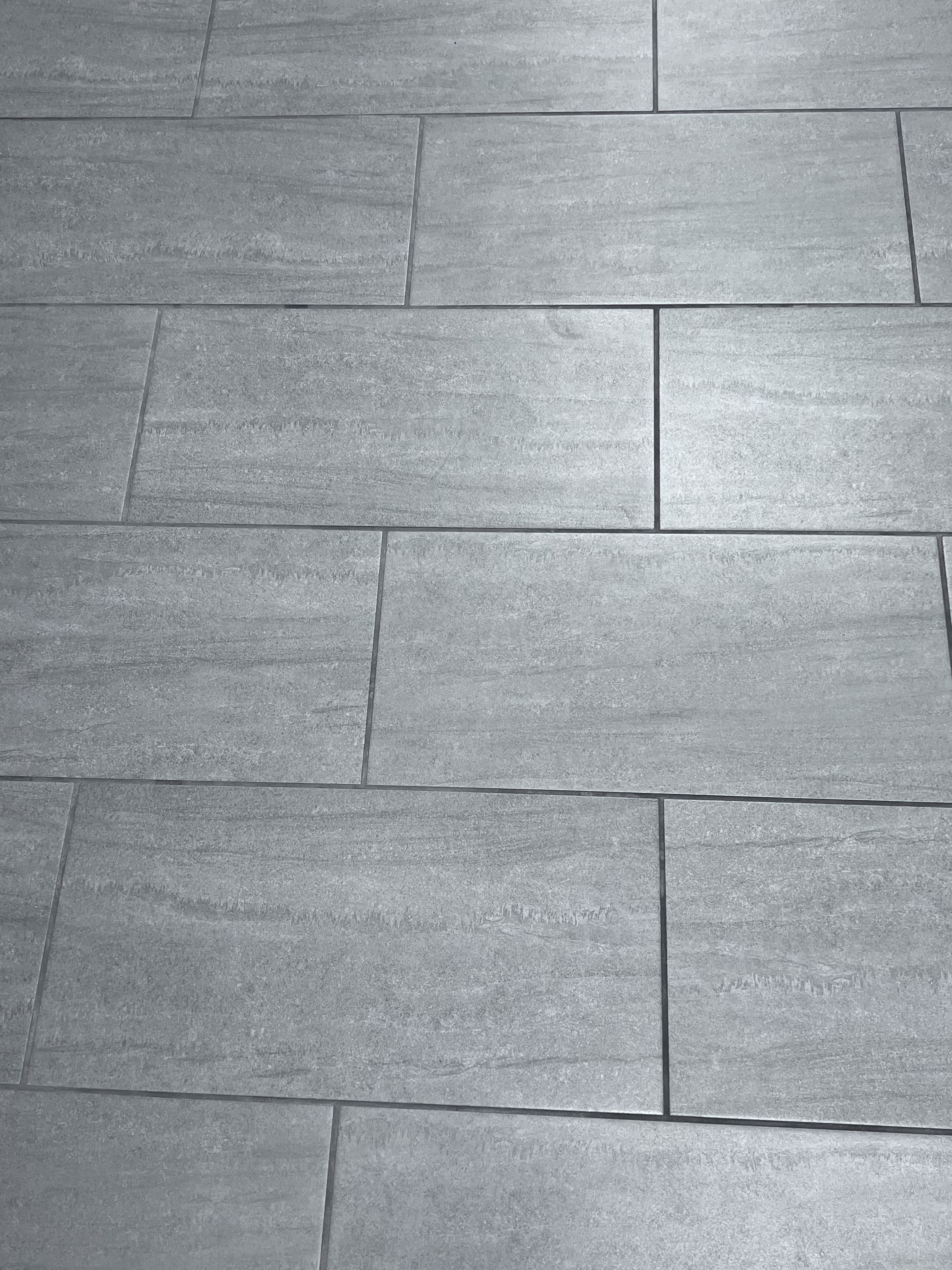

I have a large commercial account that has about 100 people a day walking on its porcelain tiles each time we clean it I am never happy with the results
Grout starts off black and is suppose to be light grey it cleans up well but still shows dark in some areas
We deep cleaned with tsunami and rinse then went over problem areas with a ph 2 acid
Still some areas dry dark and some light
What’s your thoughts

certainly possible..
can we assume that you have returned 24 hours plus or later to see it truly dry?
Pics?
I waited 12 hours still looks wet but tomorrow will be 24 in most areas... I had my guys touch everything up today that looked bad and tomorrow I am going myself with all fiber rinse and your green glide to do a 400 psi rinse after I do corners and edges that my guys missed.

Then there’s a VERY GOOD CHANCE they matched the new grout color with the old dirty grout. Once you clean it, the difference is visible.
Idiots never think of cleaning the grout before matching the color.
yep, I did a service station where they'd had a battery leak eat out the grout. They regrouted with black to match the dirty grey

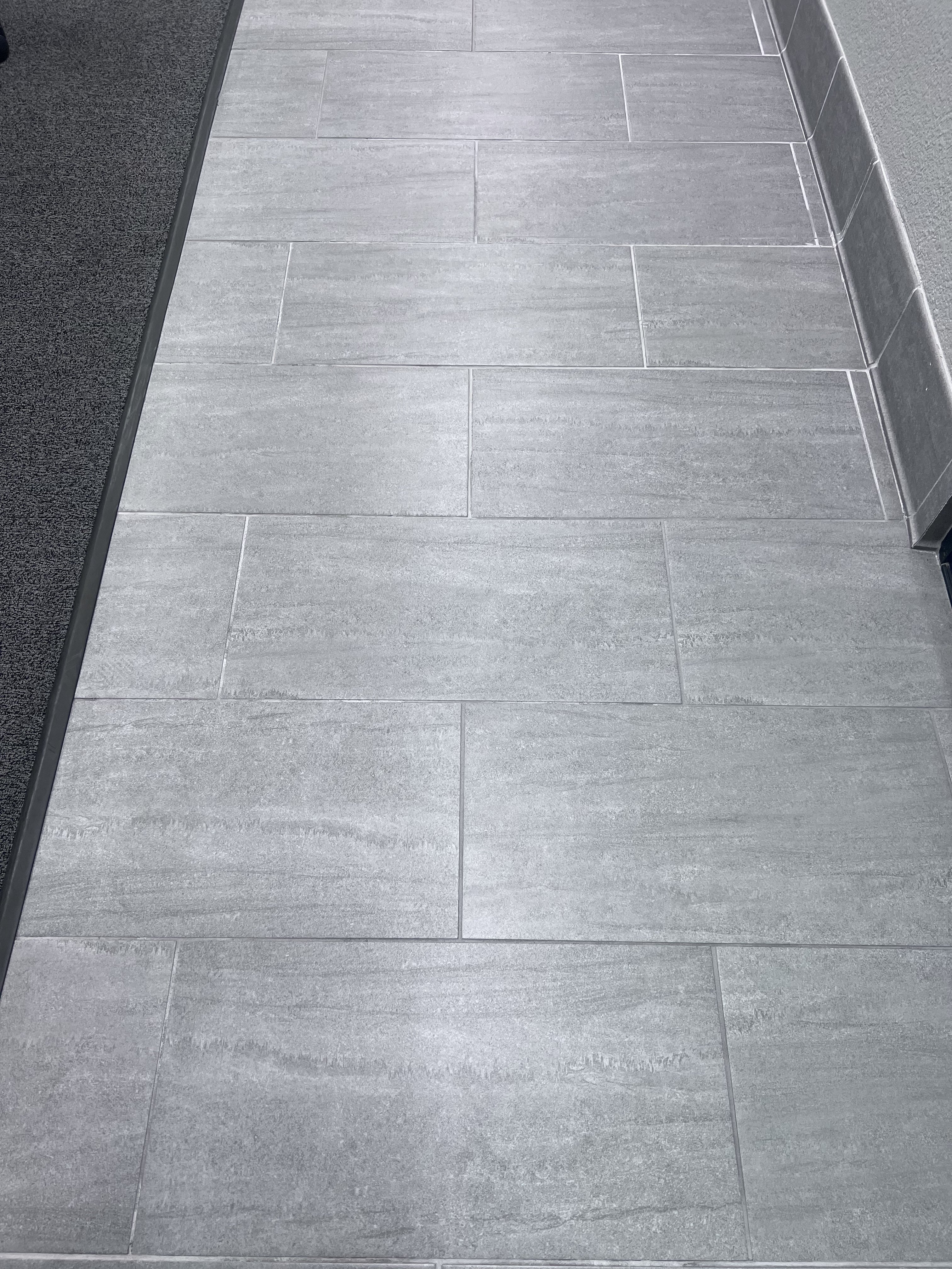

The senond picture shows the areas that look wet
002879D1-6EC3-40C4-AFB3-B99598D57143.jpeg AF9AC4B6-2A20-4F52-B9F6-FA991EA079B6.jpeg
117,374
did you use a spinner?
I would use one at 1200 psi nice and slow like...
but it's probably just stained.
replace or colorseal.
