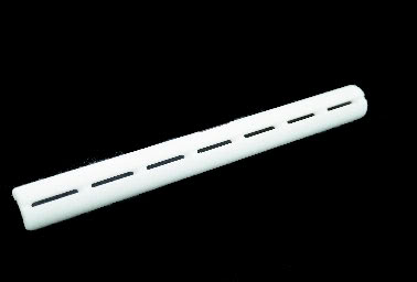

I don't know who makes this one but it is similar to my slotted(I have the hybrid as well) Point out where there is more cleaning area than an unglided wand floorguy. I see 20-30 or % of that covered. Now I look at it it is probably over 50%
I have Crowley's address if we need to call in a hit.
It needs to large caliber though, that dude is going to as hard to bring down as a rhino. :wink:
truckmount girl
1800greenglides
8,880
Sun City, CA
Lisa Smith
Just a note: Glides Do Not increase agitation. You always lose agitation with a glide. More so with a hole, less so with a slot. However that is generally easily compensated for by the positive qualities of a glide.
