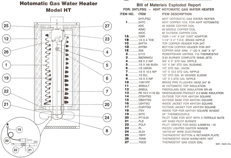

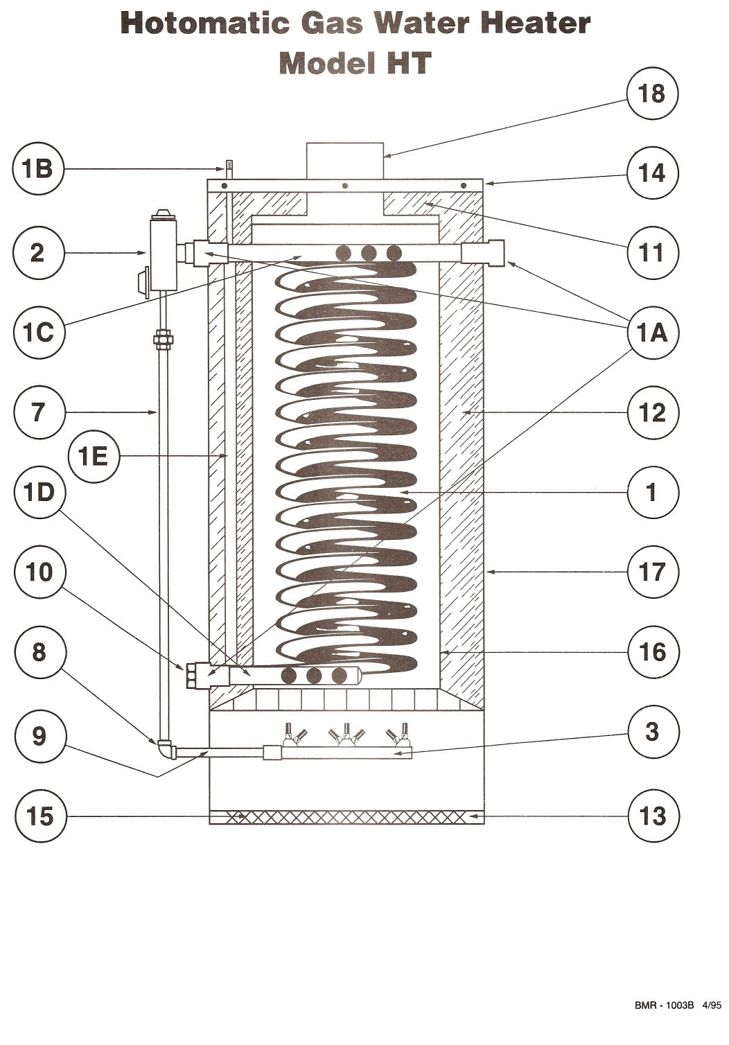

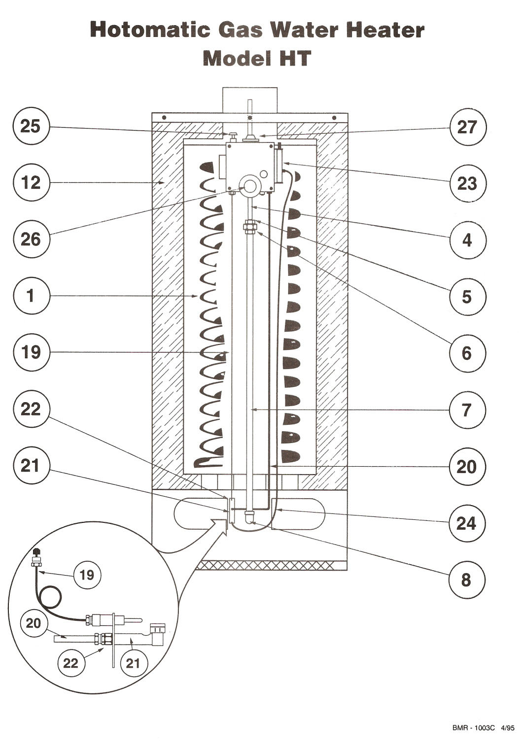

As I am having difficulty finding a supplier on-line, does anyone know who sells these?
We are looking for size 68 (1/32")orifice for a LG2HT.
I'm not positive on this so maybe give Judson/Cobb/Little Giant a ring
but
The parts diagram list the 2ht as having #640 burner jets...which also get listed as 64
Cobb as well as many other places, like restaurant stores, have them listed for sale
