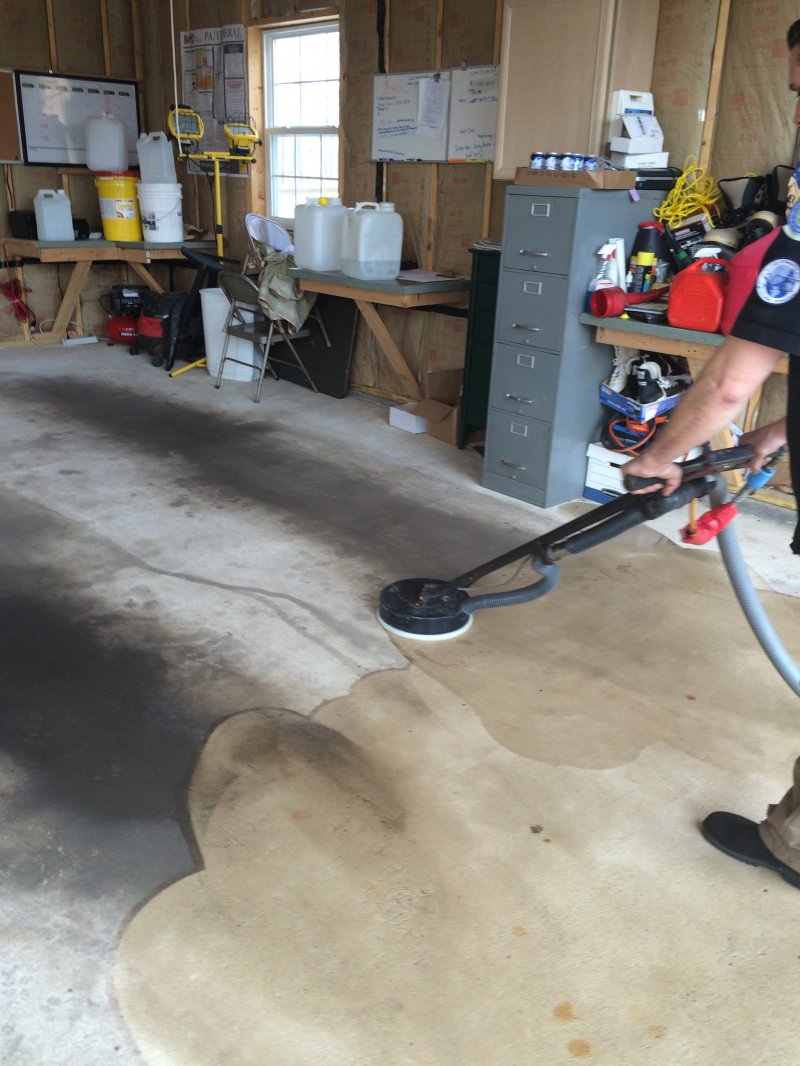

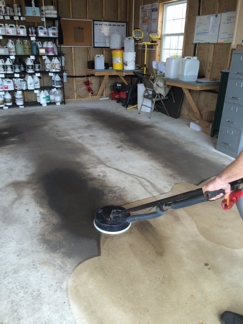

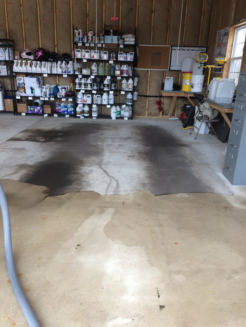

The salt and dirt from the roads are leaving some serious problems on garage floors. Anyone offering garage floor cleaning? Price by the sq. ft. or by the bay?
We are going to offer this as a special/promo. Will will promote on our Facebook page, but will ask every home owner if they want is to do it while we are there and offer a good rate to do it as an add on. We are already there, and won't use any product, just water.
Here is a video and some photos of us doing our shop today.

No products used, just water. Used the turbo/spinner attached to truck mount. I'll have to check with John about the water temp and pressure and get back to you.

And it got that oil out of the concrete with NO chemicals?
Believe it or not it's not oil. That is all the dirt and road salt that stuck to the wheels/underside of the car and then melted and pooled on the floor.
We aren't opposed to using products, but we just hit this with water to see what kind of results we could get with just water. If we want to offer this as a quick add on at a decent price, we can just clean with water to remove the salt and soil (only). If there clients have oil etc that they want us to get more aggressive with, then we can upsell a deeper cleaning.
