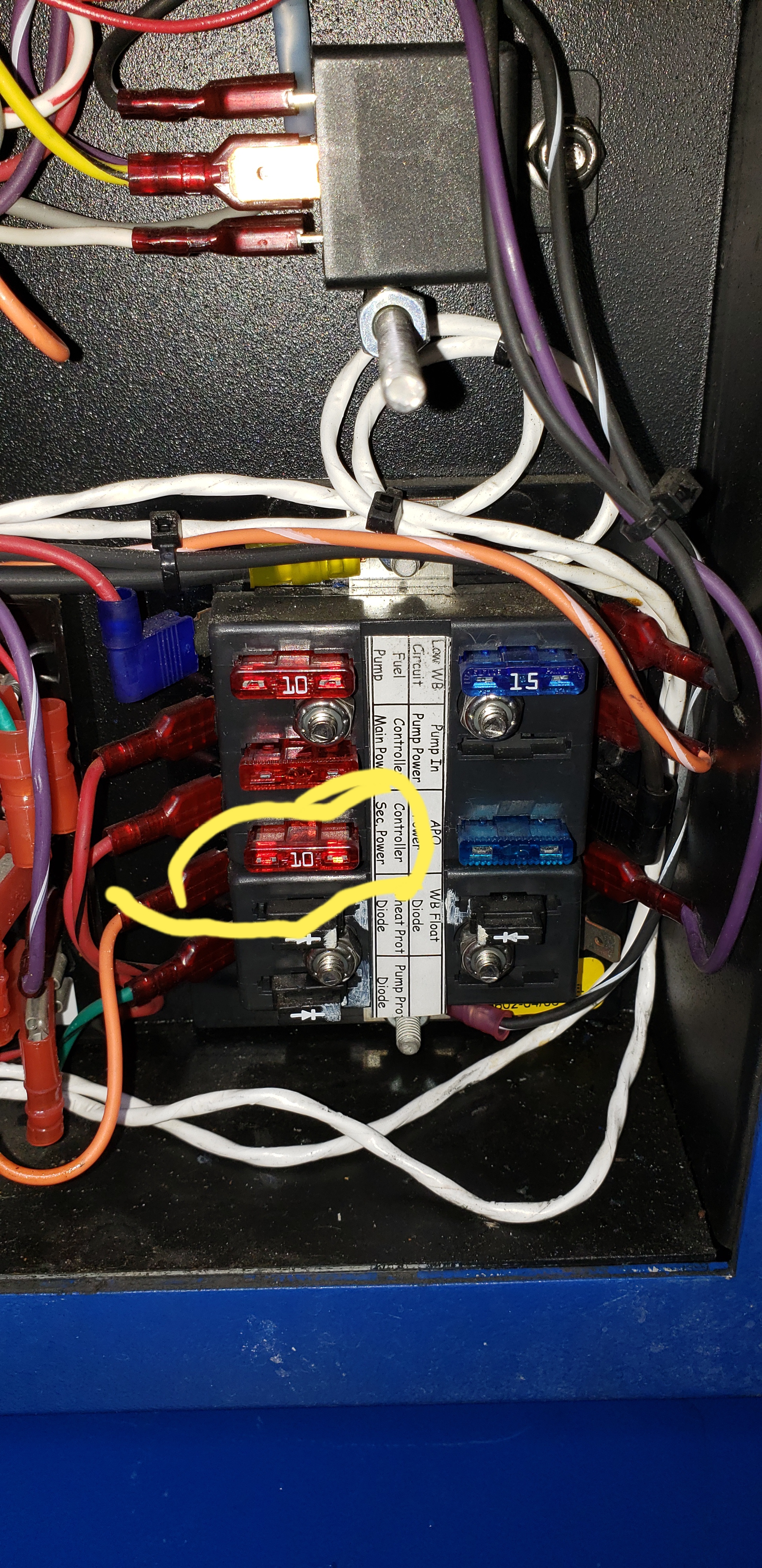

Does anyone know what the 10 amp fuse for controller sec. power ,does on my Boxxer 427? I randomly checked it and it was blown.

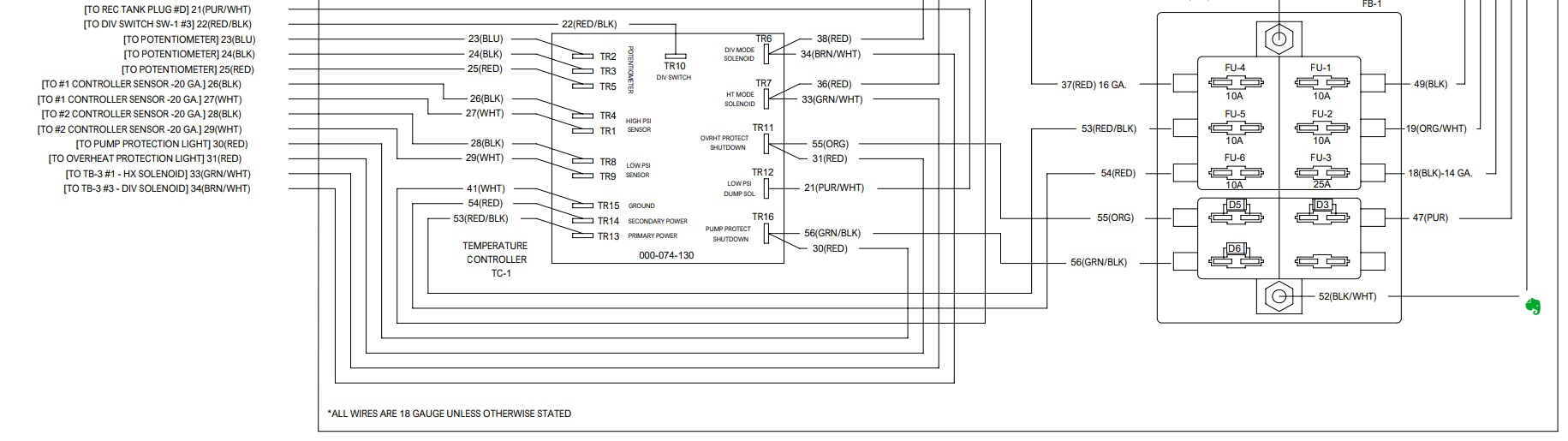

I'm not sure because I don't have the temp controller schematic but it feeds the temp controller (so does primary)......I assume a second bus and associated features

are you having heat issues? Is the fuse blowing?
again not sure because I don't know exactly what it (secondary) feeds on the control board but I would assume it could since most functions of the controller are heat related

Thanks Fred! My heat has been a lower lately, but I thought it was just due to cold weather. Not sure how long it's been blown? I'll try and find the wiring schematics for my unit so I can find what the secondary power does.
The manual doesn't break it down that far
Finding a manual for that specific controller or possibly a visual inspection may tell
