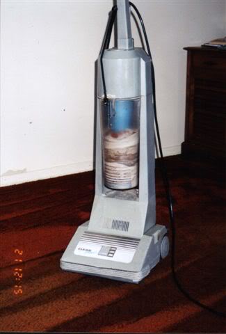

OK, so it is nice that you pre-vac. Personally, I pre-vac with a powerhead attached to the TM, so I can send the dry soil on a 100 MPH joyride out the door and into the truck parked away from their home while at the same time producing a negative airflow that will draw clean, fresh, outside air into the home.
But I wouldn't say that you are polluting someones home by dragging in your DIRTY ASS vacuum cleaner into their house, spreading the germs, dust mites, bacteria, mold, and maybe some deadly strain of MONKEY HERPES you picked up from the last house that you vacuumed with that POS.
Or maybe I would.... :twisted:
Is that a special service you provide? Isn't listed on your website.
Oh, might want to change the wording on your carpet sanitizing treatment. Its impossible to "sanitize" a carpet. Thats been a topic of discussion periodically. We can "apply" a sanitizer/disinfectant but we cannot sanitize/disinfect.
If you don't have a clear tube to see what's going on that 100mph joy ride, you'll miss a lot of it. Its no better than a bag vac, actually worse for you, its burning your profit out in the driveway.
AS for my dirty machine, I use it because it removes the soil, and it does that exceptionally well. Some how I think all the hype over what I "might" be bringing in is like the mold hype from years ago.

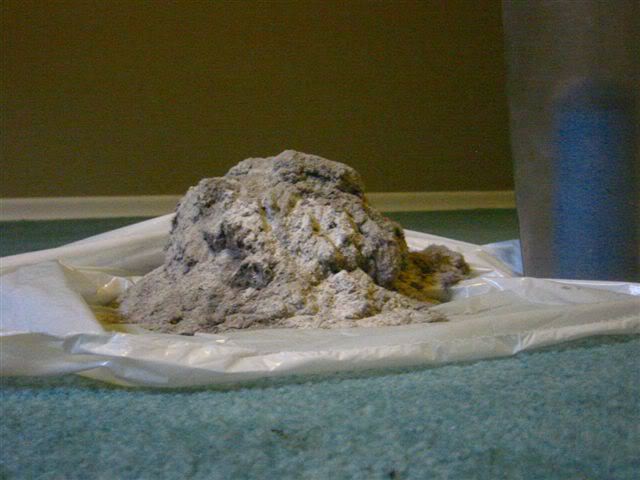

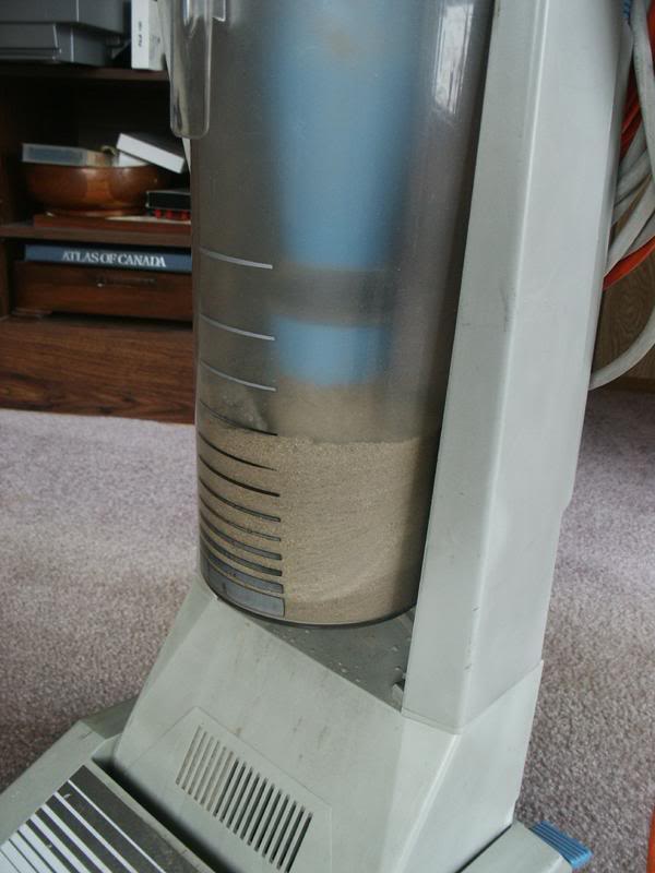

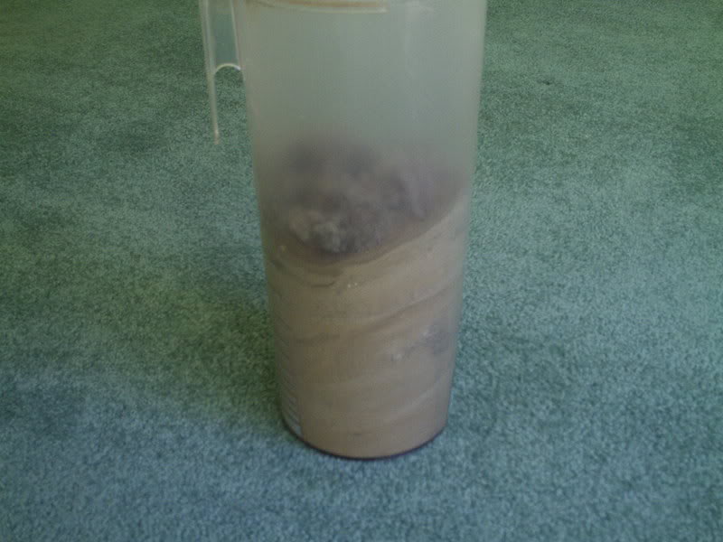

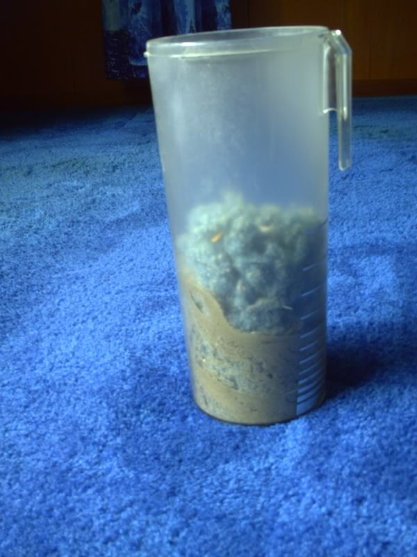

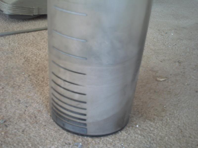

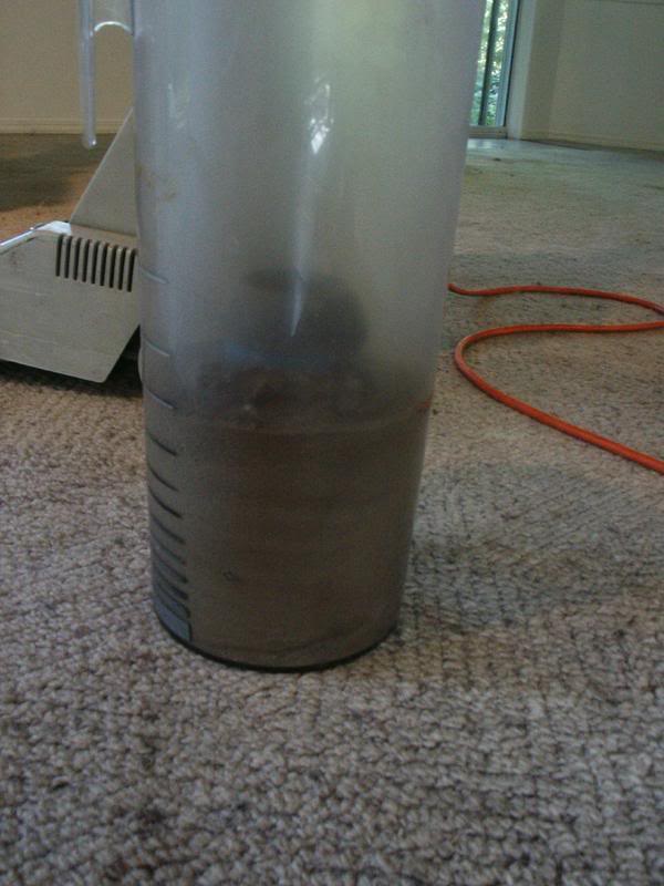

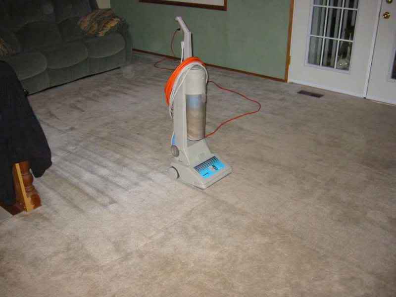

Kevin P said:
Ron,that person or persons you get that crap out of are the ones that Do Not vacuum enough period.You can give a guy the best equipment there is and still do a crap job.So put blame where it belongs,to lazy people not vacuuming.Oh and teach you're clients the importance of frequentcy or you are doing them a disservice.
Most of those pics are from well kept homes, not trashed places, where the client has vacuumed before I arrived.
Keep bringing the excuses, haven't heard anything new yet.
If you don't want to prevac, just acknowledge that you are not removing all the soil that you could. When you've finished and the job looks great, you're only guessing that you've removed the soil.

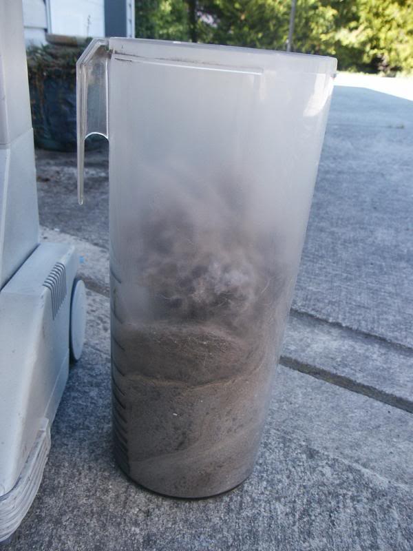

if im not removing soil by hwe then how in hell does that water get so so dirty???? :? :?
Ron Werner
8,726
Ron Werner
Dry vacuuming removes the soil OUT OF the carpet, accounting for, hopefully as much as 80% of the soil. We'll never achieve that, but its the goal.
Now that the dry particulate is removed, Steam Cleaning will remove the soil that is ON the carpet fibres, the remaining 20%
