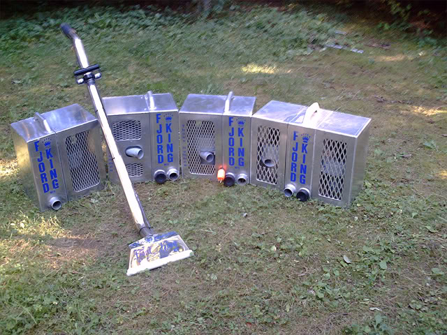

Bjorn
2,450
by the time your 4 to the door 5 to the floor 8 to the ceiling
you could have just used a vac booster and be done with it bringing another vacuum inline to overcome drag is not a drag
