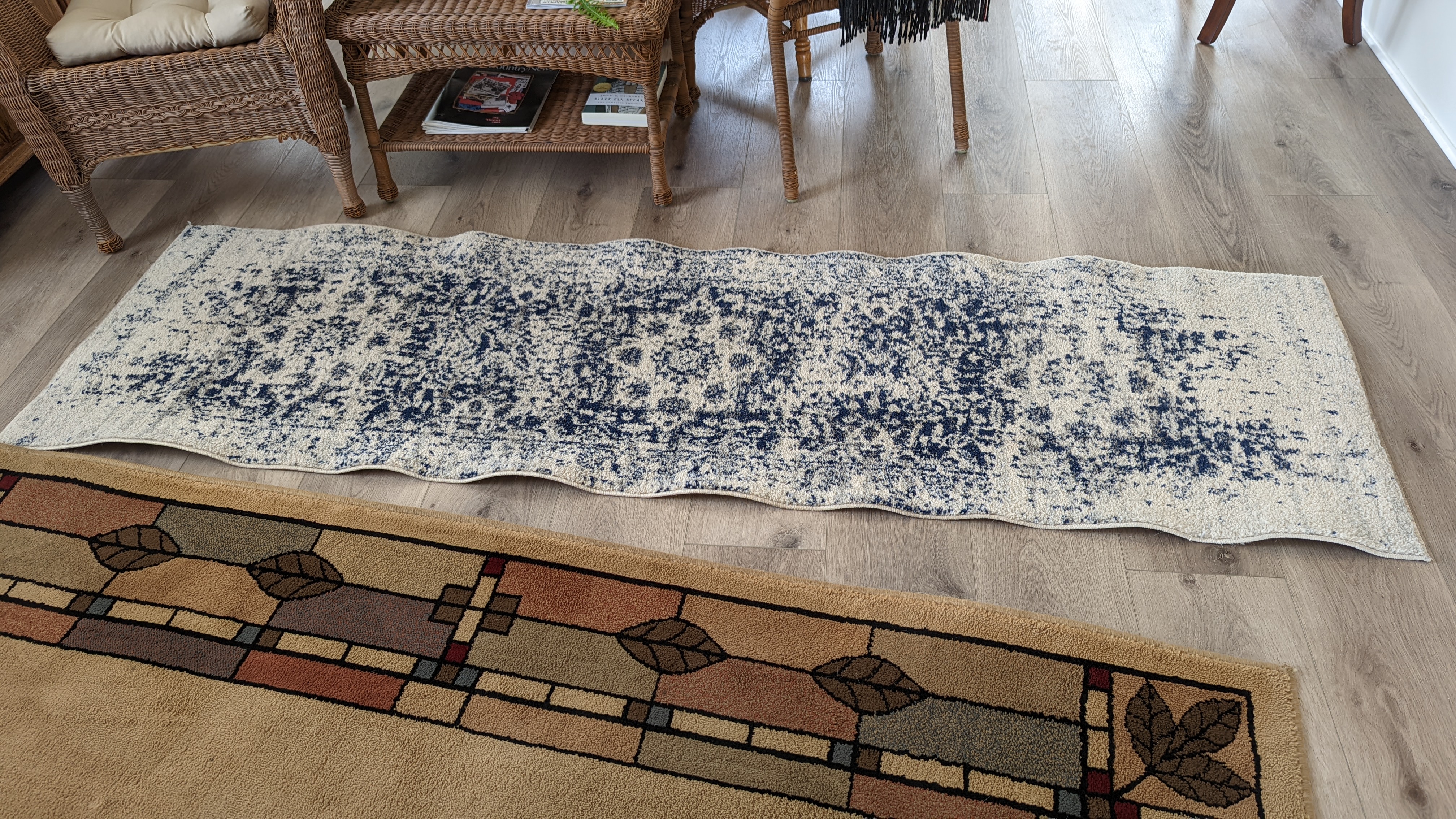

Its not the cleaner’s fault the customer bought cheap ass rugs.
Im not convinced that curling is a sign of cheapness in synthetic rugs.
Do the manufacturers knowingly use moisture sensitive bindings or other materials to save money?
Are non sensitive really more costly?
14,181
Tell me how you prevent curling?
Or do you just fix it prior to returning?

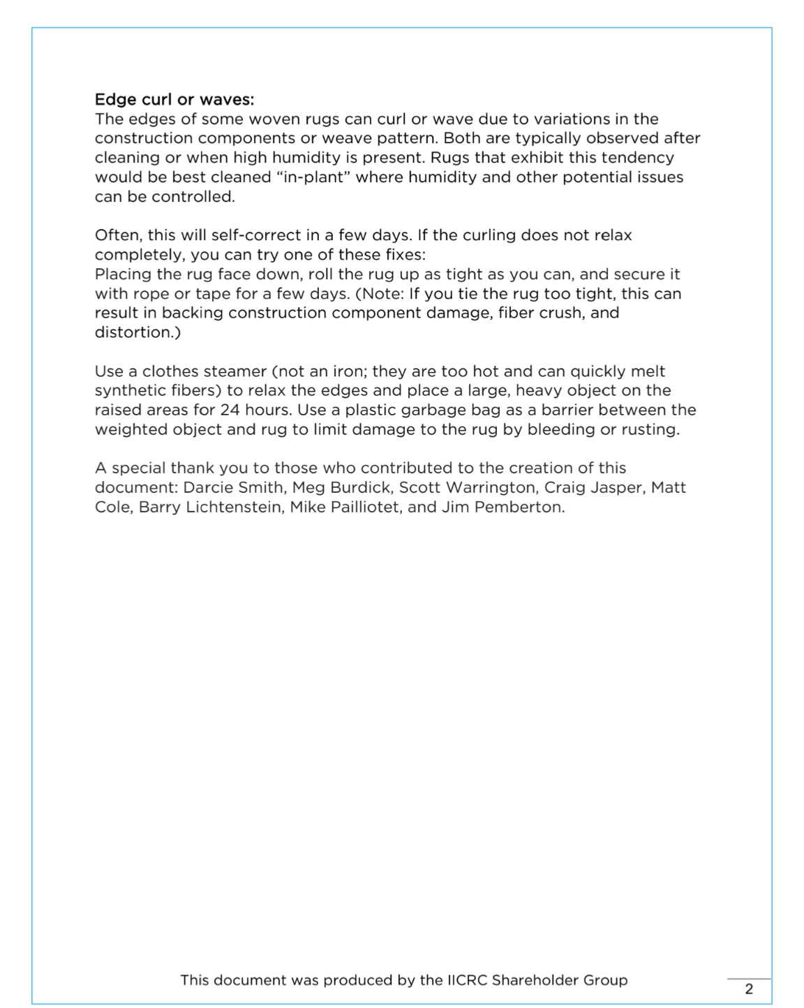

You don’t prevent it. Just tell the customer there’s a natural fiber weaved in the backing that shrinks when wet and will relax when dry. I’ve cleaned hundreds of those repeatedly and they always relax.
There’s nothing to fix.

We may have polypropylene rugs with a cotton foundation curl a little but during our drying process, the weight of the rug hanging over the pole pulls it straight as it dries. I have never had permanent curling on those rugs.

They usually flaten out as they dry. Just let the customer know before you leave that they should level out as they dry.
