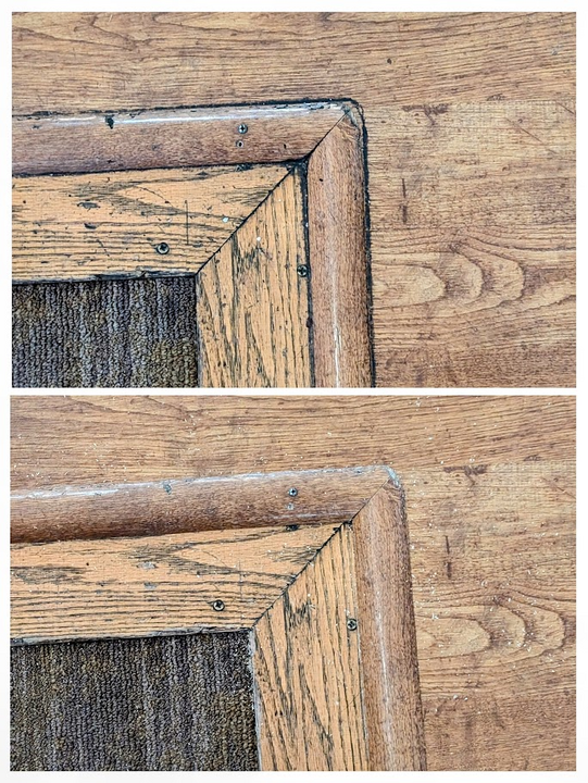

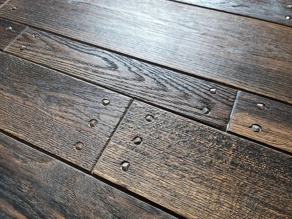

Ever seen a wood floor like this?

How would you clean?
Dry compound?
116,002
Are the nails functional or ornamental?
Either way...
Dust
Apply neutral to 200' at a time
Agitation
100-200 PSI soft or 4-5 pH rinse via hard surface wand
Fans
14,102
Low pressure is key
You don’t want to inject any water into crevices that can’t be extracted.
27,867
That's look it might be a soft wood floor. Pine instead of oak or something similar. Easy on the water. It will raise the grain and potentially cause swelling.
11,304
California
Either way...
Dust
Agitation
Fans
Ornamental I believe.
No pad? Or shake and shine?
