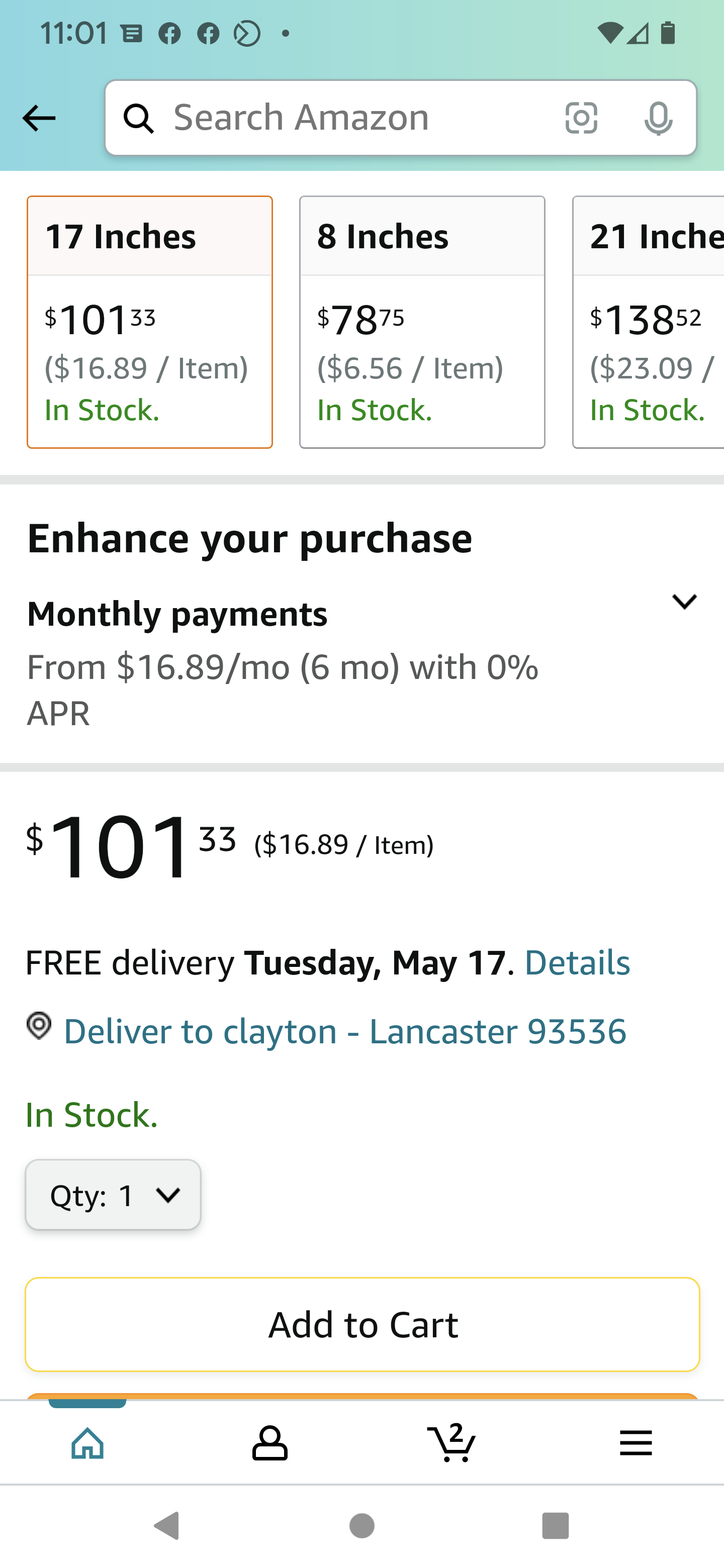

That says they are unavailable. I tried to order from Excellent Supply, but when I was at checkout, estimated shipping was àround $500.00 usd.

9,767
Amazon ad say not available if you expand it
They seem to be back in stock.
I was able to add it too cart
It goes based on your address.. 48 states it'll send.. Hawaii unavailable.. If I use a friend's address in Las Vegas, it'll sell and ship..
I'm sure you being in Canada is the real issue.. When I search for things, a lot says unavailable but if it's a 48 state address, soo much more options show up.. It is what it is..
