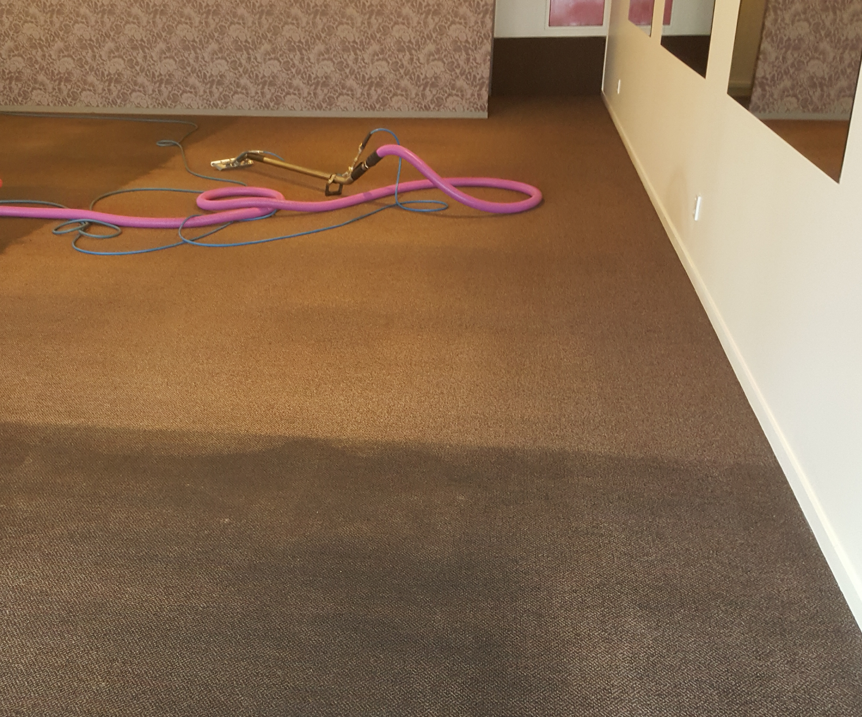

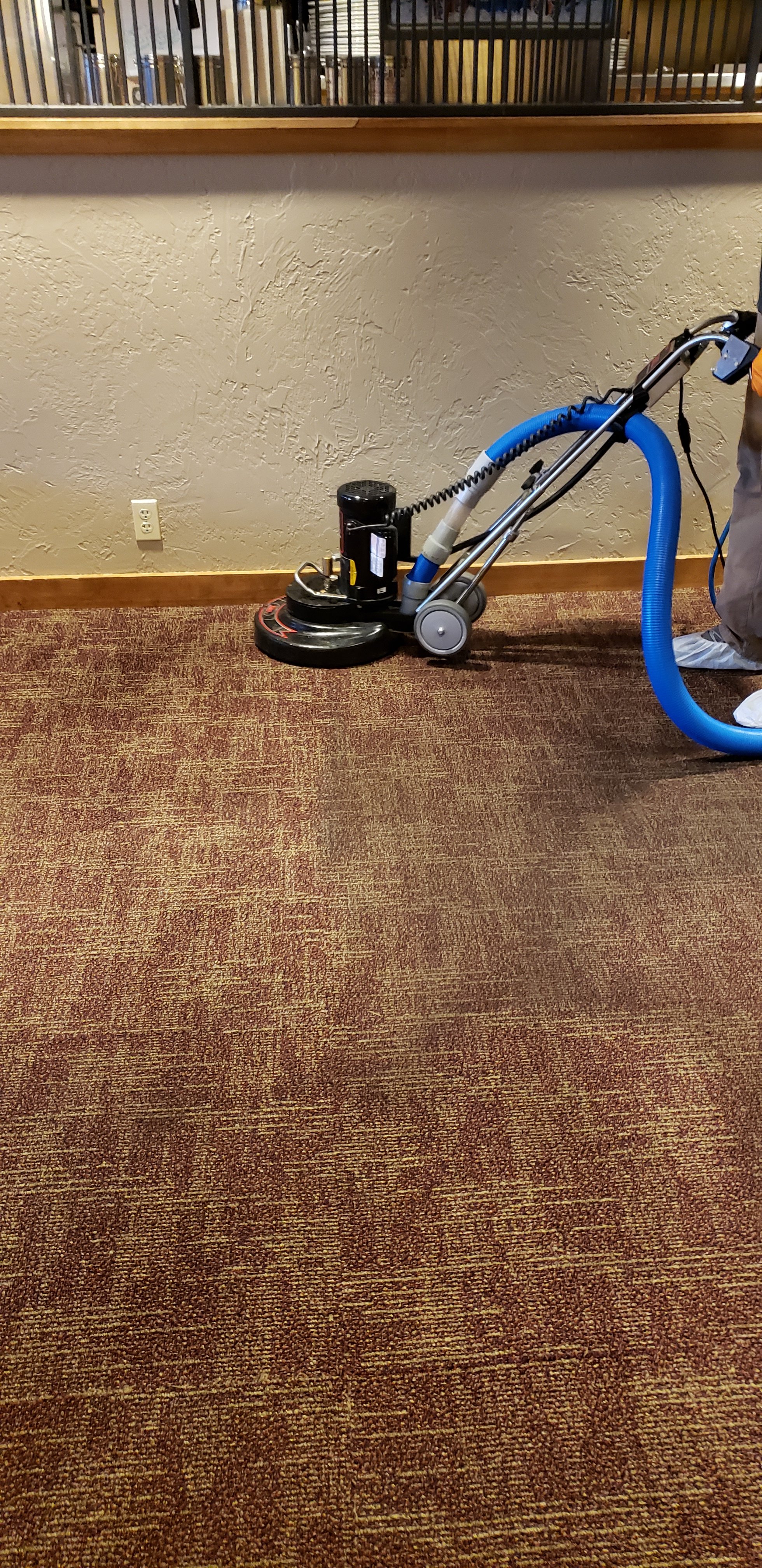

We started the restaurant today. We presprayed with Prochem Ultrapac Extreme, scrubbed with a red pad and extracted with the 360xl. I will encap it tomorrow with a bonnet. We tested a spot with encap first, then HWE and it cleaned up nice, but it would have taken a ton of bonnets. I'll get the same result with post encap, using less bonnets and I won't be rinsing the encapsulation away. Thanks for everyone's input!20191027_121256.jpg
