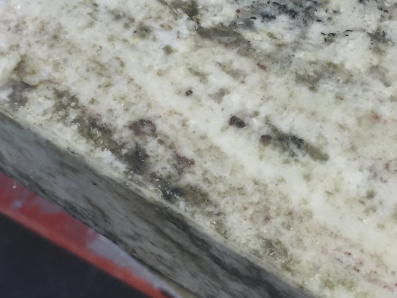

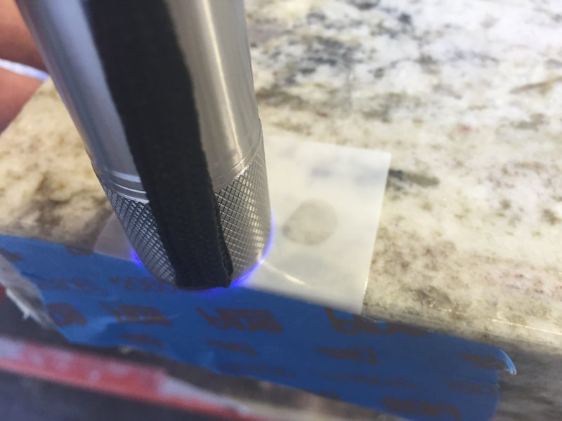

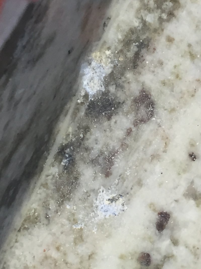

• FillaChip - this is a UV cured glue kit for filling chips in granite, quartzite and other hard materials. It's very fast and easy. it cures in 45 seconds and polishes to blend in with the stone.
good for loose or missing joint fill to I presume?

It can be used for that, but I would recommend an epoxy. The FillaChip is designed more for cosmetic repairs on the face.
Here is FillaChip used on a granite top. Some shaved ape did the job, proving it is nearly Coastie..
I mean a monkey proof process.
