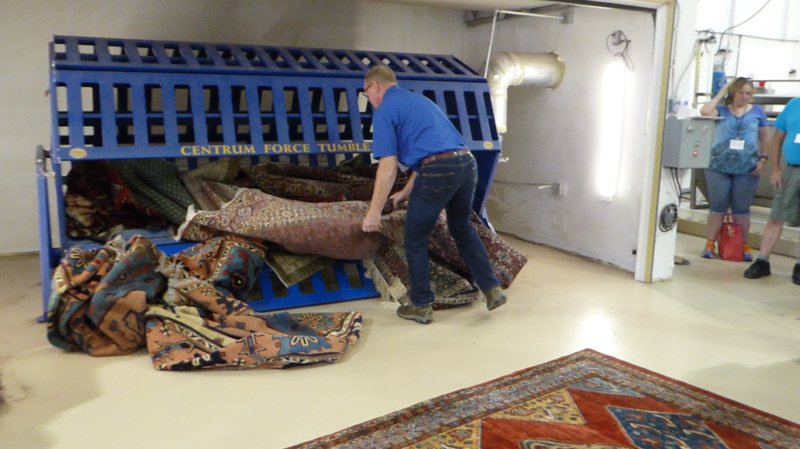

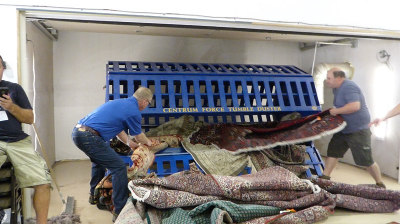

A Tumble Duster is a "Duster" for the sake of this discussion as noted by the previous comments. There are small push-pull strap dusters and larger automated 14, 16, and 19 foot strap dusters that convey rugs through the machine. The MOR Time Saving Company made them for decades. Centrum Force makes this size now too.
Big steel Tumble Dusters can handle lots of weight and volume of rugs at once:

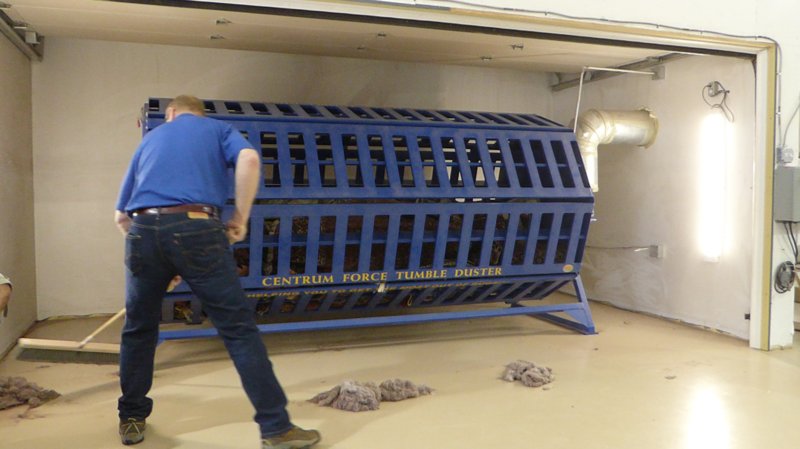

What is swept up off the floor after a 30 minute cycle would not come out of these rugs just with vacuuming:
Ron K
Jan 3, 2009
2,371
Lot's of lint and short staple yarns.
Was that after initial wash?
First/pre-wash tumble would have given off lots more grit/soil in our area at least.
