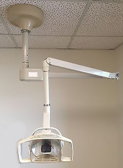

It would have hi-power UV lights like a dentist uses, mounted on a movable track.
When necessary, you could push the light up or pull it down to examine the rug closer.

Fancy! More for show? Hand held likely will continue to be fine for me.

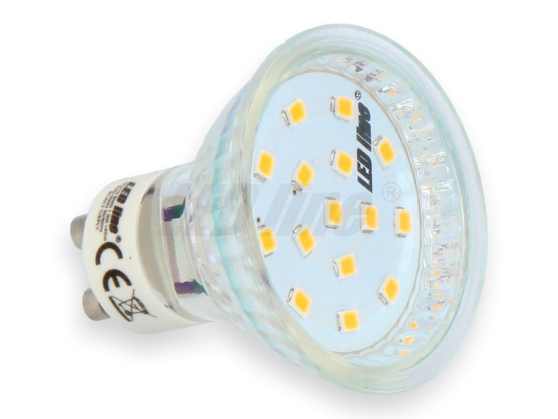

My shop is quite small and I have overhead florescent lighting. To eliminate shadows, off to the side I have a bank of 4 500watt halogen lights. The kind you will see in autobody shops. The problem with these lights is they take a lot of power and they burn out quickly. I was at Home Depot and picked up a Led equivalent to my halogen lights. Takes a lot less power and gives a whiter light. I am going to replace my halogens with all leds.

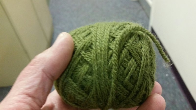

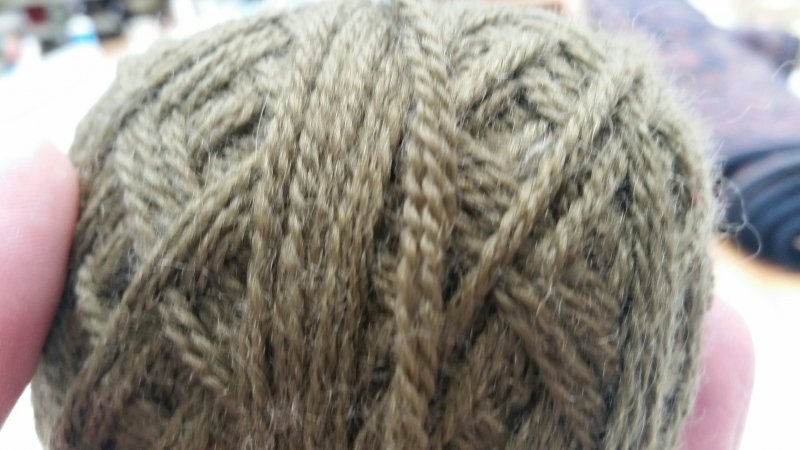

Here's an example of lighting...
Same spool of yarn, same camera (actually my phone) and same settings on the phone. The first picture was taken in our repair room, the 2nd in our office. The funny thing is the camera changed the color too. In the repair area the first picture was brown. In the office it was closer to the 1st picture in color.

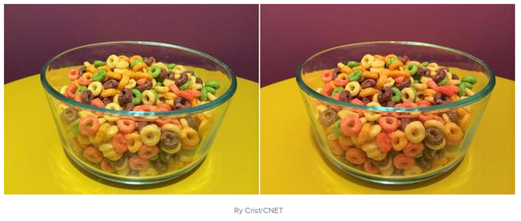

Quality LED's have CRI ratings also . . .
Standard LED's are usually deficient in the Red spectrum.
Here is a photo taken with a Cree LED with a CRI=93 on the right:
