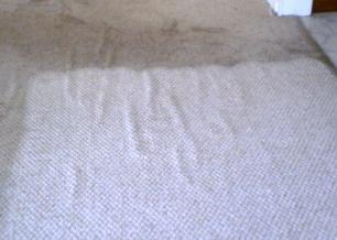

Scott Rogers
1,033
Yep, thats my picture of a cleaning in progress. It was for a rental move out so they could and did get their whole deposit back. Why you want me to teach you how to clean that good. 8)
The customer wasnt interested in a restretch as it wasnt their house. But if they would have paid for it you wouldnt find any wrinkles when I was done.
But the fact that you keep trying to take this thread off subject simply amazes me. I guess its the only attention you can get, since no one reads your threads.
Brian R
Jun 13, 2008
19,945
Little Elm, TX
Brian Robison
Naaah, you were just talkin about doing things right and all that. Didn't figure you would post a pic of a job not done correctly. Doesn't it drive you nutzzzzz?
