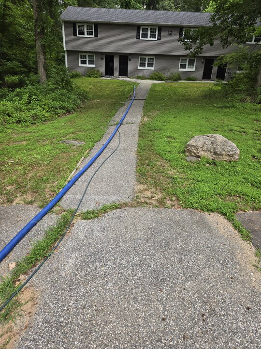

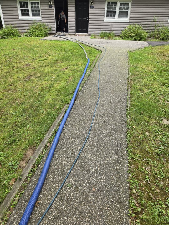

or something to keep the hoses off of grass? I order them neatly when I setup a job but then I walk out to the truck and they are all over the place. Once I get my new heat exchanger installed I am concerned I'll walk outside to discover burnt lines of dead grass across people's yards...

I never used yard sticks but have been known to slide the solution line down a 50 footer of vacuum hose for protection.
Works great here in the Northeast in the winter also.
