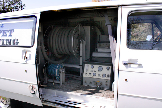

Heres an 89 Butler system .. guy I used to work with back in the mid to late 80's. Look how clean it is !!
