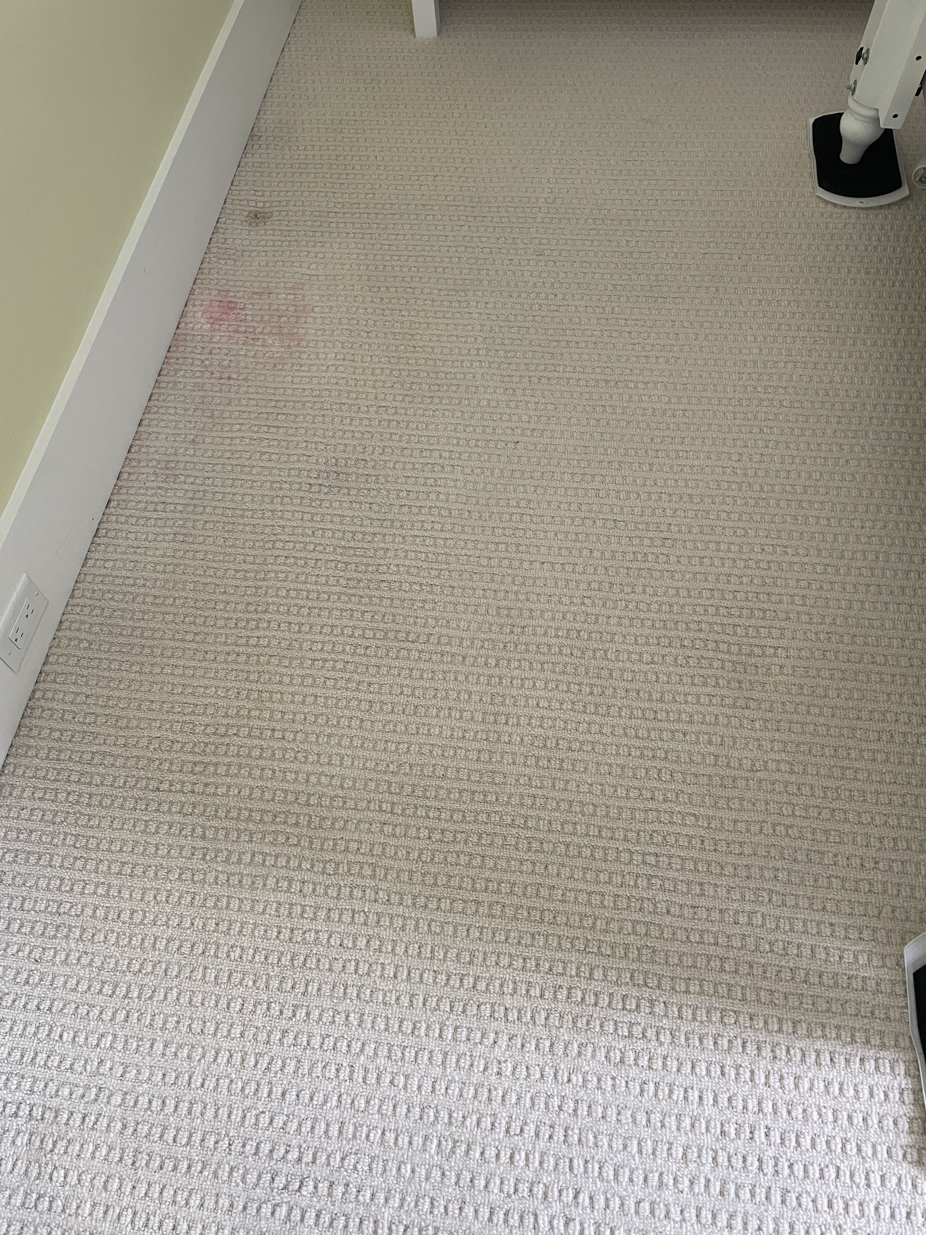

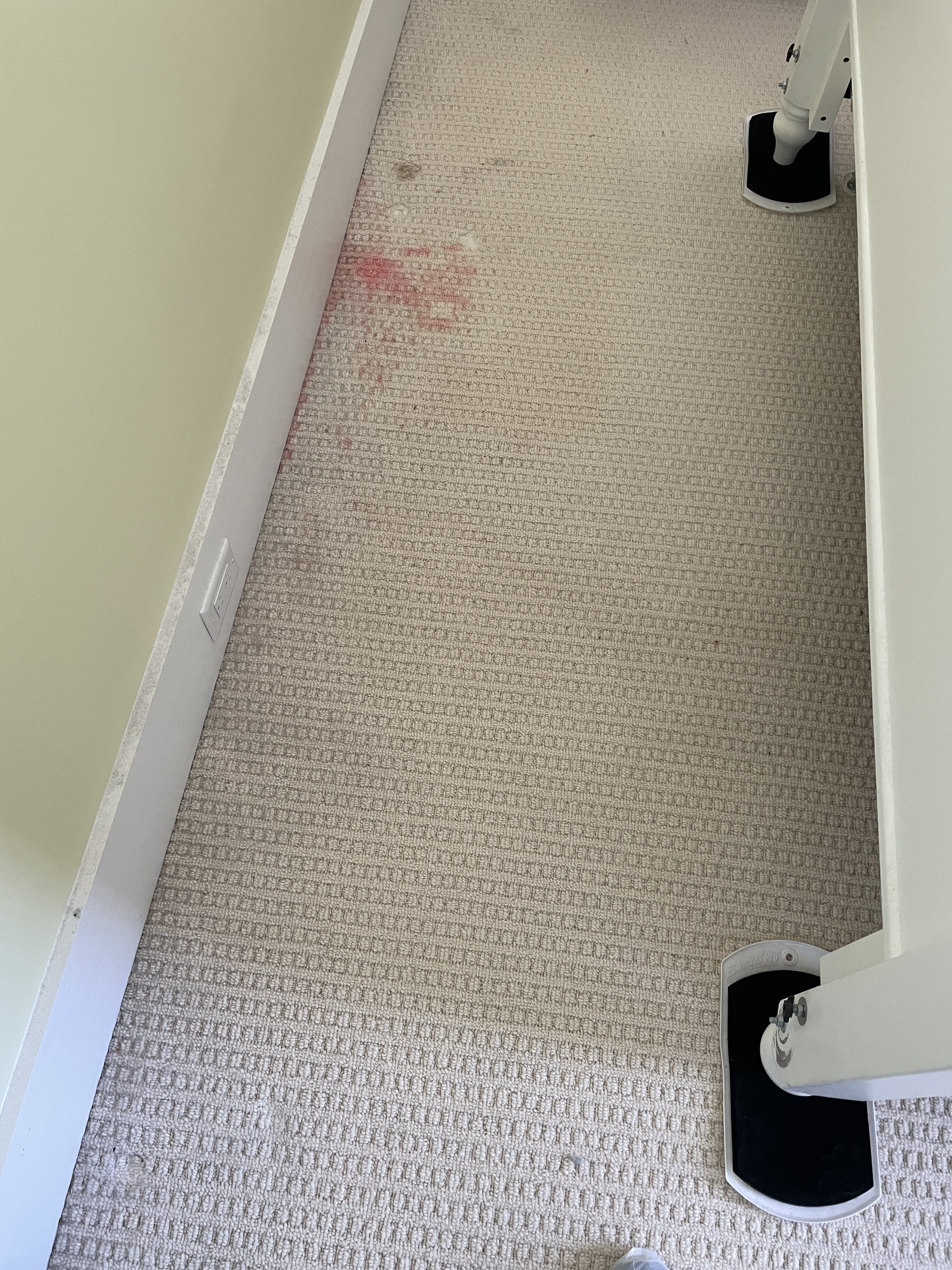

I just did this job. Wool carpet. I used the Stain Magic red relief stuff. It has the 2 part mixer spray bottle which I like. Since this was a deep stain, I just wanted to see how much it would even help. I just went one round of spraying and letting it dwell for an hour then HWE. I didnt use an iron or even try further, just cleaned and recomended a patch. But it definitely helped.
27,889
The 2 part system is designed to spray and walk away. Doesn't need to be rinsed. Will usually work for up to 4 hours or until it evaporates off.
