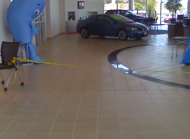

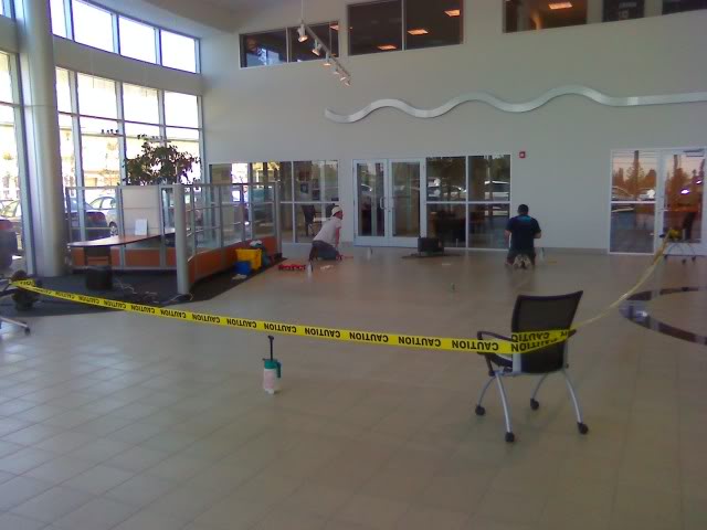

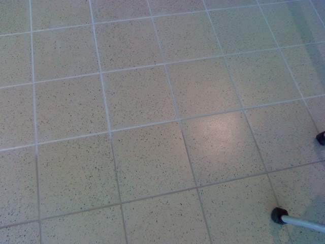

3 of us cleaned a color sealed 632 feet in about 3.5 hours.
We wasted considerable time trying to get use to the Shamwows.
Thick cotton towels are just plain faster in my experience.
Only 5368 feet to go.
Pics were taken before we buffed off the haze.

Day two went smooth.
Two of us covered 415 sf in 2:45 or so
I find that we get the best/speediest results by using a Costco Cotton towel first then follow up with a Shamy to get the dried stuff off. Wiping up every ten 12 by 12 tiles on average
When we're done with a large area we use encap pads and some very diluted Neutral pH cleaner to get the haze off followed by a white pad to get rid of the wheel and foot prints.
Grout Perfect.
perfect name for sure.
116,340
Re: Day one
Day 3 clued me into the fact that I was spending way too much time with towels cleaning up excess color seal
I'm letting the 175 OP pad get it now, followed by a fiber pad.

For final cleanup/buff, I would use a 175 w/white pad, and dilluted windex (3oz/qt water). Once done color sealing area, lightly mist 10x10 then buff with white pad.
BTW, congrats on the work, looks like a nice payday!
116,340
Re: Day one
Is this the same Scrubbs that has seen the Light on tmf?
Dont you find that just a white pad leaves some haze behind?
Have you tried a OP blend then the fiber?
damion68
Dec 6, 2007
182
Re: Day one
LOL, I'm caught....
On the few tiles I have found the white pad not working well, I switch to a bonnet (either green or blue stripe) both seem to work equally well for me.
I have not tried the OP then fiber.
My "normal process" on 12x12 is apply cs 10-15ft, 3 lines deep, wipe with chaois (chammey LOL), then next 3 lines. Same direction until done, then switch and do the remaining same pattern. If extremely flat (glossy) tile use a bonnet, otherwise buff with white pad. Sometimes I may use a dry 24" mop (just for foot prints) as a last step.
