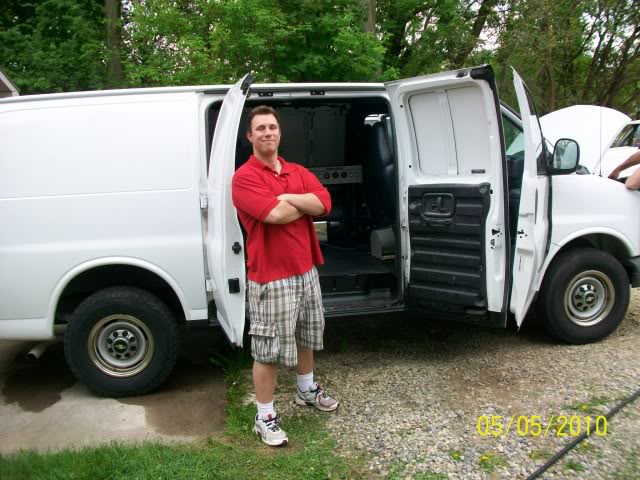

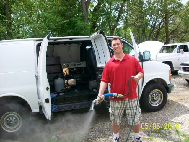

we finished the install yesterday....
next time i charge DOUBLE when the customer heps.......
Crash (against my better judgement) took it out today....
witout a shakedown run....
can't talk to that boy!!!
FIRST SPRAY
a happy customer...

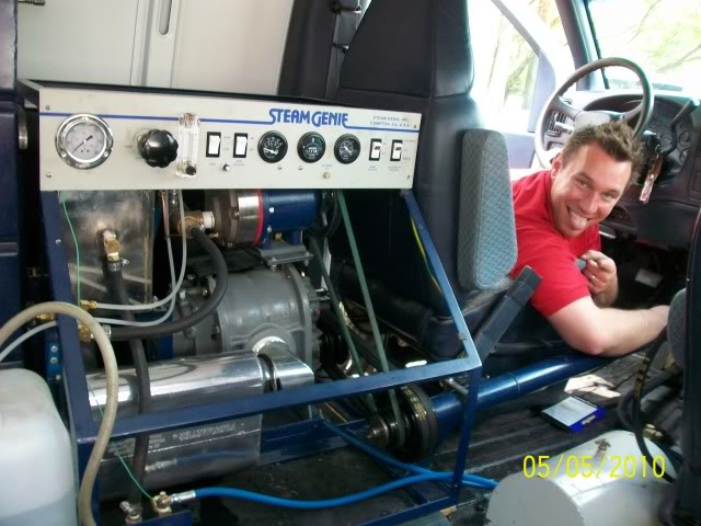

Reverse that then put a WooT Woot behind it because it Cleans unbelievably! I save more gas getting to and from then the extra I burn running the Genie. I did one of our oldest accounts today and the carpet was at least as old as the account (15 yrs plus) I have Cleaned this home previously and the difference between the Church van and The Chevy :shock: of course "Betsy" (the old Church Van) is 20yrs old. Reliability as well! Richard is Right, Great machine to build my "Empire" around!
Happy Happy Customer! For all Bawbs faults he can get the Job Done Right! Thanks Again
Mr. 007
Oct 1, 2008
162
Waterford, MI
Curtis
bob vawter said:
faults????
Bad actuator for the high RPM's. Used part but it will be replaced.
Good News is I can use a Broom stick with a point shaven in one end of the stick so it will stick in the seat to make dollar dollar bills ya'll! Monday that will be taken Care of though.
other than that........ My weld broke on the bolt for the tank easy fix though.

does Crash have a propane heater or blower heat HX'er?
if not...... how can he get 250-260 temps out of liquid transfer HX'ers ????
you sell him bum temp gauge ?
or is his van engine OVERHEATING????
..L.T.A.[/quote:r9187tfl]
exaggerateR....
i tol you 240 degrees hooked up to hot tap water
200 hooked to a cold faucet......
FYI...there ARE different HX's one can use on the Steam Genie....
CRASH has a White Magic HX..
my new SS Steam Genie has a BUTLER HX!!!
EDIT:
i jus looked back at CRASHES post...
and it DID say 240 - 260 degrees
HOLY JUMPIN JEEBUS......that's HOT!
CRASH...can you confirm that temp???
HEY CRASH
see the WM HX....
bob vawter said:
exaggerateR....
ummm.....
Mr. 007 said:
14-16hg and 200 with cold water & 240-260 with access to hot water.
I colored it in rEd fer ya
forgive my ignorance of thermal dynamic physics...but how does a HX'er make hotter water than the engine anti-freeze in the HX'ers?
even with "hot" water going in

It was a long run commercial job, truck was running with a stick before I had my solenoid all set up,(first day) and probably runnin way to many RPMs. anyway truck was running about 220 on the gage & had hot water access. i know that was the shake down run but it has not been that hot sense :lol:
On a good note I finally had a minute to write this post because it's been working non-stop sense the install! Life Is Good!
good to hear you're busy, Crash.
also good to hear the Genie is running well
and lastly...good to hear you won't be needing to replace head gaskets and mill warped heads.
cause if/when you start getting heat above 230 with liquid HX'ers, your van engine is OVER HEATING... :shock:
