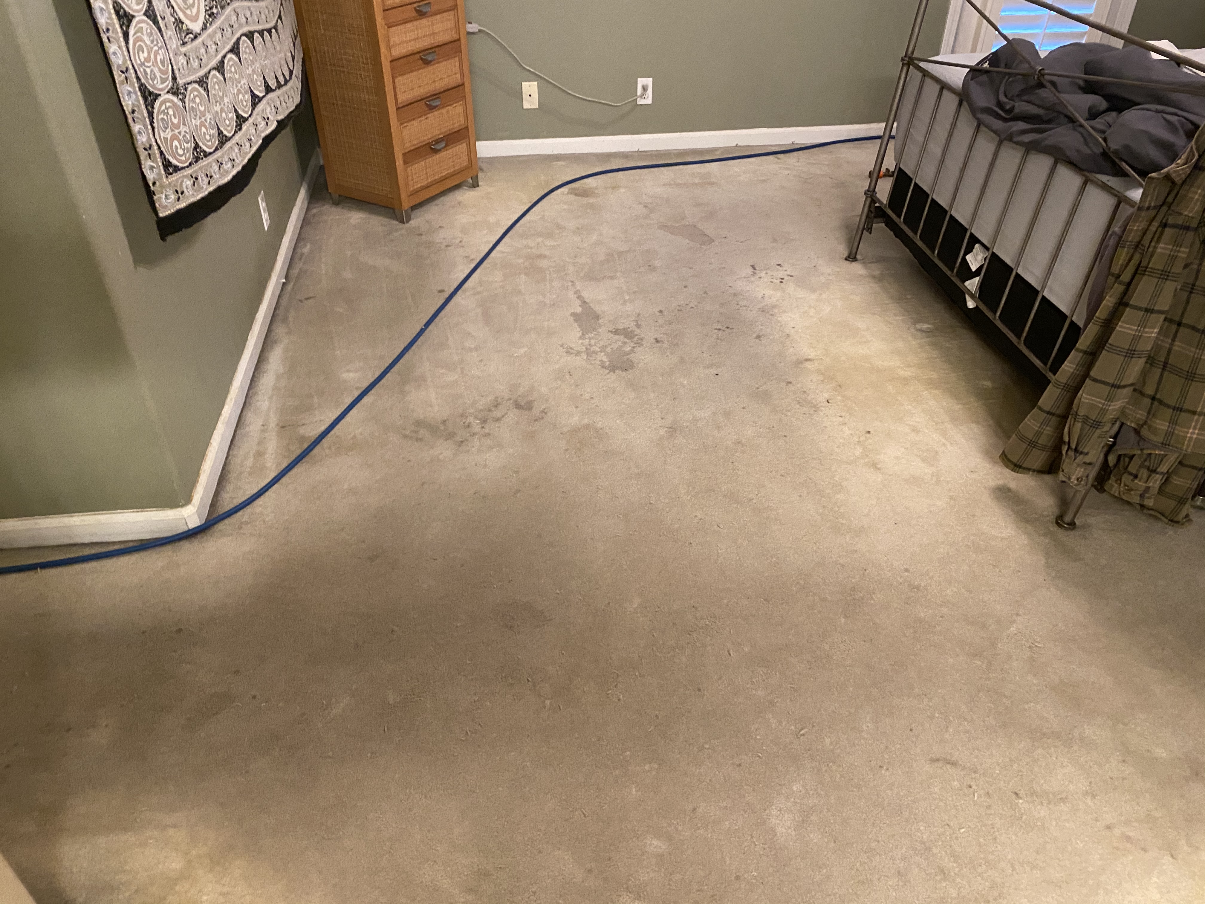

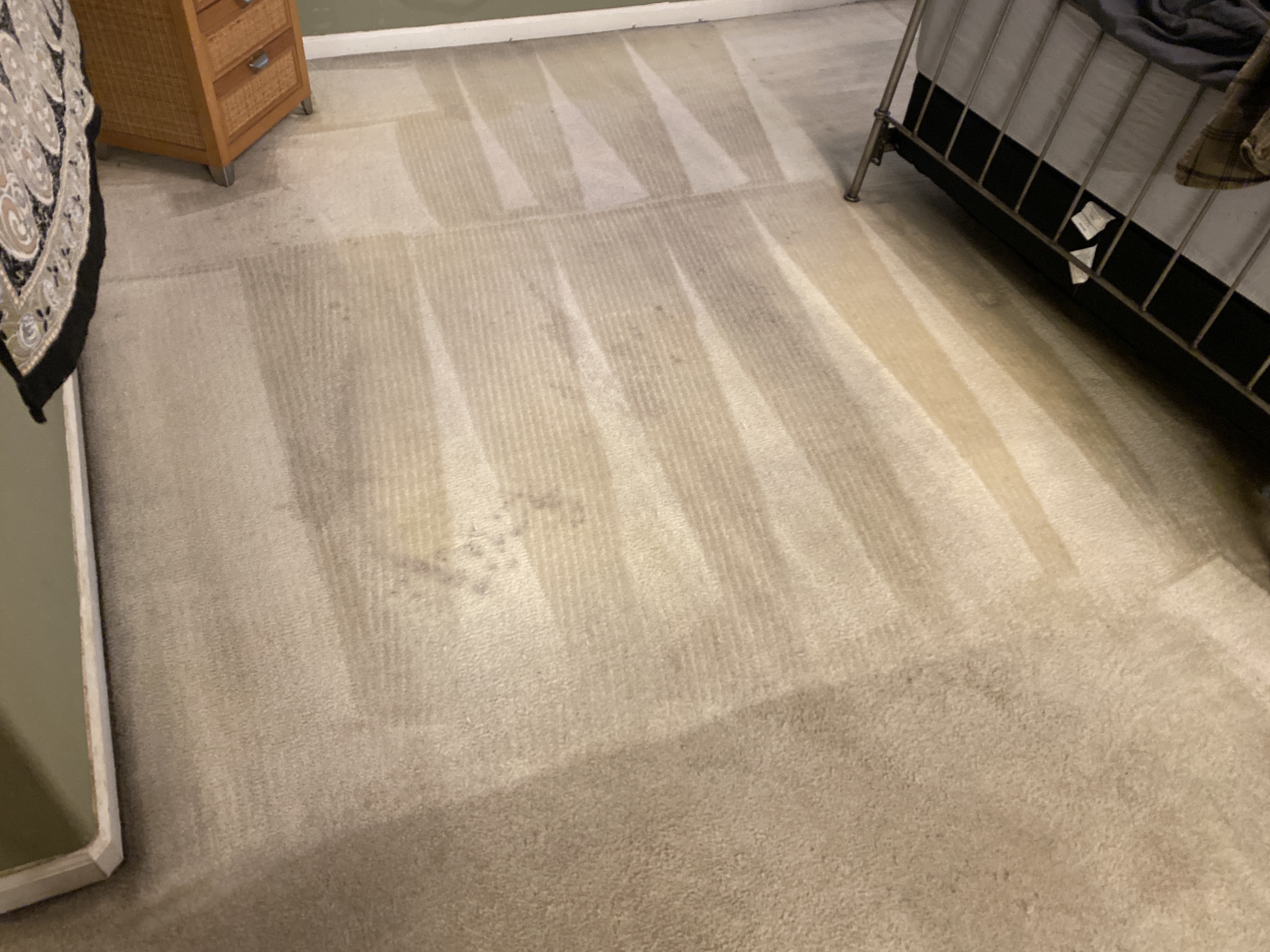

This one kicked my ass today. I ended up mixing in 10 oz of Saiger’s Tsunami and it still didn’t touch this carpet. Carpet is heavily lived on by urine producing dogs and kids that spill gatorade. The entire carpet was covered. I was so flustered cleaning this today I almost walked out. I cleaned it and left. Any stain work would have been futile. At one time this carpet was bright white poly.

This one kicked my ass today. I ended up mixing in 10 oz of Saiger’s Tsunami and it still didn’t touch this carpet. Carpet is heavily lived on by urine producing dogs and kids that spill gatorade. The entire carpet was covered. I was so flustered cleaning this today I almost walked out. I cleaned it and left. Any stain work would have been futile. At one tome this carpet was bright white poly.

Like Solomon said, "there's a time to clean and there's a time to replace.
Reactions: Nomad74
Prochem Porwerburst ...double strength
250+ ATM temps
PC nano Extreme double strength might be good too.
but haven't done any ratholes in years to say authoritatively
are you sure that POS Hydroforce sprayer was drawing?

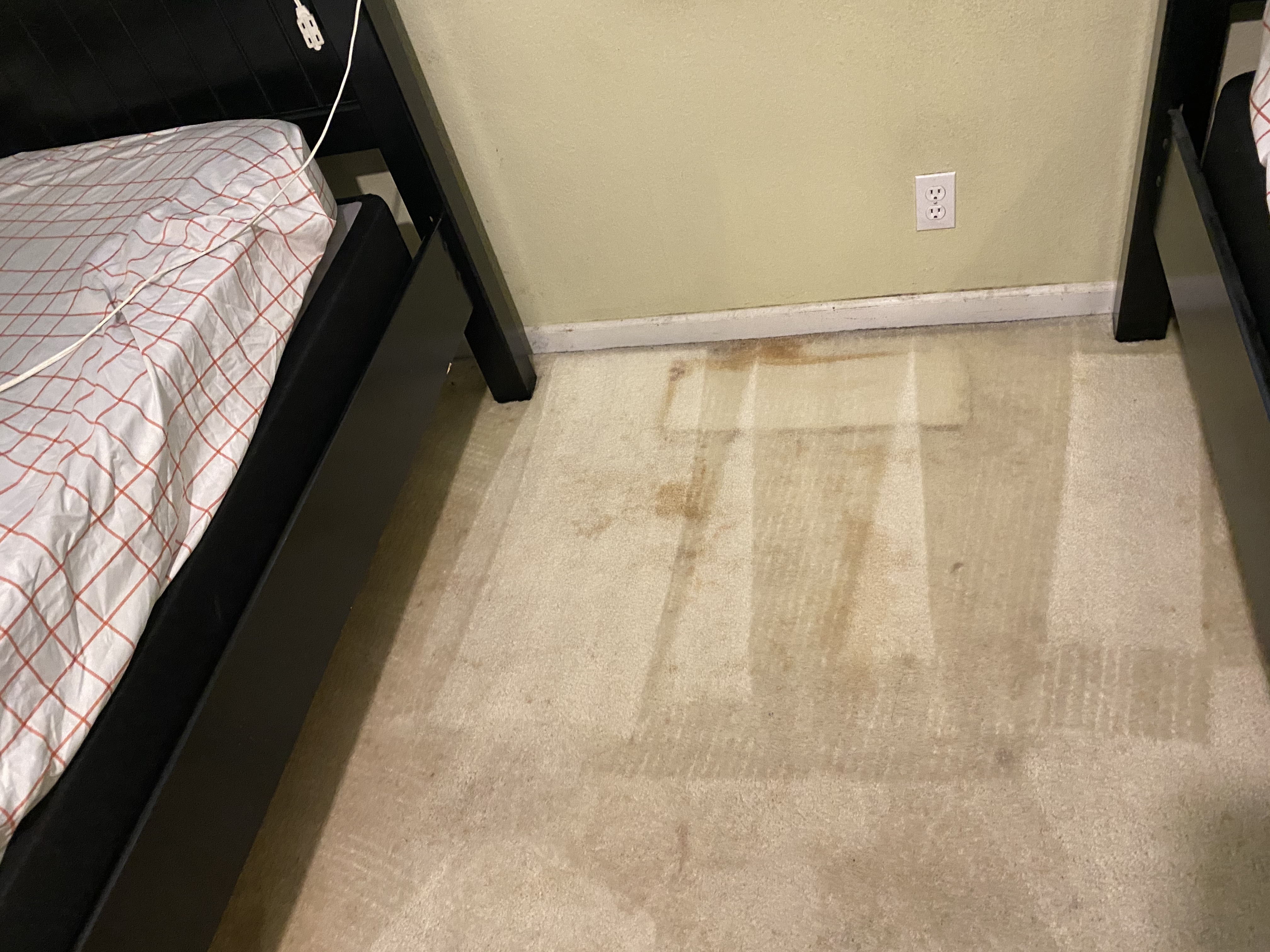

Real Cahrappy!! This is using some Saigers soap free sauce. I’m using up all of my chems that have been laying collecting dust before I buy anything new.
